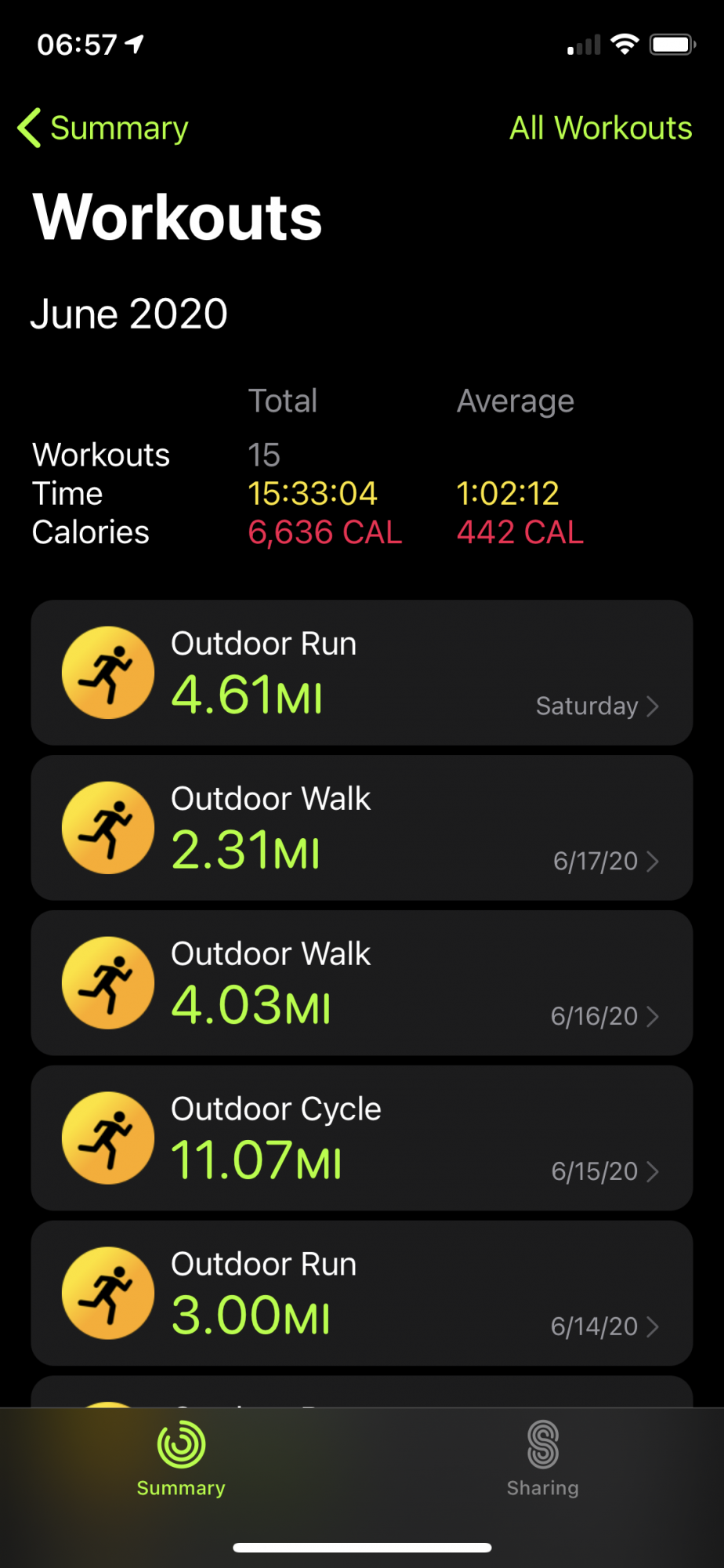

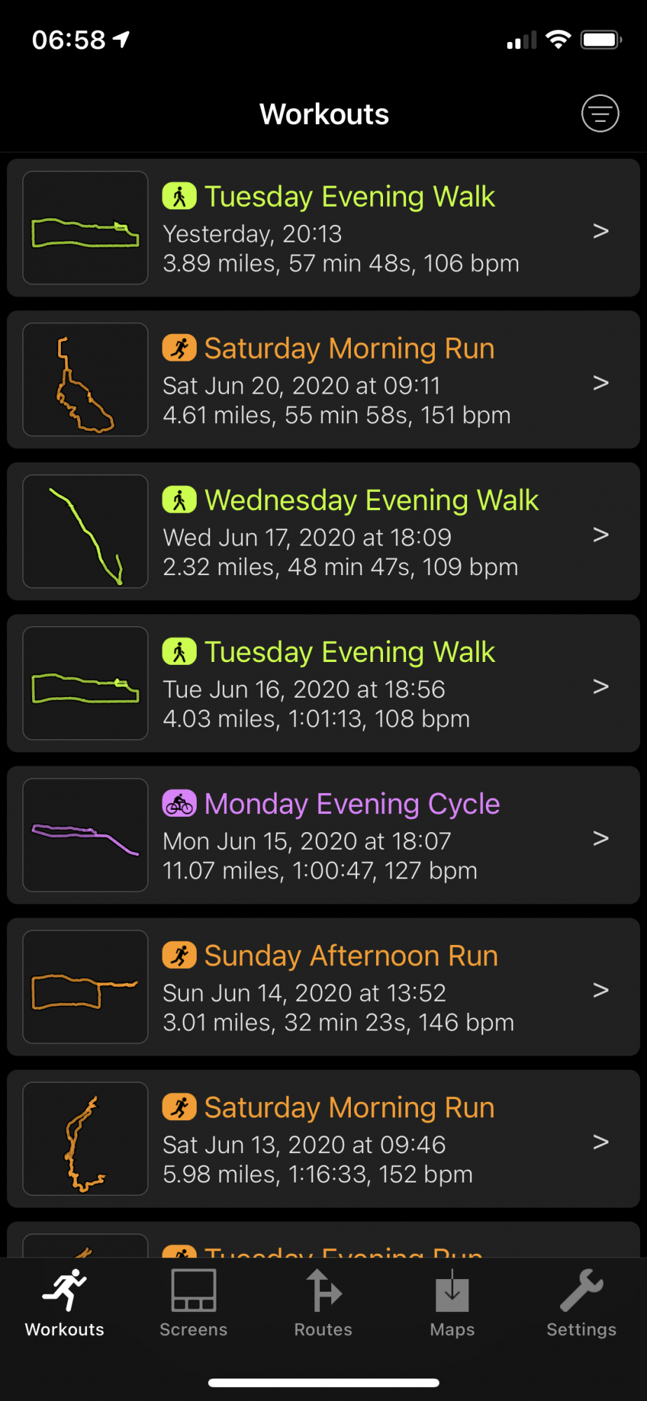

Workoutdoors doesn't work on watch OS7 (or iOS 14)..not sure which is the issue. I did a walk tonight using the app and although the health app records the calories burnt, exercise minutes, distance, and steps...it didn't record that I actually did a workout. looks like when I end the workout, there is no summary screen and therefore no 'done' button to save and export to phone
That is worrying. Please could you send any log files beginning with "WatchMap" or "Jetsam" to info@workoutdoors.net. To do this go to Apple's "Watch" app on the iPhone and tap General and then Diagnostic Logs.
How long was the walk? And did you long touch and see the menu with the End option?
[automerge]1592983071[/automerge]
The walk was just under 4 miles/1 hour. It shows up in Workoutdoors on phone, but not in phone workouts. (see screenshots). I ended the workout the same way I always do (Long press to get to the End/Pause options. Press End, and then 'Done' in the top left) but, this time there was no 'Done' option. You can see in the screen shots the items in WorkOutdoors and the corresponding record in the health app...but last night's walk isn't there.
There are no logs in diagnostics for WatchMap or Jetsam

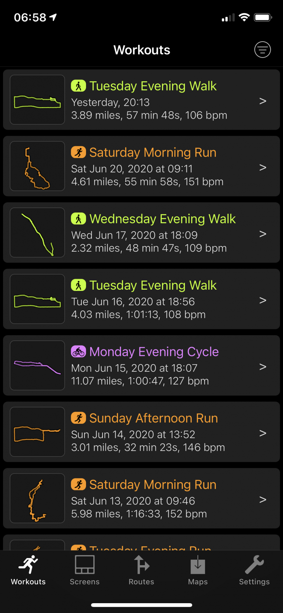

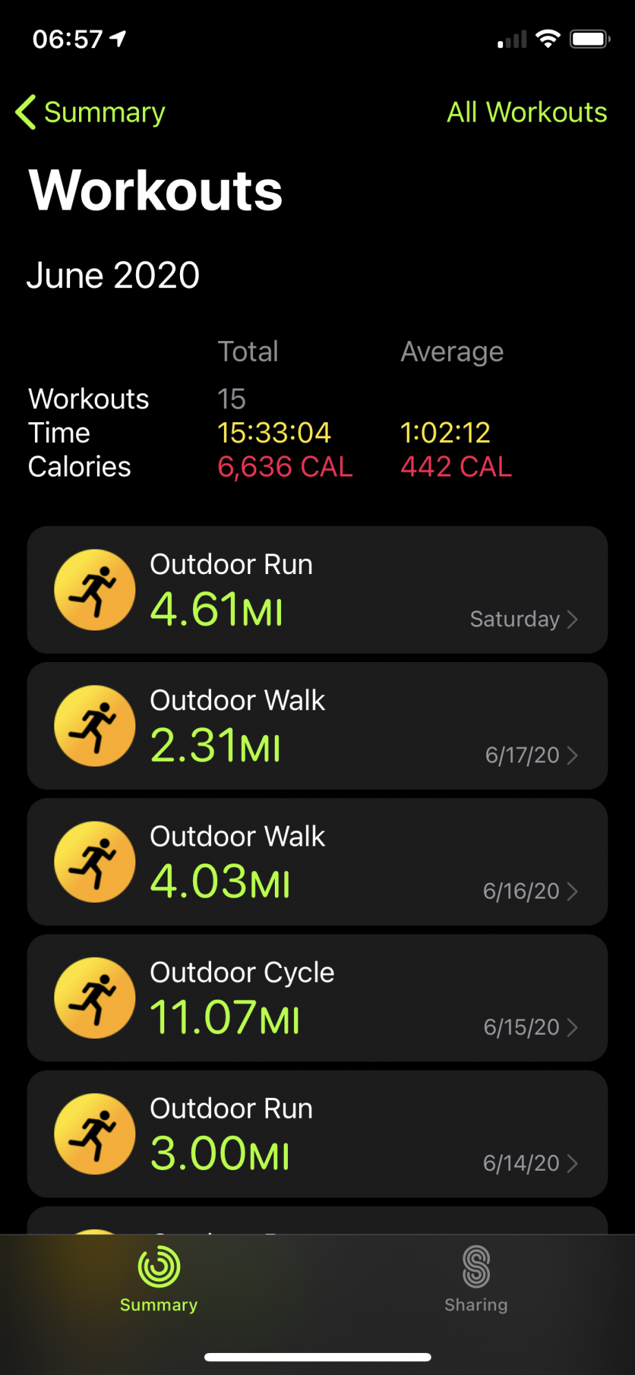

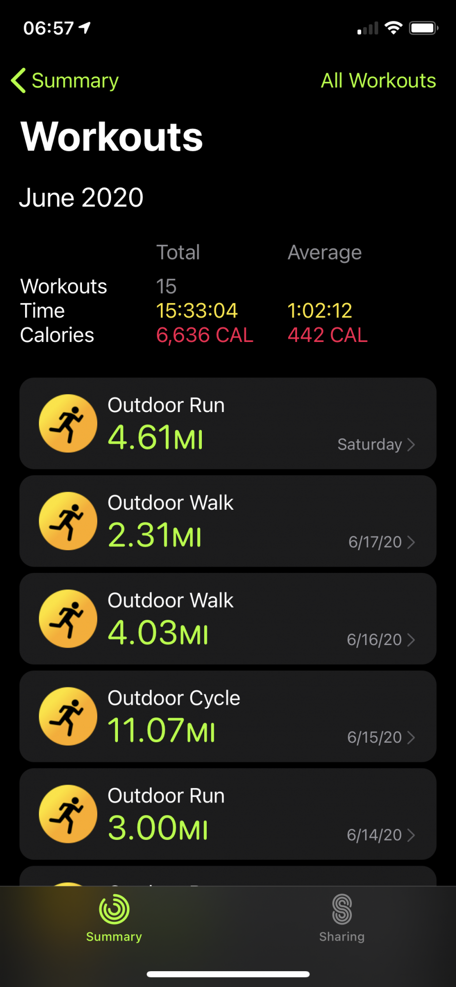

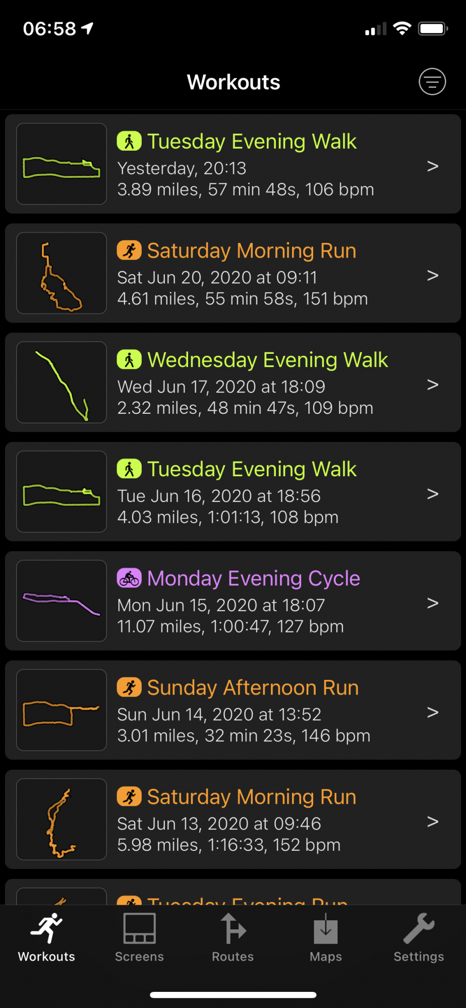

View attachment 927129 View attachment 927130
What was there instead of the Done button? Was it still showing "Saving..."? If so then it could be that the watch needed rebooting because watchOS was confused. This can happen occasionally with watchOS 6 let alone with a first beta of watchOS 7. I suggest rebooting both the watch and the iPhone.
