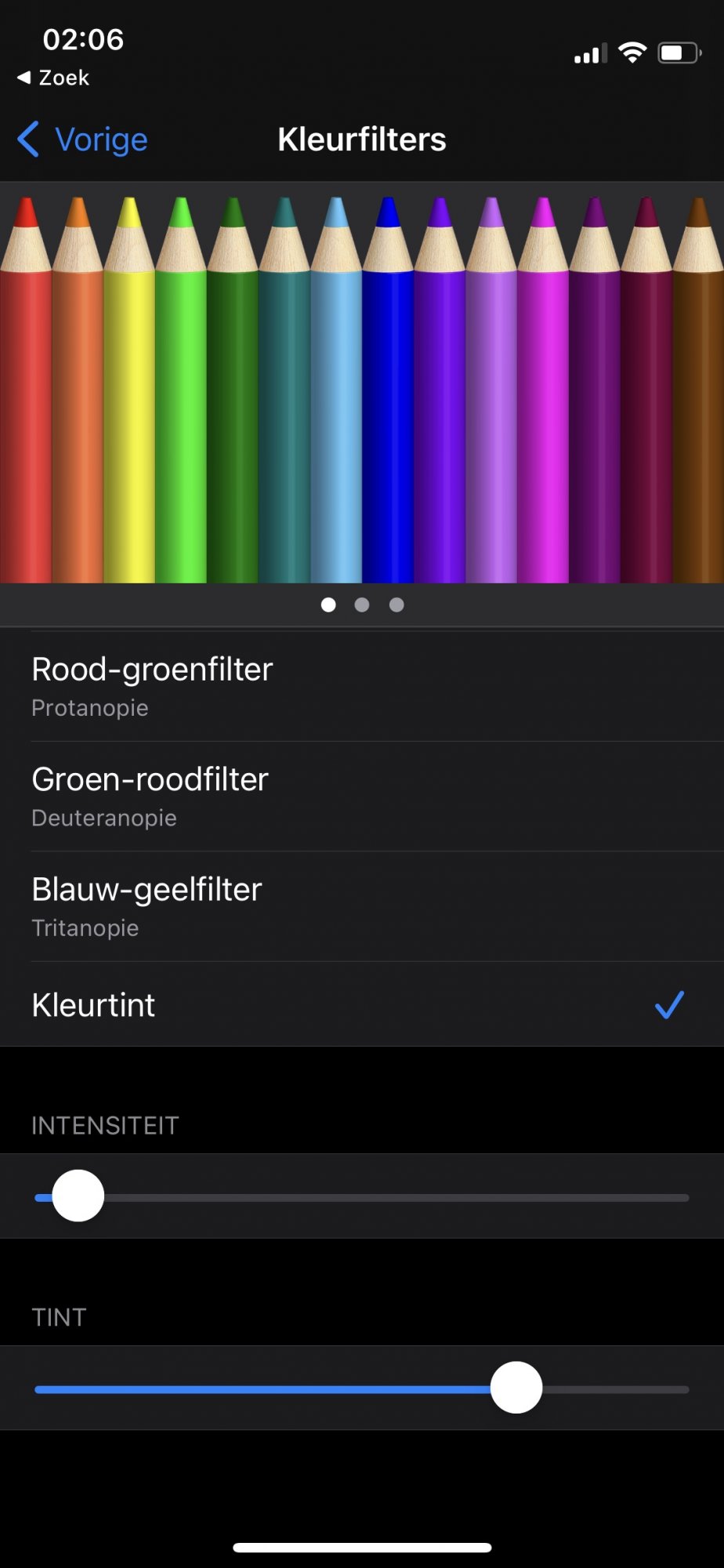

Iphone12 pro max graphite user Currently using the colour filter option and I have got it to match my ipad after many tests and second guessing! Photo colours are exact now! The brightness hit is acceptable. I really think this warrants a screen replacement program. When I turn off the colour filter the screen is totally unacceptable. I’ve had 2 exchanges and both the same yellow tint. 2020 being a **** year and people buying/financing an iPhone is a expensive decision. This is **** crack

You're right on that. I compared my iPhone to my iPad while watching YouTube content and it was an awful experience. Turned on my color filter and it looked so much better, comes pretty close to the whites of my iPad now. I'm satisfied with these values. Whites look better than my previous iPhone 11, but a tiny bit worse than my iPad Air 2019/MacBook Pro 2020.
Edit: Played a bit around with the values and these ones are really good on my panel. They look almost identical to my iPad when simulating a sunset or cool temperature on my Hue bulbs. It's still a shame that I have to do this on a premium device, hopefully Apple fixes it with an update.
