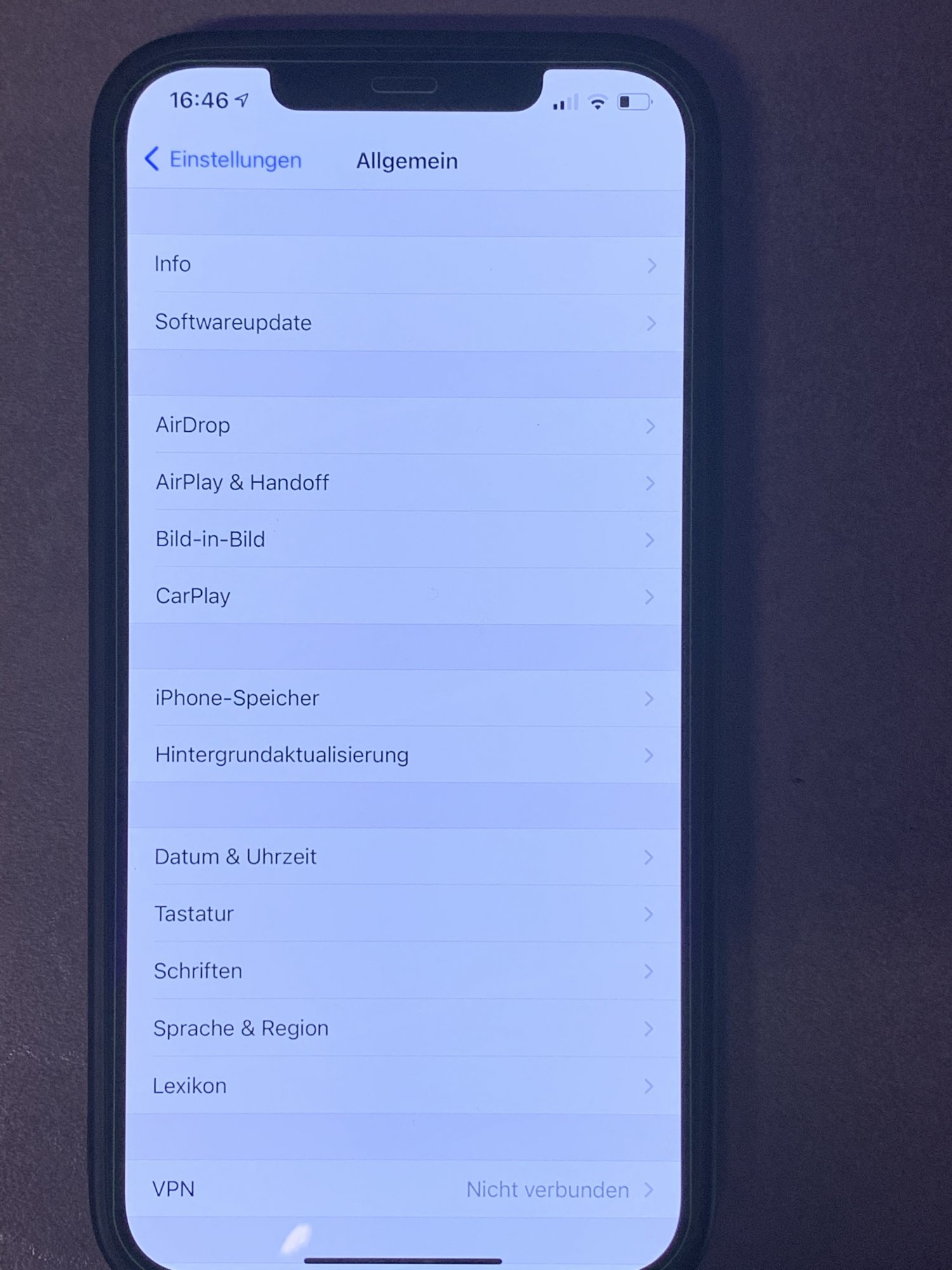

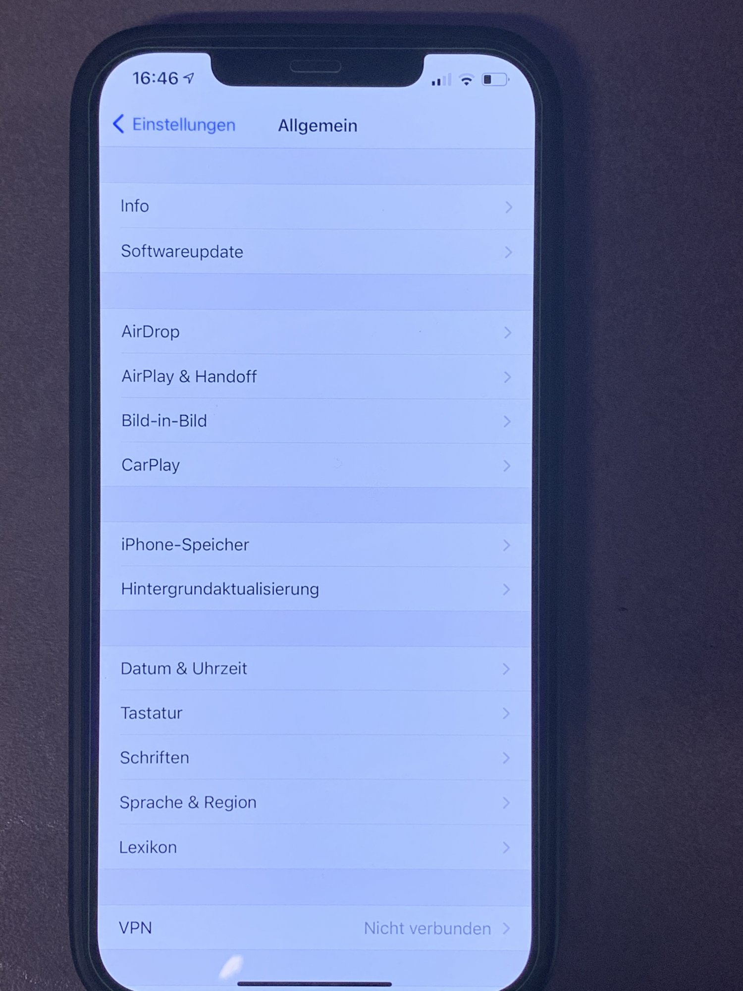

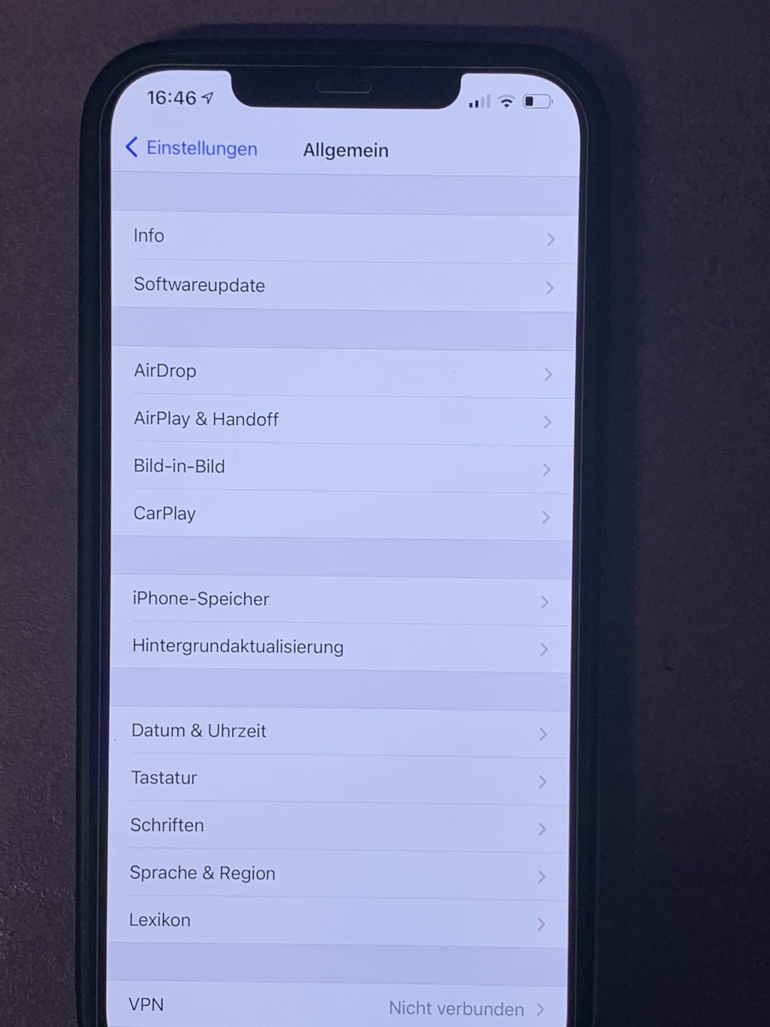

Here is my second ip 12 pm. I will keep it. Photos with and without tt. It’s an iPhone production week 49 2020, sn 49.
Didn’t check raised black explicitly but didn’t notice issues.
Can you post a picture from 90 degree above and not from the side? :)

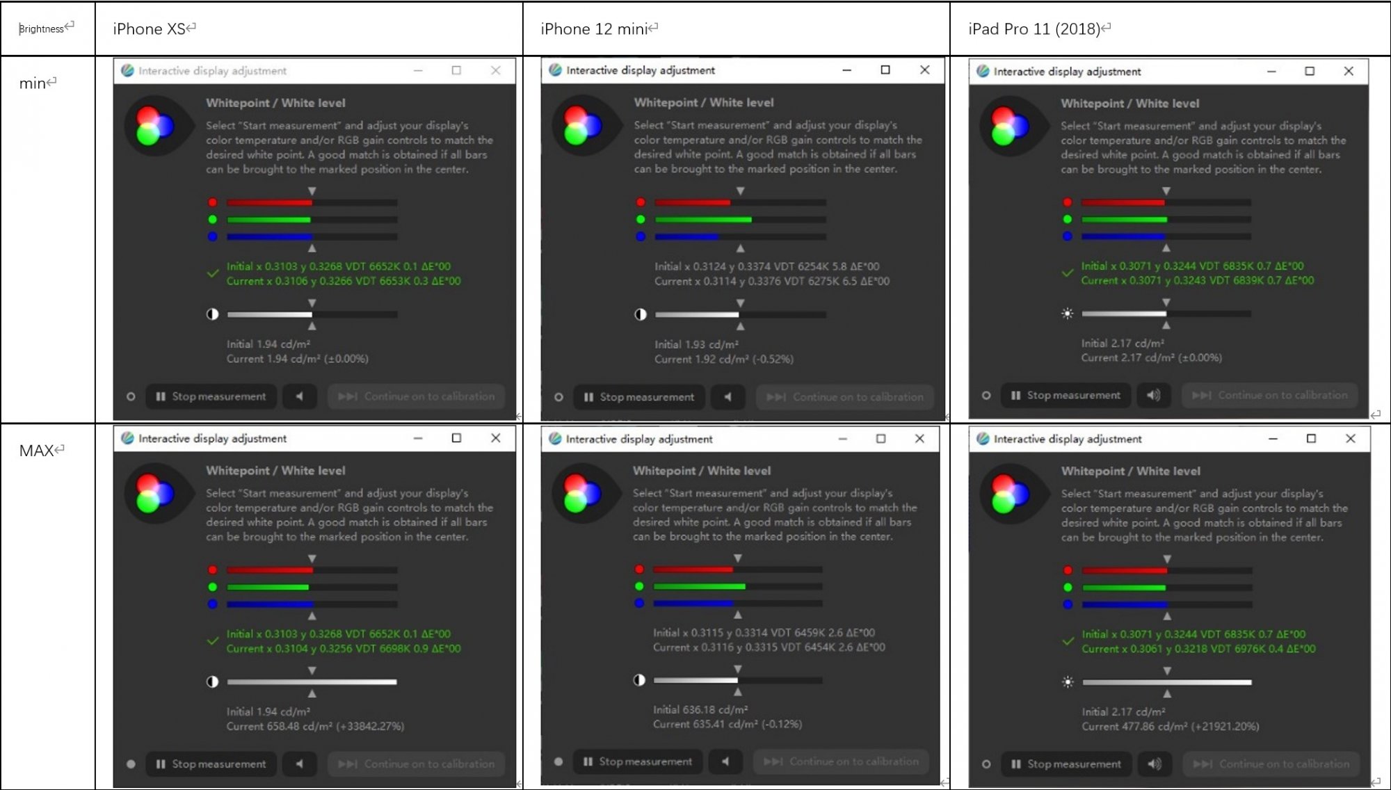

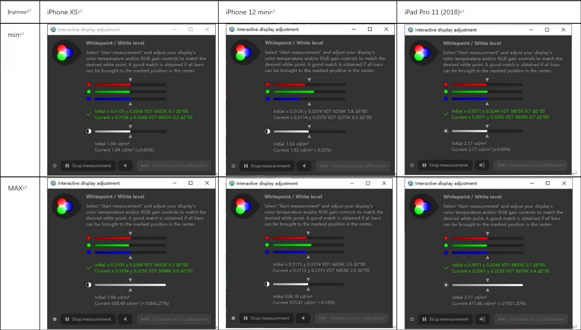

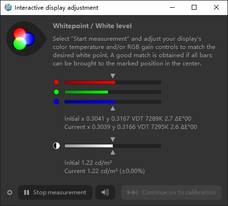

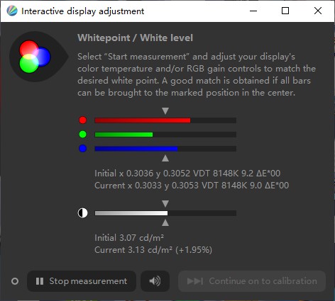

My colorimeter arrived. All with true tone auto brightness night shift and whatever available. Measured at nights with lights turned off.
Not any scientific measurements, but just for comparison between my devices.
Not much needs to be say.. These are 12 minis. See that green bar sticked out at both minimum and maximum brightness?

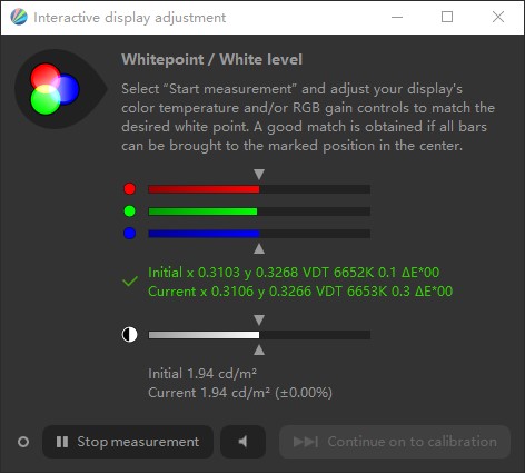

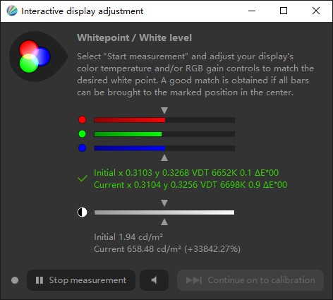

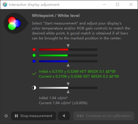

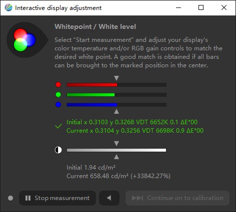

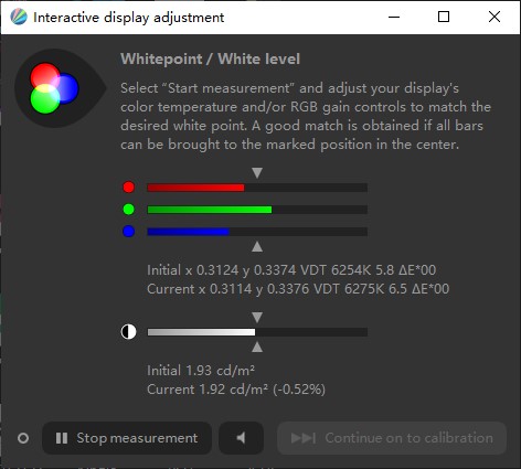

Xs perfectly balanced, as all things should be
It's not the just color temperature it's the balance of the rgb when producing white, and the accuracy , see that ΔE?

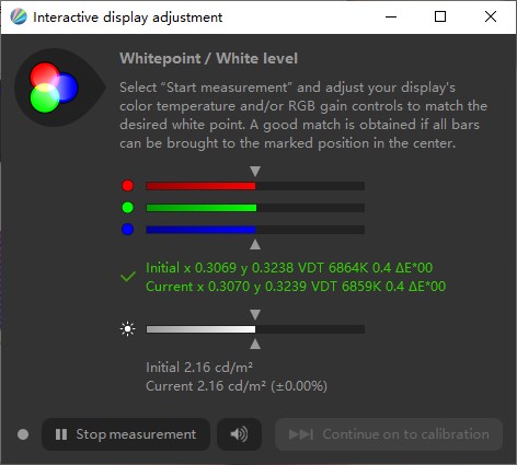

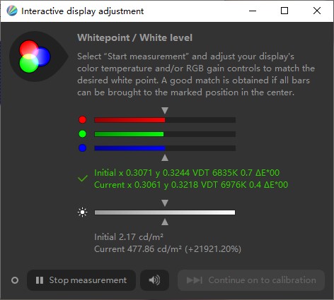

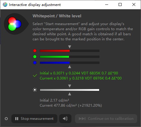

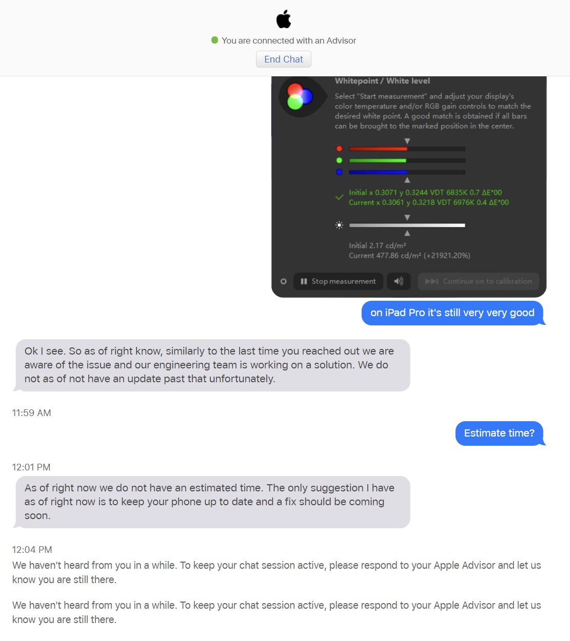

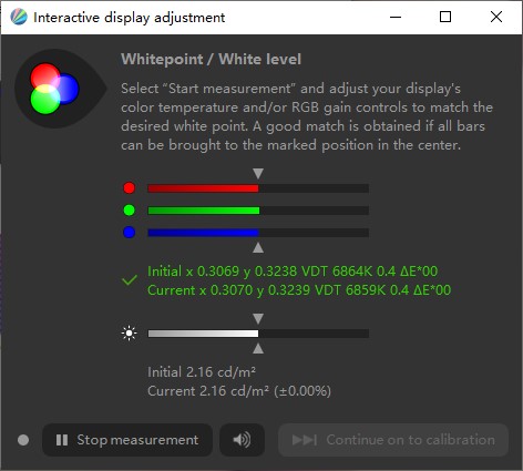

Here's iPad Pro 11inch 2018
It's not people in this forum are crazy, it's the world, the world is crazy. The iPhone 12 mini before this one, all four iPhone 12 models at my local walmart, has the same tinted display as mine. I can't tell a single difference when matched the settings with all walmart iphone 12s. And can't tell a single difference side by side with both iPhone 12 minis too (I had a detailed lengthy long reply which I took pictures of actual pixels using a macro lens but it got removed., so whatever )
I don't know, is it me crazy to think the world is crazy just by accepting green as the new white and trash every apple products besides iPhone 12s. Maybe those people are right. iPhone 12s are perfect phones that have perfect displays with perfect whites. And in this perfect world there's no way white should be perfectly 1:1:1 of R:G:B

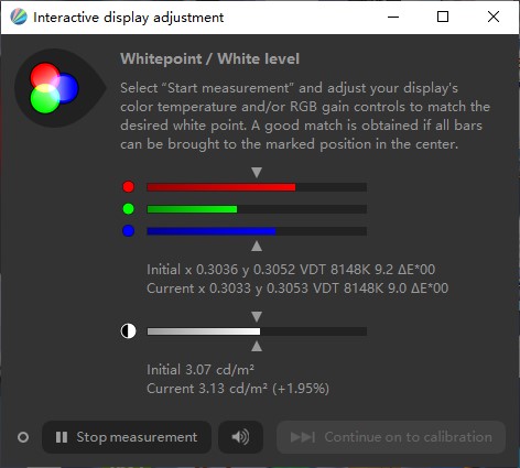

Okay so I started to think my iPhone 12 mini displays are trash...then I took a measurement of my Android Gaming phone (144Hz OLED), and....
Eh it's so trash...(I knew it's not that good just by using it) ...But I have to admit, I'm more sensitive to the abundance of green on iPhone 12 mini.) There's must be some science behind it.. which is probably true.. the abundance of green is more noticable. The abundance of Red / Blue kinda worked together and cancels each other out..

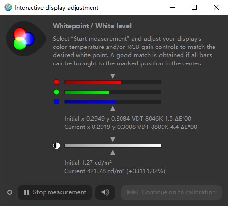

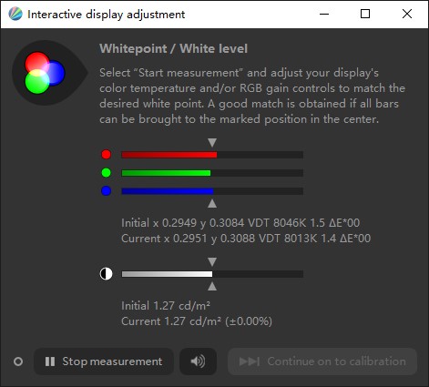

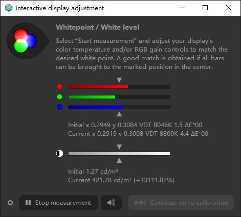

BTW if you wonder how color tint in accessibility settings work. Below is what I can achieve at the best.
I tweaked the color tint settings constantly checking my colorimeter. Things to note
1. Maximum brightness dropped to 421 from 658, that's not some little drop
2. Even I almost correct the white ( just the white, the actual color accuracy of other colors are probably worse by using the color tint) and one brightness(minimum in this case), it won't be the corrected in another brightness. (This is why factory calibrating of phone displays are so damn important..

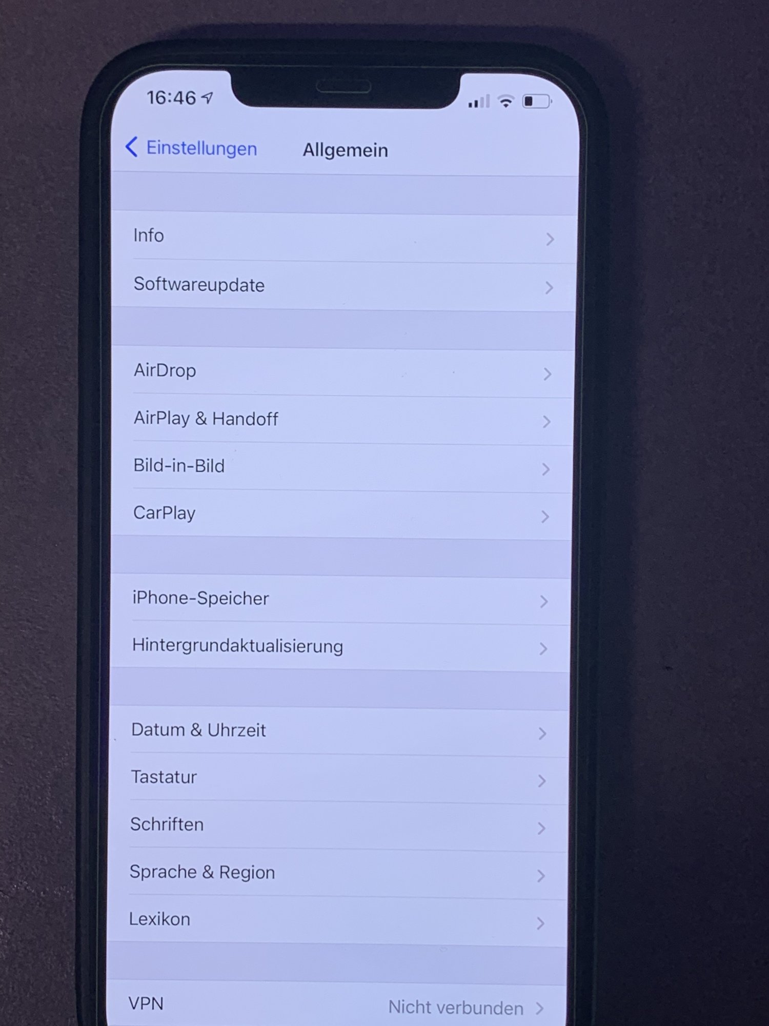

Here is my second ip 12 pm. I will keep it. Photos with and without tt. It’s an iPhone production week 49 2020, sn G0
Would it bother you to test the raised blacks please ? I’d like to know if another new Pro Max’s have it
