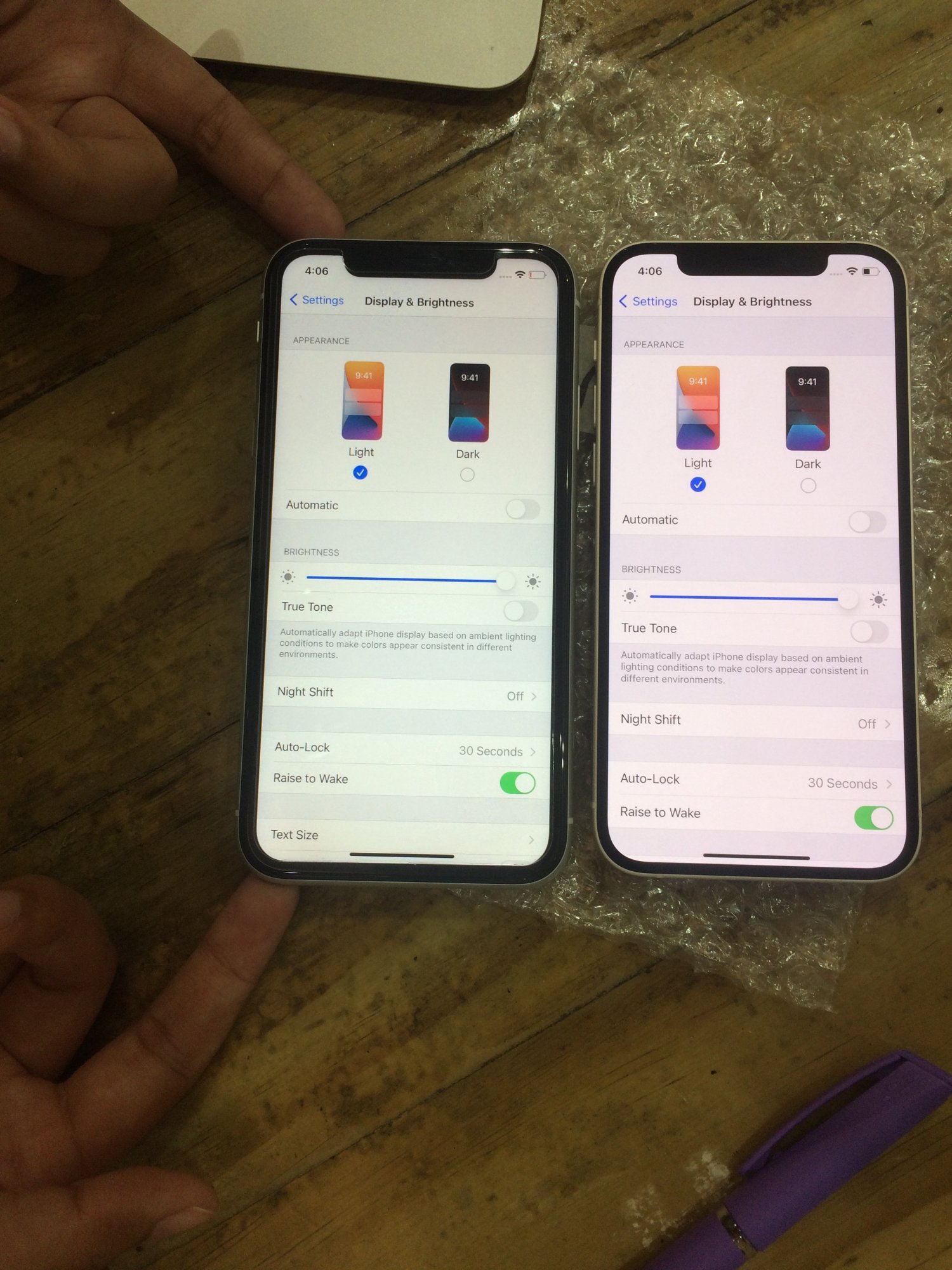

Here is a photo of my new Mini vs 12 Pro Max. No green tint or piss yellow screens. Perfect enough to my eyes and both look nearly identical.
But pretty noticeable uniformity issue with Max. Bottom of the screen noticeable is darker and possibly different tint (hard to say that from this photo). This is exactly the issue with 6.1" Pro's I've been dealing with and already purchased few without much luck.
But pretty noticeable uniformity issue with Max. Bottom of the screen noticeable is darker and possible different tint (hard to say that from this photo). This is exactly the issue with 6.1" Pro's I've been dealing with and already purchased few without much luck.
Max is uniform in real life, it’s just the angle of photo. I’ve returned several due to defects.

OK. Because it looks in the photo exactly like the issue what I have been dealing here. Usually very easy to see using right type of tests and especially when turning the phone sideways/landscape position.

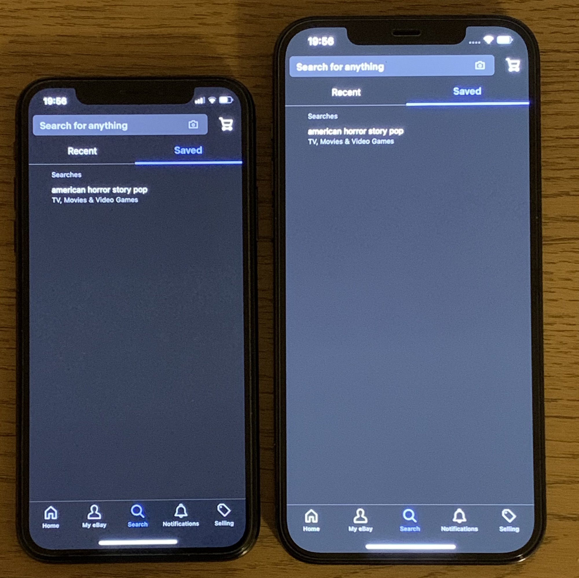

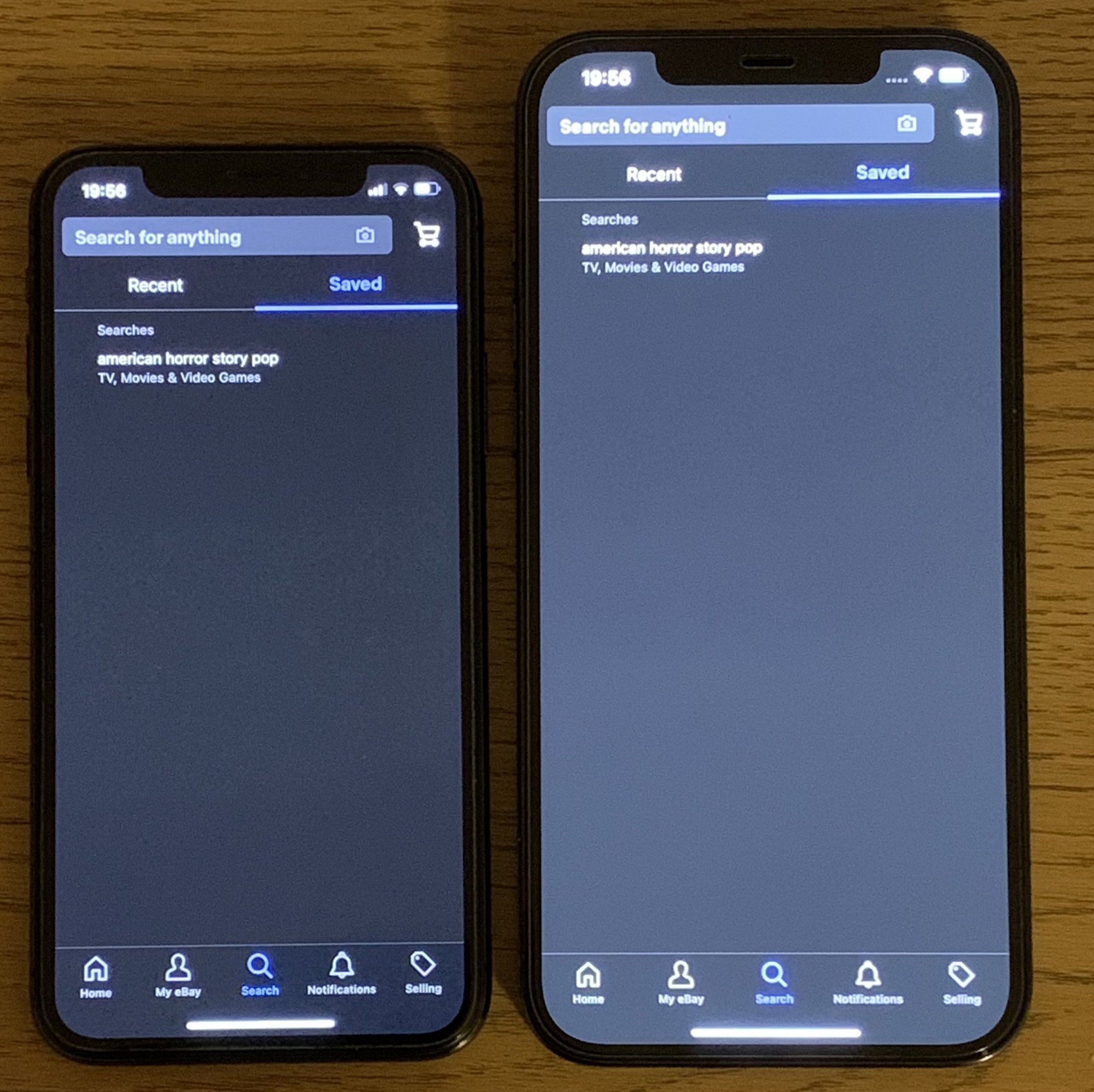

Even on dark mode it looks very different, Much less dark more grey/green.
This photo was taken at 75% brightness.
12 Pro Max & X
Reactions: LFC2020
This is the one thing that bugs me, dark mode greys look horrible, hoping once apple fix the green tint issue, grey colours will go back to how they use to look, not holding my breath though.

Her phone on right. XR on left
Have you actually measured it being D60 with suitable calibration gear? Photos are pretty much pointless if the white balance and display tech is different between the two and camera will always "see" it differently then.
