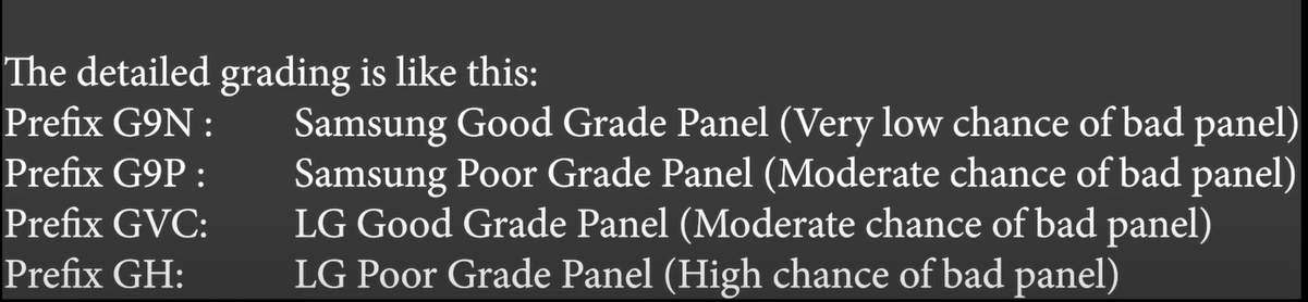

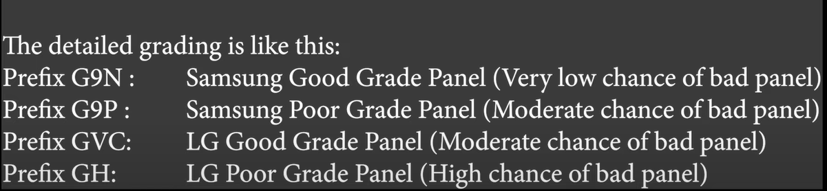

You need to download the Windows application 3Utools (http://www.3u.com), connect your iPhone and then select an option which, if I recall, was called something like "Verification Report" - this is where you will get the extra info, including screen serial number, for your phone.

I did the test, I got a G9P ("Bad Samsung") Panel. Production date 2020/10/04.
My screen is generally good, except for yellow/green tint compared to my iPhone X. Serial is F18DH.

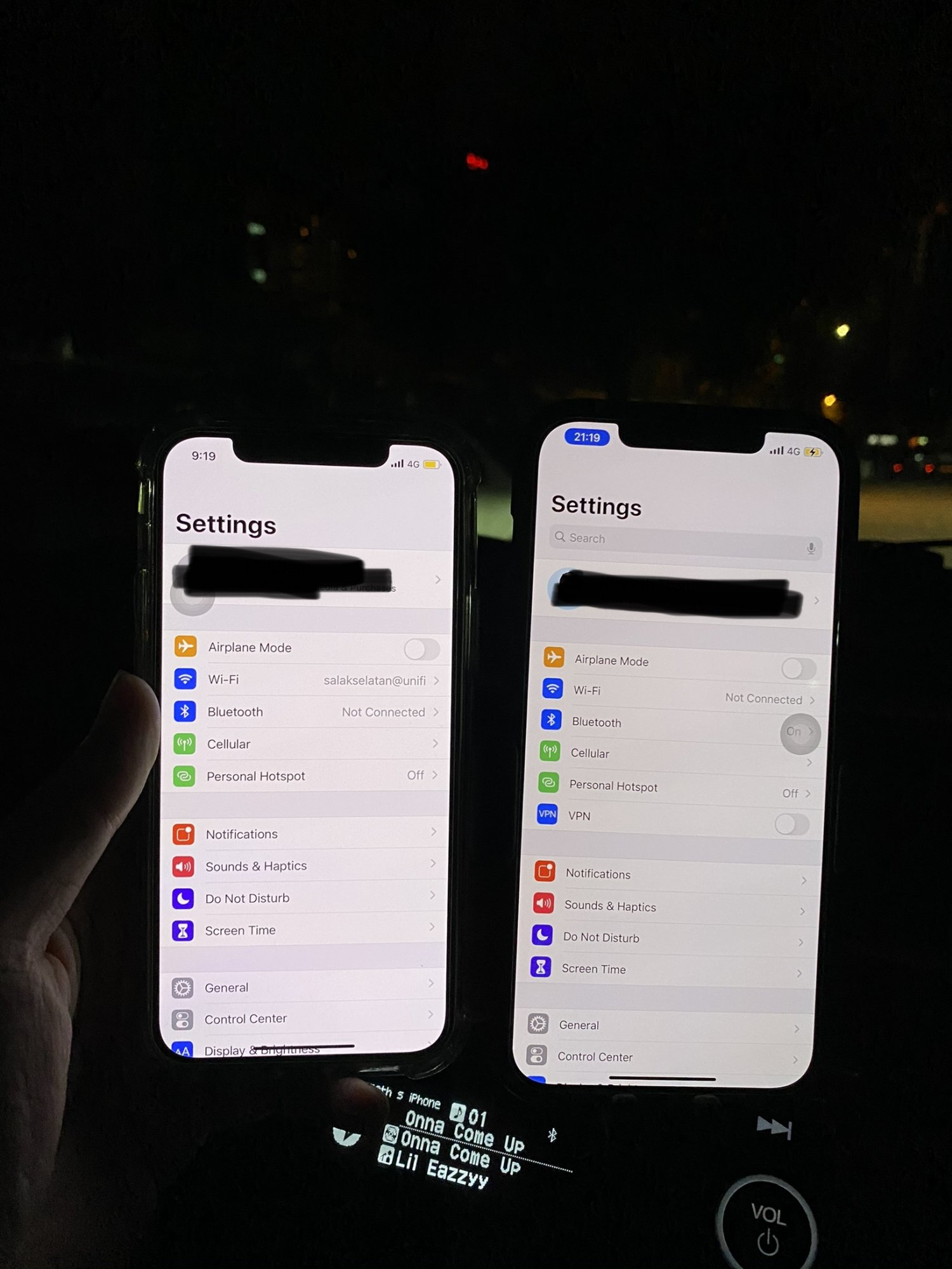

My 12PM vs girlfriend’s regular 12. Both at 100% brightness and my 12pm screen is dimmer than 12 not as what apple claimed 800nits vs 625nit. And also both of the device is yellow but the 12PM is SIGNIFICANTLY yellow. This is really annoying
edit: BOTH device nightshift, true tone, auto brightness and color filter off.

I ran the tool, but how did you figure out it’s a bad Samsung?

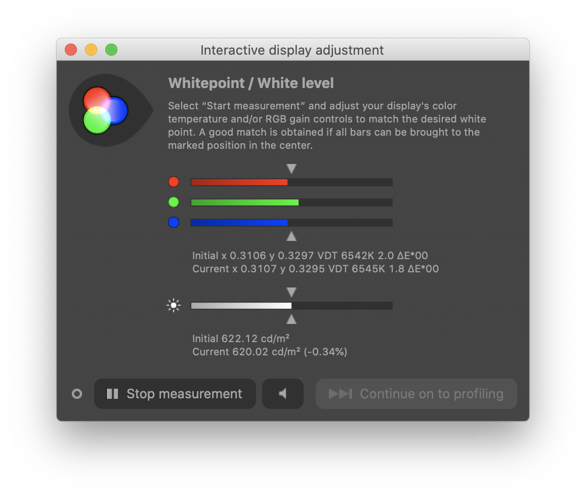

So below is some mucking around I did.
True Tone off, night-shift off, auto brightness off.
Measurements using i1 Display spectrometer configured for OLED Samsung in DisplayCAL on the most recent unit I have. I also checked the last one, which was similar but no so comprehensively as this. I can only do a measure of a white screen as I don't have sophisticated software to talk to the phone.
note: Delta E 1 or less is considered an accurate display (not possible to tell difference side by side with human eye)
iPhone 12
100% Brightness (625cd/m) Delta E 1.8 - 6550K
50% Brightness (150cd/m) Delta E 2.6 - 6550K
25% Brightness (55cd/m) Delta E 2.8 - 6550K
For reference > 2018 MacBook Pro ~No Calibration.
100% Brightness (500cd/m) Delta E 0.1 - 7000K
Thanks for the measurements. More confirmation for me that the color temperature is not the problem. 6500K is good. The problem is the balance of the colors... there’s way too much green. The sad part is, I think these panels could have been calibrated with perfect RGB balance, but I think the calibration machines at the factory are programmed to prioritize brightness and / or power consumption over RGB balance. Green OLED subpixels are by far the most efficient, and can get brighter than blue or red, so a screen that is tinted slightly green will get brighter and use less power than one that isn’t. It could be that the OLED manufacturers are having a hard time hitting the brightness spec requirements given by Apple without tinting the screens slightly green, or it could be that Apple has set both brightness and maximum power draw specs (hello smaller batteries) that are hard to achieve together without a green tint, which could explain why green tint seems to be a much bigger problem this year. Personally, I would prefer a display that wasn’t quite as bright or efficient, but had perfect RGB balance.

No, it only says iPhone 12. Mine is 12 Pro and if the above list of prefix is to be trusted, it has a Samsung panel. That also makes more sense, since it is also stated that LG will produce 20 million and Samsung 60 million (I don't expect Mini and Pro Max combined to sell 3x as much as 12 and 12 Pro combined).

What are the first 5 characters of your serial?
