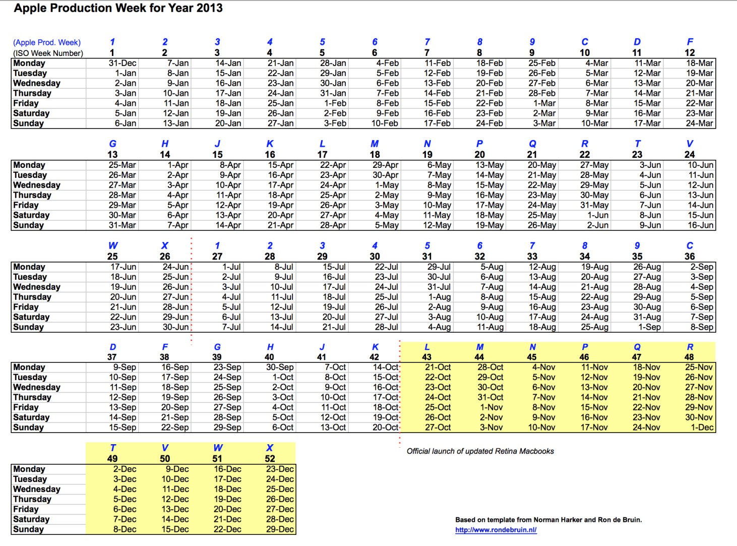

I'm on my 2nd BTO replacement. I was curious about the production dates & wanted to confirm it's "factory-fresh" and was part of the latest batch. I talked to a couple of MR members offline that exchanged their units at an Apple store vs. waiting for one shipped from Apple.
I wanted to share my research to help others -- especially those that are buying a new unit or exchanging a unit at a physical Apple store:
I created a spreadsheet to decode the serial number (below is a screenshot);
  • specifically, I have mapped the "production week number" (e.g. week 46, November) to the alphanumeric value in the 5th character in the serial number that Apple uses for its production week (e.g. "P").
  • With the spreadsheet, you can see that "P" maps to week of 11/11 to 11/17/13. PM if you would like the spreadsheet.
Highlights:
  • When ordering a new unit or requesting a replacement unit (especially for BTO's), these should be "factory-fresh" and the latest batch. :)
  • Find your production week: enter your serial number here. Note: this gives you non-specific date, e.g. "week 46 (November)." Use the spreadsheet below to get the specific date range. Which is why I decided to create this spreadsheet.
  • If you're at a physical store, examine the serial number before opening and unsealing the box: look at the 5th character of the serial number (so you don't "waste" a new unit which Apple can sell to someone else).
There was a Macforums articlehttps://www.macrumors.com/2010/04/16/apple-tweaks-serial-number-format-with-new-macbook-pro/ about deciphering / decoding the serial number (format of serial number is: PPPYWSSSCCCC, where "Y" is the Year and "W" is the Production Week). Here's a summary:
  • "W" is alphanumeric, with 27 possible values beginning with 1-9 and moving on to letters
  • The following are omitted: number 0, vowels A, E, I, O, and U, as well as B, S, and Z.
  • Because the 27 possible characters cannot account for all of the weeks in the year, the "W" component must be paired with the "Y" component to determine whether the machine was manufactured in the first or second half of the year, with the "W" codes recycling every six months.
  • What to take away: the newer batches should have letter "N," "P" or later. Someone recently went to their local Apple store to exchange their unit -and it seems it has slight issues; the production date was September!
I created a spreadsheet to decode the serial number (below is a screenshot). PM if you would like the spreadsheet.
Whoa! Thanks for sharing--that's an amazing resource. I'm curious to see if some sort of pattern emerges according to date/week of manufacture...
For what it's worth, my first one with a sub-par display was manufactured the week of October 28th--which makes sense as my BTO order was placed on November 2nd. Here's hoping I get a good one before we reach "Week X"...
