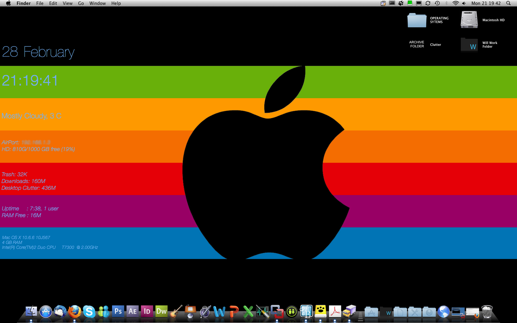

I'm still doing a lot of tweaking, but here's my DT for now.
Would you mind sharing your code for the weather and time? What fonts did you use? Also how are you creating those launchers? Also how did you get the widget for itunes? Thanks for any help. Your setup is extremely nice.

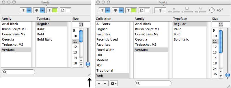

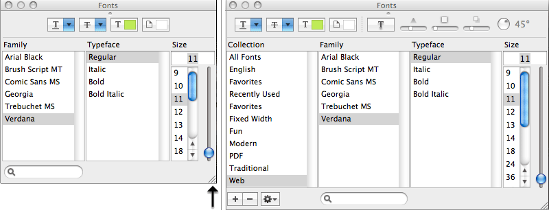

Yeah, I definitely don't have that button:
You definitely do... (it's hiding from you).
The font window by default is sized too small for the other options to fit, so they are completely hidden. Drag the lower right corner of the window to make it larger — the drop shadow option should then be visible. I ran into the same issue when I finally realized why those options weren't appearing.

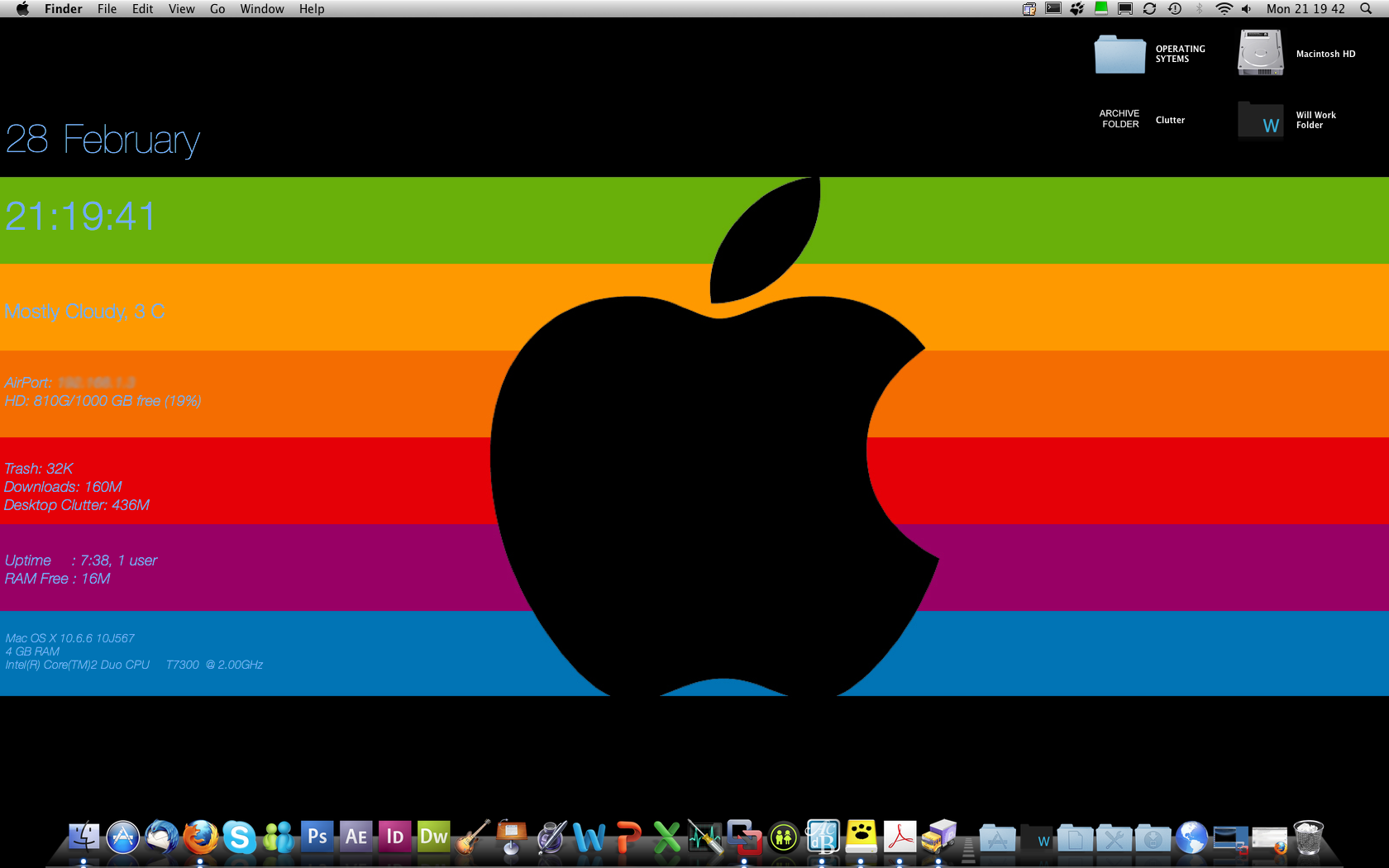

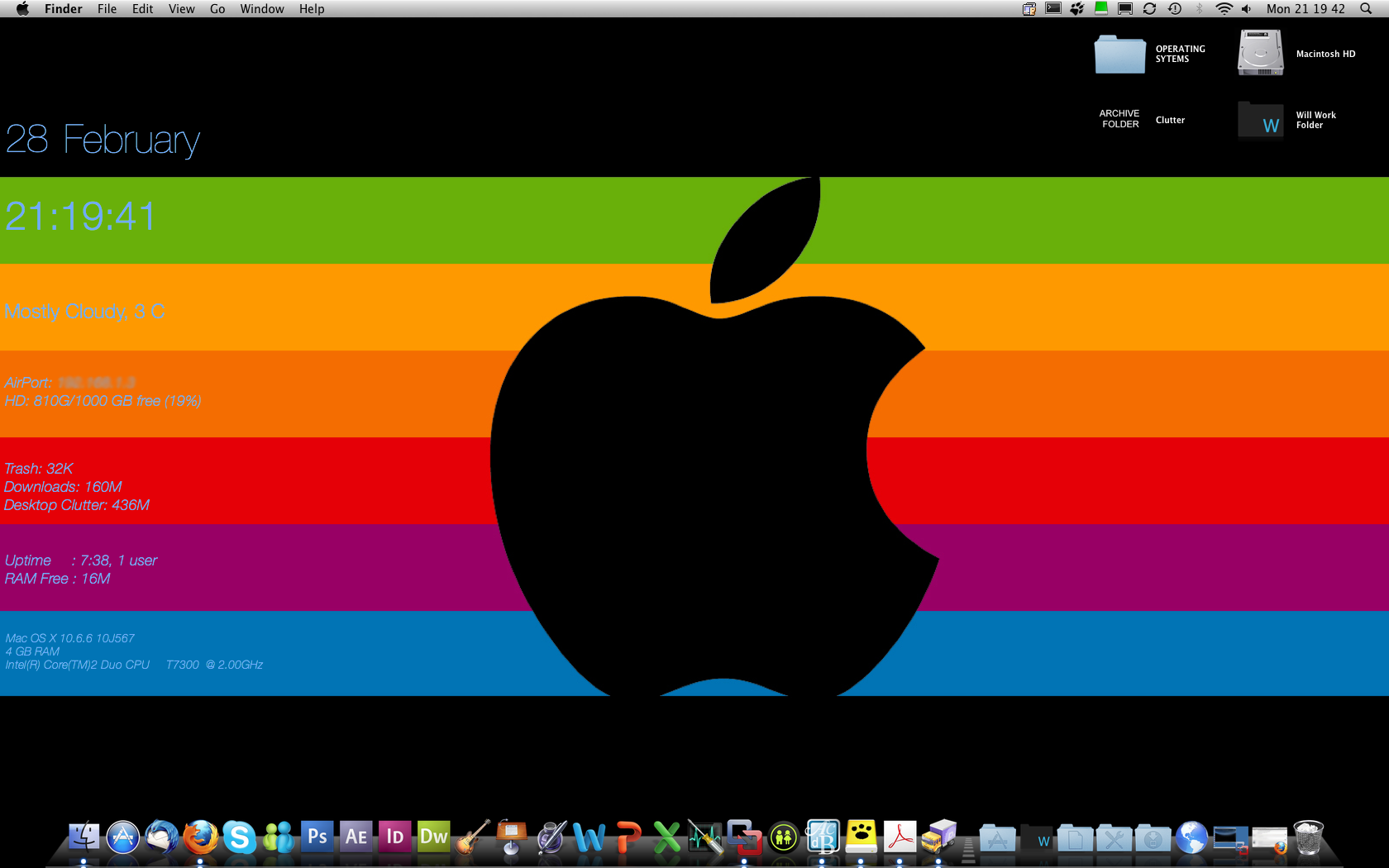

Well I thought I would share my setup. The desktop is from DeviantART (so credit goes to the person who made that).
And the very low amount of ram is becuase I am running Windows, and had just been running lots more.

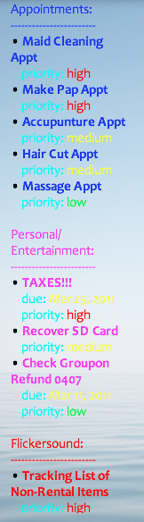

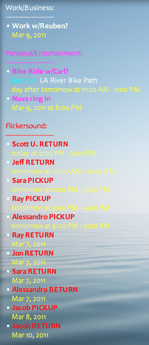

Is there a way to get the events or tasks to go across the screen instead of down? Basically, right now I have to extend the shell all the way down the desktop. I am wondering if there is a way to get the tasks and events to create a second column if I extend the shell across from left to right. Can anyone advise?
I am also wondering if there is a way to change "day after tomorrow at 11:00 AM" and "tomorrow at 1:00 PM" to something like "March 4th at 11:00 AM"
Please be very descriptive as I am VERY new to this application and KNOW NOTHING about script.
Here are the 2 shells and the commands I have now:
/usr/local/bin/icalBuddy -f -sc -sd eventsToday+3 | sed -e "s/*/--/" | sed -e "s/!/!!/"
/usr/local/bin/icalBuddy -f -sc -sd -sdta uncompletedTasks | sed -e "s/*/--/" | sed -e "s/!/!!/"
I have no idea what the second half of either of those codes is doing (| sed -e "s/*/--/" | sed -e "s/!/!!/"), I just copied it off this setup website (http://www.macosxtips.co.uk/index_files/display-ical-events-to-do-list-on-desktop.html)
Can you give some example output of those two commands? Just run them in terminal. Since I don't have any ical events or anything, I can't do it myself, and it didn't look like you gave the real output so I have nothing to work with.
Thank you for willing to help! When I copy/paste those above commands into terminal I get the following response: -bash: !/!!/": event not found
I am going to try and attach 2 screen shots. One for the Calender command and one for the To Do List command. (Please excuse the personal and somewhat embarrassing view into my world)
[Calendar Command] /usr/local/bin/icalBuddy -f -sc -sd eventsToday+3 | sed -e "s/*/--/" | sed -e "s/!/!!/"
[To Do List Command] /usr/local/bin/icalBuddy -f -sc -sd -sdta uncompletedTasks | sed -e "s/*/--/" | sed -e "s/!/!!/"
"-df, --dateFormat format" Format dates included in the output based on the format formatting string. See ""http://tinyurl.com/b9mgyp"" [apple.com] for documentation on the syntax to use. (note: in addition to the standard datetime element specifiers, you can also use the %RW specifier, which stands for ‘‘relative week’’ (e.g. ‘‘next week’’) and the %RD specifier which stands for ‘‘relative day’’ (e.g. ‘‘5 days from now’’).
from: http://hasseg.org/icalBuddy/man.html
so what you have to do is this:
Code:
/usr/local/bin/icalBuddy -df "%e of %B" -f -sc -sd eventsToday+3 | sed -e "s/*/--/" | sed -e "s/!/!!/"
didnt try it, but it should work.
I thought I would share my set-up.
Icons - Edited by me. (Original source "Helveticons")
Wallpaper - From Simple Wallpapers.
Date, time, and weather - Are simple and by me. I used Helvetica Neue for the type.
