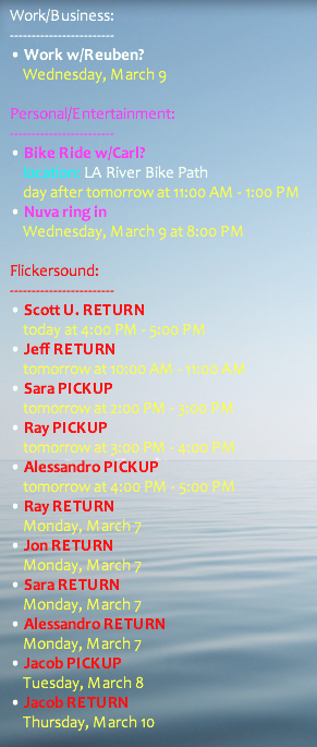

Dzurn! That's awesome. I think that is exactly what I need now. But please forgive me as I am very naïve when it comes to code and such. Here are my 2 commands.. where would I put the above code you suggested? Can you send me the code so I can just copy/paste? Sorry for any inconvenience and thank you in advance. This forum and its members has been so wonderful to me!
/usr/local/bin/icalBuddy -f -nrd -df "%A, %B %e" -sc -sd eventsToday+7 | sed -e "s/*/--/" | sed -e "s/!/!!/"
/usr/local/bin/icalBuddy -f -sc -sd -sdta uncompletedTasks | sed -e "s/*/--/" | sed -e "s/!/!!/"

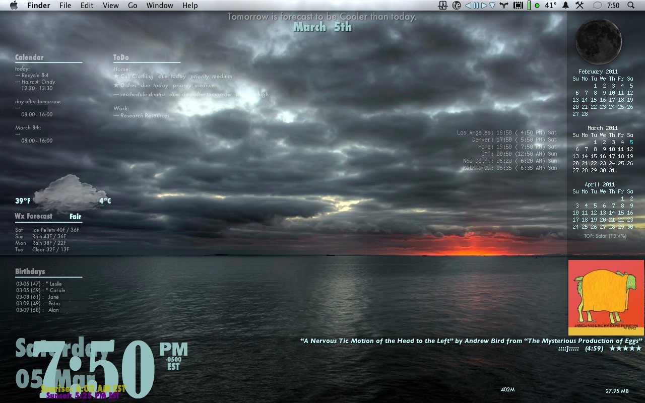

grabbing specific data from Wx feed
I have a pretty sharp geeked-up desktop if I do say so myself. Of course, I'm the only one who needs to care! 😀
One thing I have not been able to figure out is how to take a specific line from the Yahoo current conditions Wx report. I grabbed the image for the Wx showing up on my desktop perfectly.
I also have (from a script I nabbed) the "basic" Wx. For instance, when one goes to Yahoo Wx there is a small box with "Current conditions..." Then there is a short summary such as "Mostly Cloudy."
What I want to grab individually is the data from each line they have:
Feels Like; Barometer; Humidity; Visibility; Dewpoint; Wind; UV Index; UV Description; Sunrise; Sunset.
Ideas?
No problem. The marks like this "|" are called Pipes. That takes the output from the command on the left and sends it to the command on the right, and keeps going down the line. We can get really complicated using very simple commands this way. This is Unix shell scripting, and used outside GeekTool it is extremely rewarding and super-powerful! Your computer work could become much easier just learning a bit as you go.
So to "simulate" two columns, we use pipes to send the icalBuddy lines to head/tail lines. "Head" and "Tail" commands just take the input and give back a number of lines of the front or the back of the list in the pipeline.
As a dirt-simple example of head and tail, to show just the second week of the current month, you could use this:
cal | head -n 4 | tail -n 1
Now for your request: "head -n 20" gives the first 20 lines. To get the NEXT 20 lines, we do "head -n 40" to get the first 40, then "tail -n 20" to show the second set of 20 lines. For your own display, play with how many lines will fit and adjust these numbers in head/tail until you get it to work.
First command, first 20 lines:
/usr/local/bin/icalBuddy -f -nrd -df "%A, %B %e" -sc -sd eventsToday+7 | sed -e "s/*/--/" | sed -e "s/!/!!/" | head -n 20
First command, second 20 lines:
/usr/local/bin/icalBuddy -f -nrd -df "%A, %B %e" -sc -sd eventsToday+7 | sed -e "s/*/--/" | sed -e "s/!/!!/" | head -n 40 | tail -n 20
Second command, 1st 30 lines:
/usr/local/bin/icalBuddy -f -sc -sd -sdta uncompletedTasks | sed -e "s/*/--/" | sed -e "s/!/!!/" | head -n 30
Second command, 2nd 30 lines:
/usr/local/bin/icalBuddy -f -sc -sd -sdta uncompletedTasks | sed -e "s/*/--/" | sed -e "s/!/!!/" | head -n 60 | tail -n 30
Enjoy!
Darryl

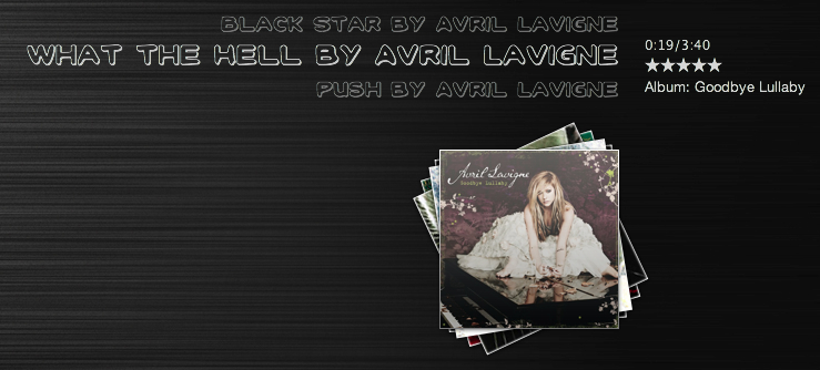

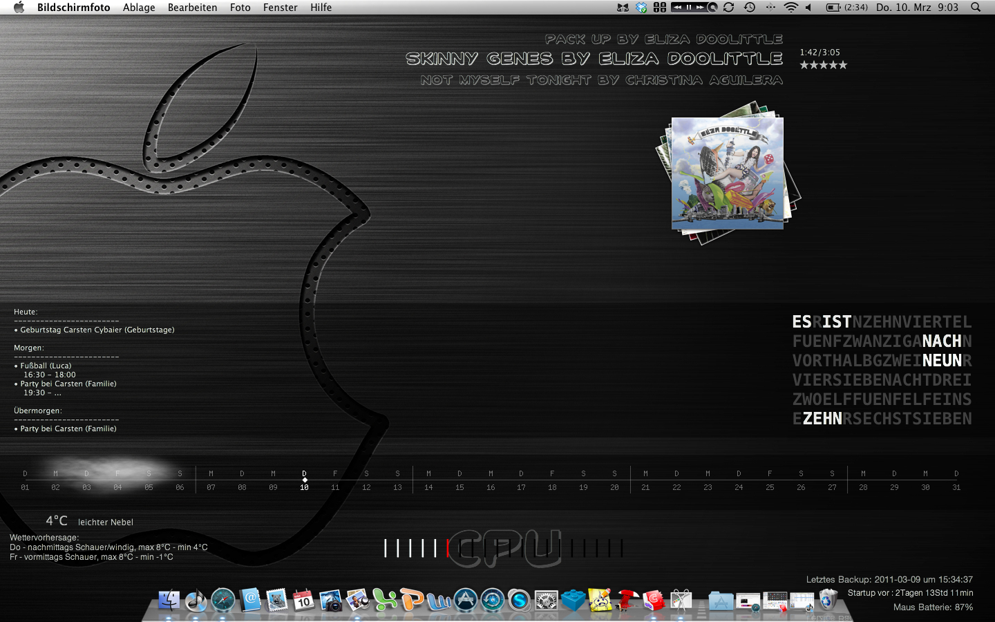

Thank you for the answer. I have done a lot of things with geektool. Also using codes from this thread here. This thread is one of the best source for geeklets! 😀
Here is my actual desktop before I have implemented your code. But I will do it right now 😉
EDIT: "trackplaylist" is the word I didn´t know before. This was my problem! 😉

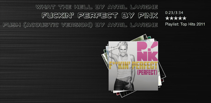

Solved: Album or Playlist getting out of iTunes
With the help from brenm666 I have managed to get these information out of itunes I have searched for.
Now I would like to share the whole script for those who are also interested in.
I have pimped it a little to have two variations: when you play music from the iTunes library there was no information on playlist or album, just Music .
I have changed this to have the album name when you are listening to a special album or the name of the playlist when you have chosen from a playlist.
When iTunes is not running, nothing is shown on the desktop.
And here is the complete script:
set info to ""
tell application "System Events"
set the process_flag to (exists process "iTunes")
set apps to every process whose bundle identifier is equal to "com.apple.iTunes"
if (apps is {}) then return
end tell
if the process_flag then
tell application "iTunes"
if player state is playing then
set trackplaylist to name of current playlist
set albumName to the album of current track
if trackplaylist is "Musik" then
set info to "Album: " & (albumName)
else
set info to "Playlist: " & (trackplaylist)
end if
else
if player state is paused then
else
end if
end if
end if
end tell
info
end if
Have fun... 😀
