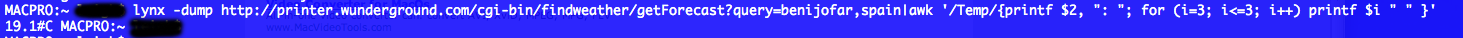

Thanks for that but unfortunately it only shows the temperature in Celsius. This is what I got when I ran it : 32.2#C.
After a bit of playing around I managed to knock something up using the weather forecast from Accuweather. It probably is not the most efficient way to do it, as I have never used the commands before, but it does display the correct information and relatively quickly.
Code:
 curl -s "http://rss.accuweather.com/rss/liveweather_rss.asp?metric=0&locCode=EUR|ES|SP016|BENIJOFAR"| awk /"Currently:"/ | sed 's/<title>/ /' | sed 's.</title>. .' | sed 's/Currently:/ /'
e.g.
Sunny: 79F
The only slight problem is that it has leading spaces and I am not sure how to get rid of them.
Really? Because it definitely is reading as fahrenheit on my computer (it is definately not 70 degrees celsius). Attached is a pic showing the output (in black) of the script that I posted - copied directly from the post and pasted into a new shell
Maybe try the script again

I've just tried the script and it works fine (giving the same output as in my post above - it is the same location as chas0001). Try changing the colour (to something totally different to your wallpaper) and size of the output - the default output is small & black and can thus be lost in dark colored wallpapers.
Hmm no luck. I made a hot pink widget that worked for the time. Duplicated it and changed the command to the lynx code and got a blank screen.
Thanks for the replies, though!
Not sure why we get different results. Perhaps its due to the location of our IP address that WUndergound reads. In europe we are supposed to use celsius but I prefer fahrenheit. Bloody European Union.
Thanks for looking into it.

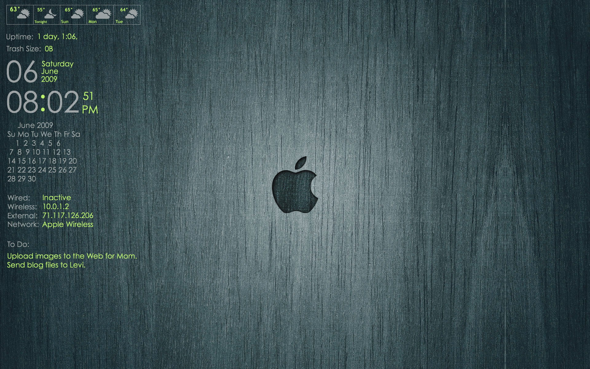

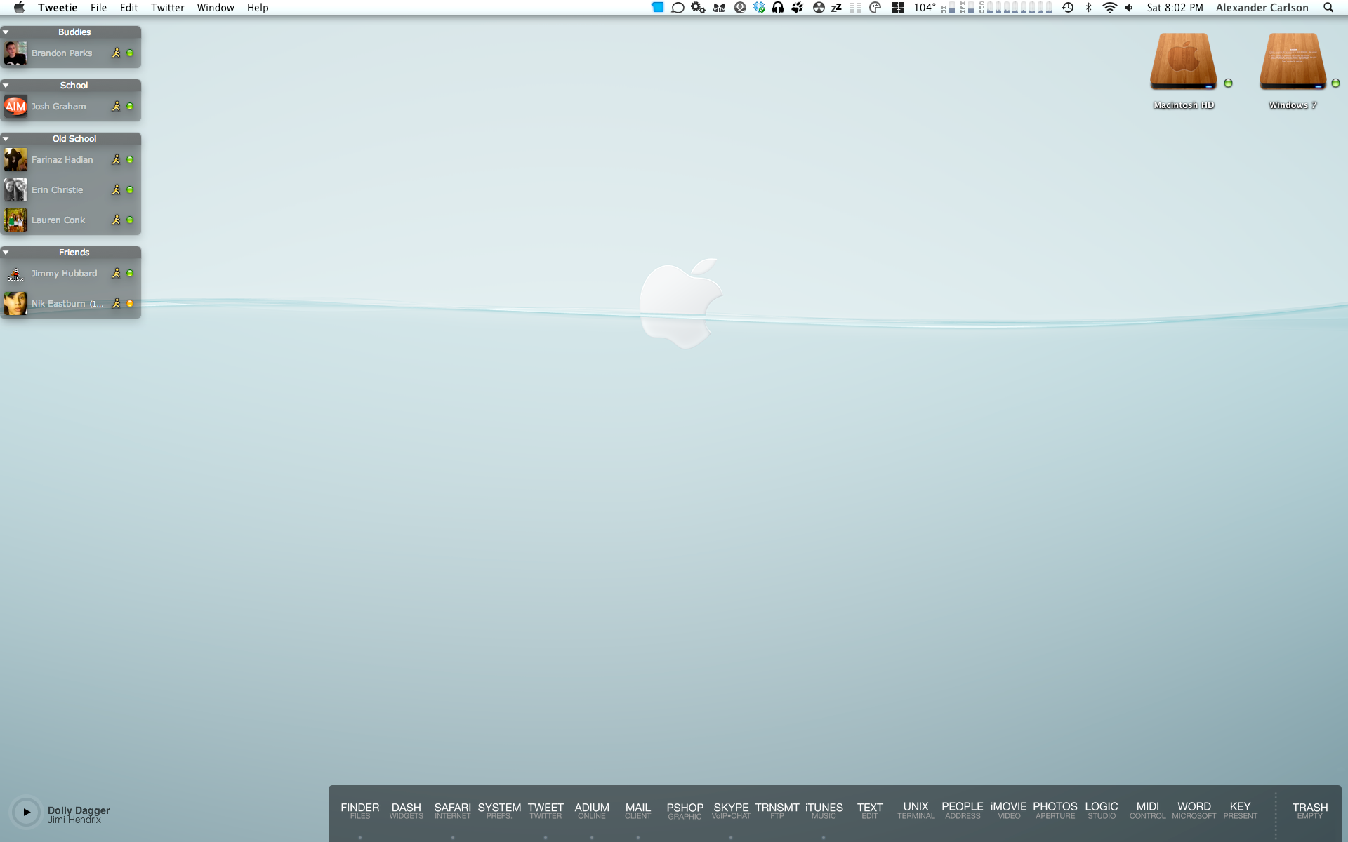

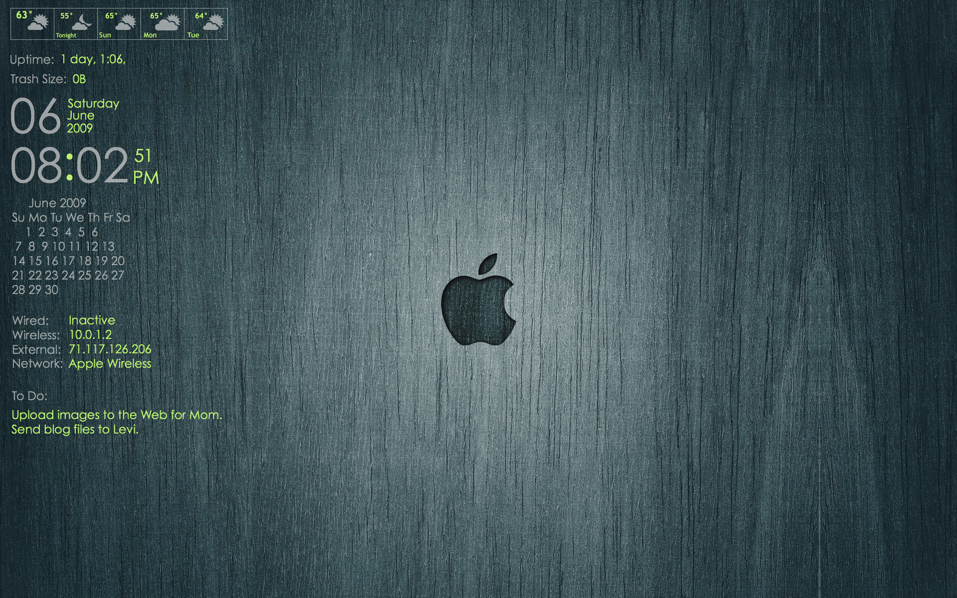

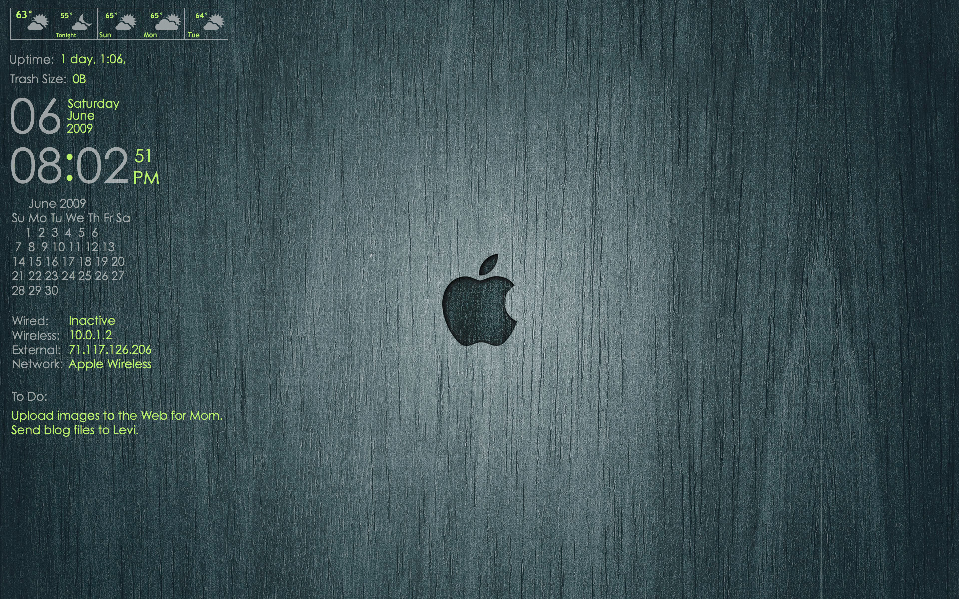

My GeekTool Setup (Dual Displays)
Hey guys,
So I've been playing around with GeekTool for a while now, just for fun. It's a wonderful program, and amazingly versatile. One thing I love about it is that it has given me lots of practice using terminal. The only problems I have run into are miscellaneous GeekTool crashes, which are a real pain in the ass. One minute, I'll be typing in a new uptime script, and the next minute, every script that I have has been replaced with the "cal" command, making me start from scratch. It seems to me that nothing can be done about this, except for starting over. Many of the scripts that I have were taken from the net, though they are from different websites. To make it simple, I will include a list of the commands that I used, as well as the icons, widgets, docks, wallpapers, and bowtie themes.
Lets begin. Please know that I am starting with my left display, working my way from the top down, left to right. Please also know that I am putting the scripts in [BRACKETS] in order to avoid any confusion on where the scripts end and begin. Please remove them when pasting into GeekTool:
1. WidescapeWeather-- a Yahoo! widget.
2. Many of my actual scripts do not have labels included. Instead I added them seperatley by typing [echo "Label Goes Here!"]
3. Uptime-- [uptime | awk '{print "" $3 " " $4 " " $5 " " }']
4. Trash Size-- [du -sh ~/.Trash/ | awk '{print $1}']
5. Day (#)-- [date +%d]
6. Day (of the Week)-- [date +%A]
7. Month-- [date +%B]
8. Year-- [date +%Y]
9. Time (H+M)-- [date "+%I %M"]
10. I wanted the colon a different color, so I typed [echo :]. If the color/formatting is not important to you, it would be easier to type [date "+%I:%M"]
11. Seconds-- [date "+%S"]
12. AM/PM- [date "+%p"]
13. Calendar-- [cal]
14. Network Interfaces/External IP:
[myen0=`ifconfig en0 | grep "inet " | grep -v 127.0.0.1 | awk '{print $2}'`
if [ "$myen0" != "" ]
then
echo "$myen0"
else
echo "Inactive"
fi
myen1=`ifconfig en2 | grep "inet " | grep -v 127.0.0.1 | awk '{print $2}'`
if [ "$myen1" != "" ]
then
echo "$myen1"
else
echo "Inactive"
fi
wip=`curl --silent http://checkip.dyndns.org | awk '{print $6}' | cut -f 1 -d "<"`
echo "$wip"]
15. Current Network-- [system_profiler SPAirPortDataType | grep -e "Current Wireless Network:" | awk '{print "" $4 " " $5 " " $6 " " $7 " " $8}']
16. To Do-- cat [/path/to/your/todo.txt] (This is most effective when used with the todotxt script available here.)
17. Adium-- with modified versions of the HUD color theme, combined with the 65% Transparency list layout. Message style is called "minimal_mod," and I use the black vs. grey setting within that. I also use the iChat status icons.
18. iTunes-- I use a program called Bowtie to manage itunes track info on the desktop. Within Bowtie, I use a version of the minimal_mod theme, which I customized myself to be darker. If you want a copy, email me. My email is [liystalander@mac.com].
19. My drive icons are called "Wooden Slick Drives." The Dock icons are from the "Kobhens" pack. Finally, my overall system icons are from a set called "Rave-Up System."
20. The green indicators next to the drives come from a GeekTool script. [diskutil info /dev/disk0]. Change the disk# to whatever it is for the drive you want to monitor. Also, be sure to hide the output and use default icons within the shell settings in GeekTool.
21. The dock is called Bezel. Find out how to change it here.

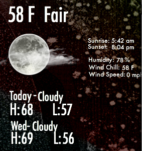

Any chance of getting to see the final script you used for the weather? or tips on making it work?
First of all, you need to have up-to-date perl libraries. You can google that to find out how. Second, what you see comprises many different scripts, each one gives a specific output, e.g., one for sunrise, one for wind speed, one for tomorrow's high, etc. What's important and what was getting a lot of people confused is that you need the entire path/to/script in geektool under shell before you put your desired modifier. So, for example, if I wanted to display the time of sunset, I would put 'Users/<my computer's name>/bin/yweather-dir/yweather.pl -ss', where ss is the command for that output.
Let me know if you have any more questions.
