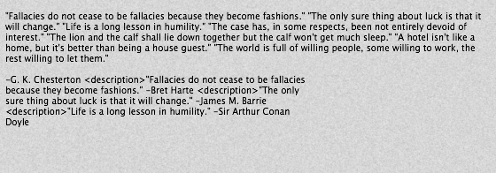

Hey,
I'm sort of new to this so I'm in need of help. Could somebody be so patient to update the quote of the day-script? The quoted above almost works but sadly only almost

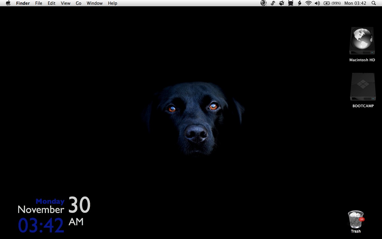

Well, I prefer to keep my desktop pretty clean and dark... and don't really 'use' it much.. but couldn't resist the Geek - added date and time to my desktop - font is Gill Sans.
Fun tool - took some rummaging and trial and error to find out how to use it.. and some time to line those geeklets up nicely so it'll be ok when the 'January' and etc with lower descenders (? is that the correct font stylee term? ) come round....
Quotes of the day
Hey,
Maybe this helps:
