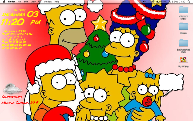

Sorry to be a pain, but as you can see from my FIRST, few hours with geektool, and just this forum, thanks for that,
I just can not get, the weather for my place, I have gone to the website in question, and entered my local (de551ll, alfreton), but as you can see it just puts the words, "conditions"
I have read many of the weather posts, but just cant get it to work.
Also why I'm here, my plans are to add further speech bubbles like the 1 I have added to lisa,to contain things like itunes play list, cpu or any other recommendations you care to throw forward.
So guys, hope someone can help this noob.

appreciate the help mate, but serisouly not 2 seconds ago, I managed to get this working,
I used a combination of....this youtube video from...CoolEnufForaMac
and the script on page 48 of this thread.
But the impotant bit for me that has caused a lot of problems, was make sure I went to yahoo weather feed, entered my area, then clicked the RSS button, and got the area code from the address url,and pasted that into the right place on the script on page 48.
Long winded I know ...but
...all in all I get this.....
Now all in all guys, I've had a mac for about 2 months, this is my first ever go on geektool, but bar a few hiccups, really enjoyed it, and these forums have been invaluable, .
My next plans are the speech bubble you see, putting some stuff in there, or I may play with putting what I have already in there...
So I may return tomorrow, lol
thanks again guys.

Interesting - I copied and pasted this verbatim right into geektools ver. 3 running on a MacPro. It works w/o chmod. See attached screenshot.
Click to see it bigger.
