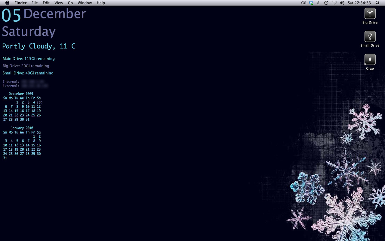

Interesting - I copied and pasted this verbatim right into geektools ver. 3 running on a MacPro. It works w/o chmod. See attached screenshot.
OK, you're right, that works too... :)

spent way too long doing this
I know what you mean. The first couple of nights fiddling with GeekTool was fun, but it kept me awake far too long and away from other stuff I should have been doing instead.
