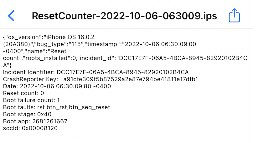

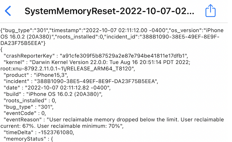

I think I have this problem too, although the symptoms are not identical. From reading all the posts, I agree with @Kier-XF that it is a software problem, for a number of reasons not necessary to document here! My situation, if for no other reason than to document it for others:
1) Received iPhone 14 Pro Max on launch day, it is now on iOS 16.0.2. Two weeks in, I experienced my first overnight restart. Last night was my second restart overnight.
2) Overnight my iPhone is close to 100% charged, I sit it on a Belkin wireless charger, in DND focus.
3) My analytics do not show any panic messages, the two pictures below are the closest to what likely happened. I don't know much about these messages, but one is a SystemMemoryReset, one is a ResetCounter. I have multiple of both messages in the Analytics.
4) After the first restart, I swiped up and closed all apps, thinking it could be an app bug. I also restarted twice.
5) I have not had any restarts during the day, and it's locked on a Belkin wireless charger much of the time. If I had to guess, the connection seems to be charging overnight, and in DND focus. Without DND, it's a situation my iPhone has been in a lot over the last few weeks without any restart.
6) The other funny thing that happened both times. Overnight notifications for Gmail and Yahoo weather did not show a preview, even though both are set to preview always. The only way I could get them started to show previews again was to completely clear the notification center. I tried toggling notifications, when to preview, restarted the phone with them closed... yet nothing changed this problem until notification center was cleared. Odd.
I am going to stop charging it overnight, and see if I get a restart again or until iOS 16.1 is released.
I sure have my fingers crossed that iOS 16.1 fixes this, although my failures are less than some of you.

You need to look for "panic-full" in the Analytics Data, it's sorted alphabetically.
I had my phone for at least 8 days before I saw the first crash. I think multiple things have to line up before it will start doing it. If this happened to every single iPhone out there, then this would have seen much more publicity and probably a fix would have been out in the stable release.
As @Kier-XF said, this is fixed in 16.1 beta 4. I installed the beta two days ago and have not seen a single crash/panic since then, and I had it every single night and multiple times doing the day on 16.0.2 since I first had it happen.
Sorry I wasn't clear, I did know to look for that, and I have no panic-full entries in the data. It restarted twice without one.
