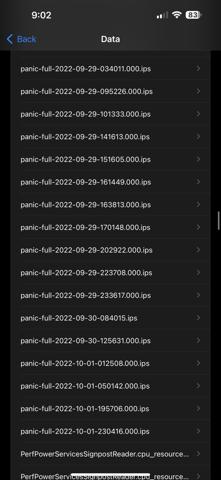

Does someone know how to sift iPhone logs? I woke up to a 13PM that didn't wake up this morning. And nothing I tried worked to wake it up. The up/down/Sleep-wake, charging or not charging, plugging into my various macs, doing the mute toggle and the up/down/sleep-wake. NOTHING worked. I got my 12PM activated with my provider, so I had a phone at least, but couldn't get the 13 to wake up. Went to the Apple Store, and they connected a cable with a weird block inline, and it woke the heck up! I could have saved nearly the entire day traveling!
So they showed me logs on the iPhone and said that I could send it in for service, and they there would be able to sift the logs and figure out what happened. Why would I have to have them 'send it out' for that service? I know logs can be a little worse than nothing when scanning them for details, but being without it for a week? Oh, and they refused to replace it. (I also found out that there had never been a backup of that phone too. Oops)
Sifting logs? Is it really that hard? I'd assume that they are in Console somewhere once it's synced?
Dying to know what happened. All they would say is 'software issue'. And I didn't have 16.0.2. The minion said they have had a few iPhones in with similar symptoms, and one .2 is installed they are fine. So why isn't Apple requiring it, and pushing the install rather than letting people apparently find that update. They recovered it, somehow, but it was still kind of a wasted day, but it has a history now I guess.
Sifting logs...
