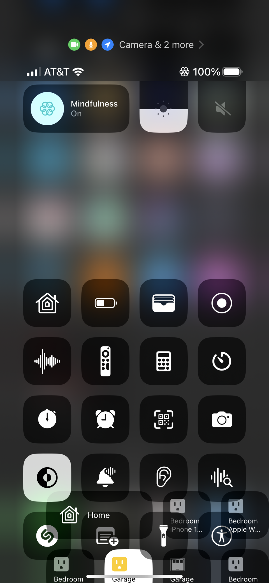

It introduced new bugs for me, like having to reboot the phone to connect my Apple watch Ultra. Could be an Ultra bug as I have had rapid connection drops In the past and had to reboot. The photo I posted of the control center is another. Lools like it’s the Homekit Controls that act up. I enabled and disabled and so far it hasn’t happened again. Might have to turn that feature off.

All the 16.1 Beta 4 glitches I experienced are now gone, I think the Apple Watch update helped, and messing with the homekit control center settings also solved that one. The Reobbots were a hassle and they are now gone.
