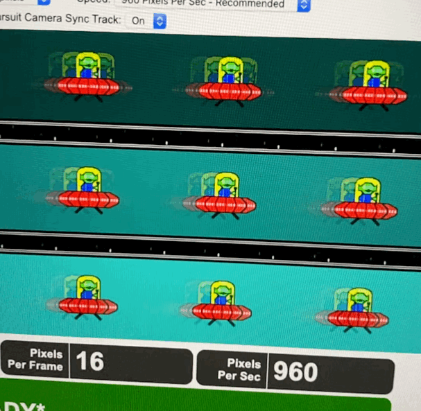

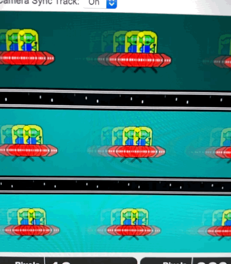

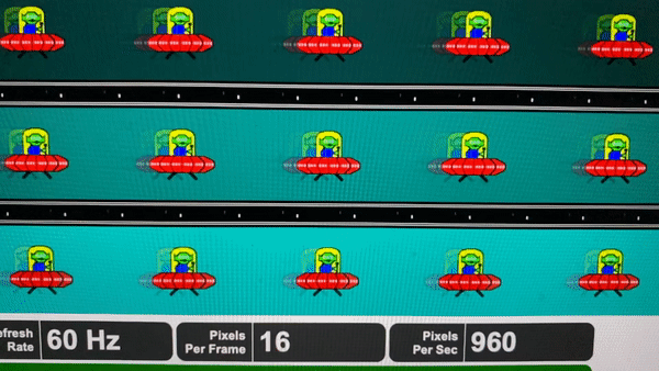

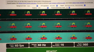

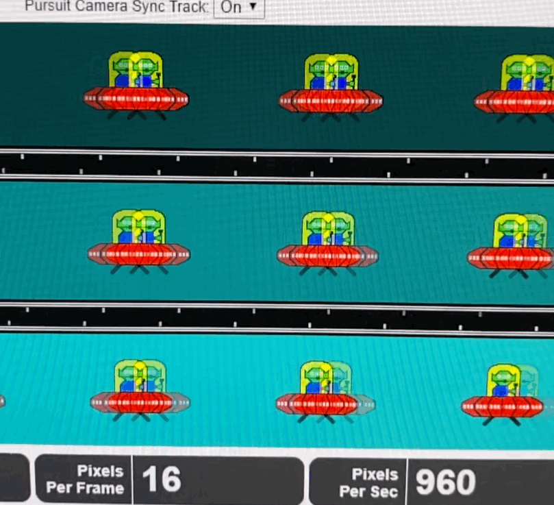

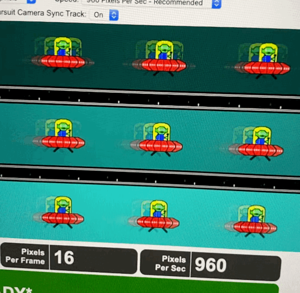

Got my 16" three days ago and upgrading from the maxed out late 2013 15". I understand that some are more and some less sensitive to the issues. If I hadn't read about this, I surely wouldn't have noticed anything and it doesn't bother me at all.
When scrolling text, I don't notice anything that bothers me, even when looking for the issue.

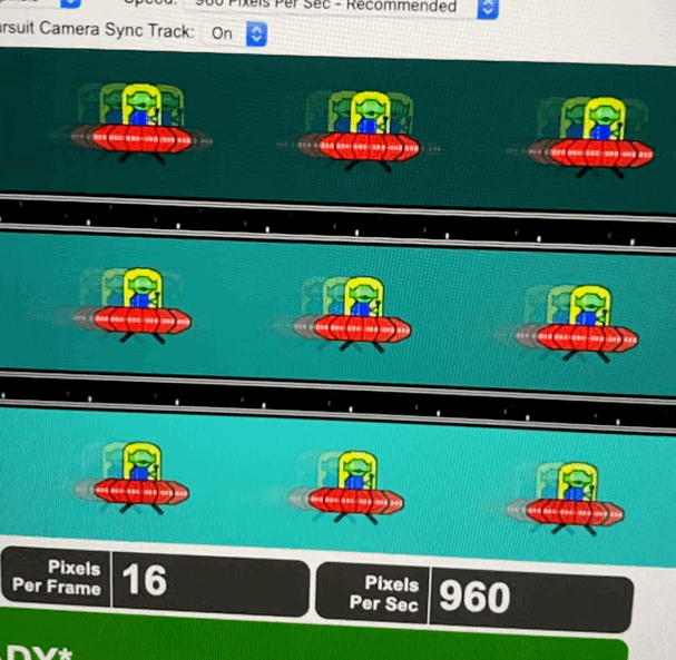

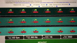

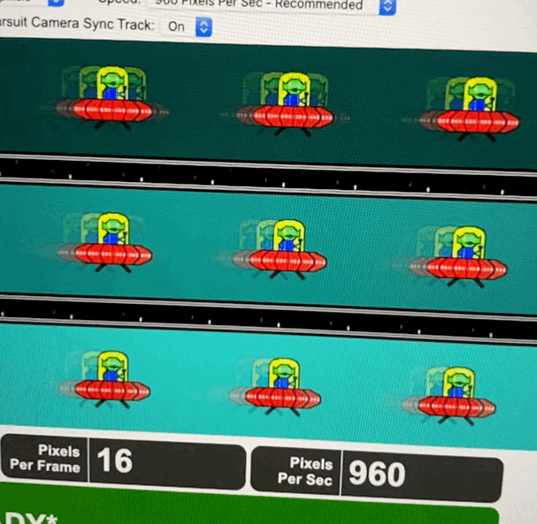

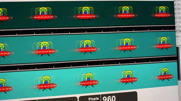

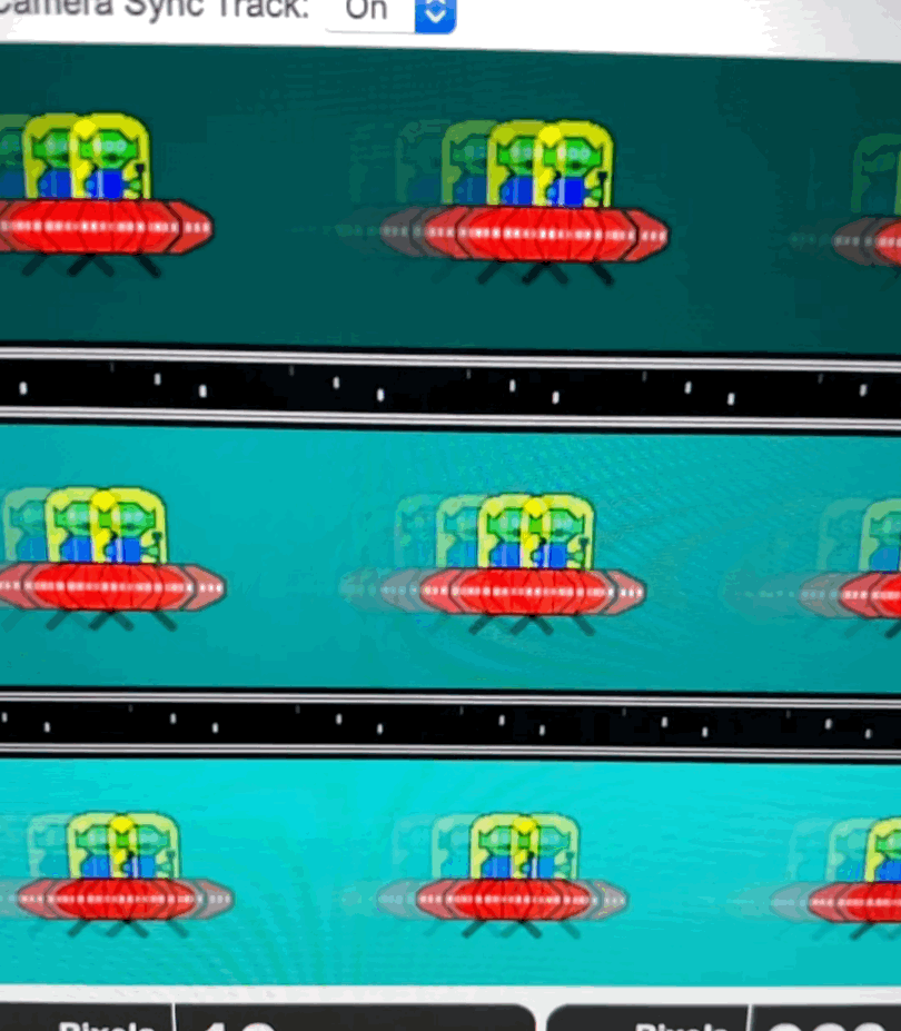

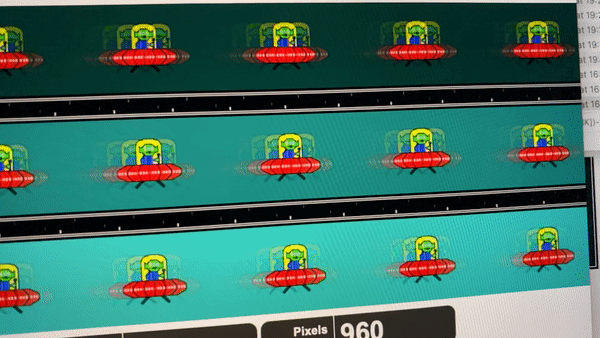

Here is a comparison of the ufo test filmed with iPhone slow motion:
late 13 15":
16":
Both have some ghosting but the 16" has clearly more.
Now that I am used to the 16", the 15" seems a bit glossy and the image and text not as crisp to me, so in actually use, I definitely prefer the 16".

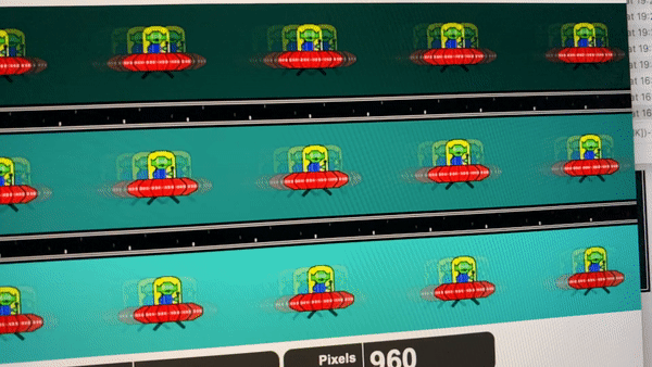

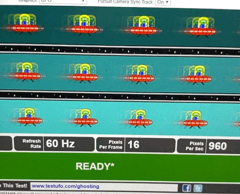

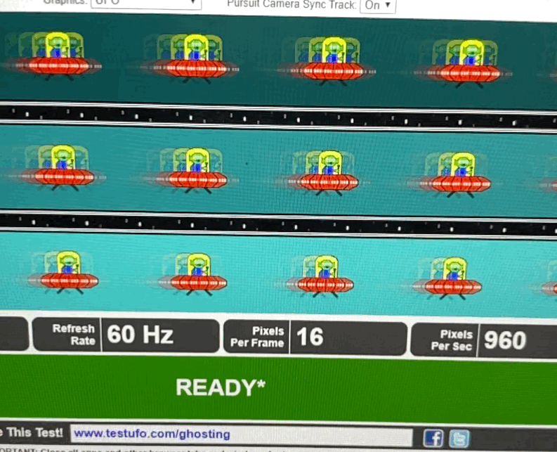

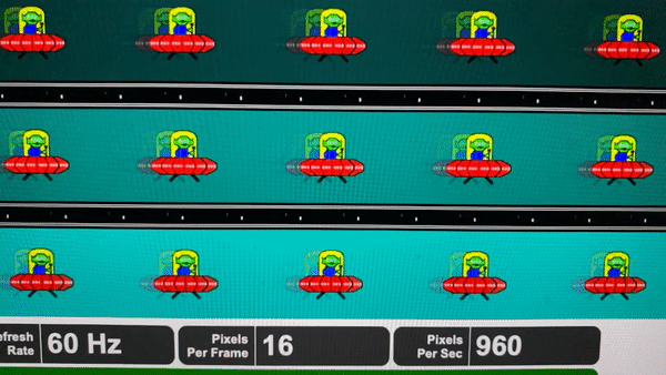

I've purchased MBP 16" for my main personal computer.
The highend original configuration is the one I bought.

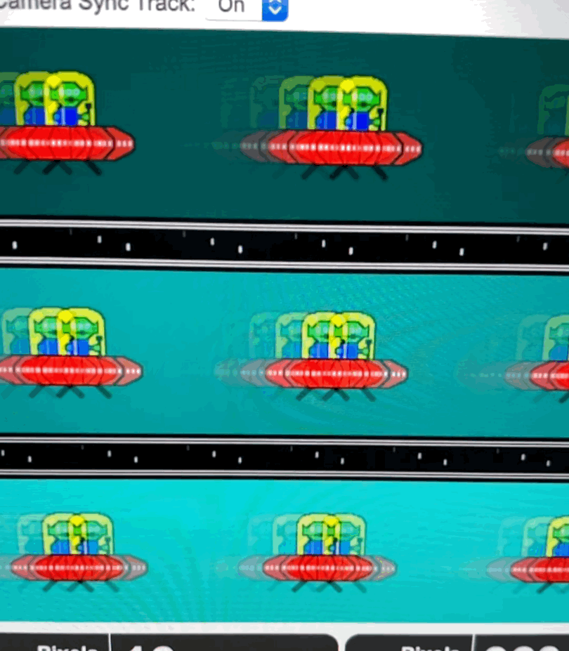

Since I own several screens to compare, I did some testing to see if I can see the difference in MBP 16". I captured the usual UFO test page with 240 slowmotion camera on iphone, and made GIF out of the video.
Below are the result:
MBP 16"

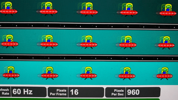

MBP 13"
and LG 27UD99 4k UHD Monitor 27"
So obviously the external monitor offers the best response, but comparing to 2019 13" MBP, my 16" seems almost the same.

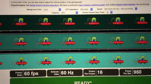

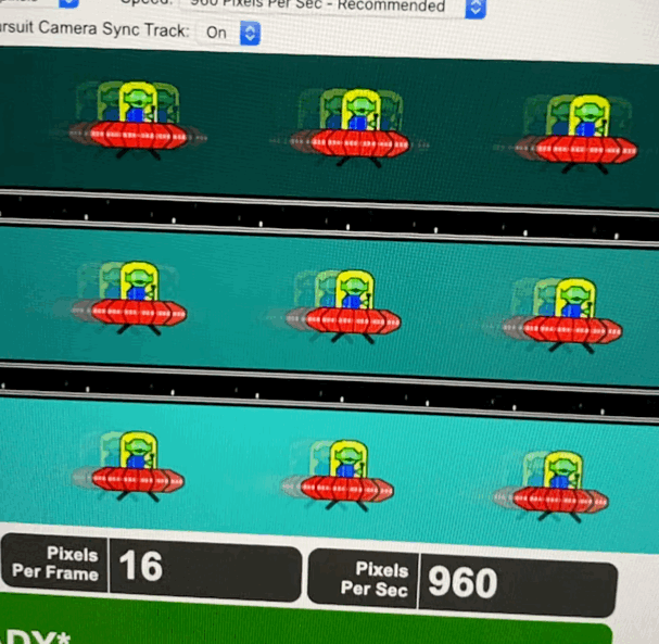

Since I also own Lenovo Thinkpad P1 Gen2, I did the same test on P1.
Lenovo Thinkpad P1 Gen2 with 4k Screen
By the way, all the test were done while in 60hz.
So obviously, either my MBP 16" is a good one or all laptop screens are about the same. Although somewhat difficult to see, I think P1 is the worst.
I was rather amazed by the response time of my external.

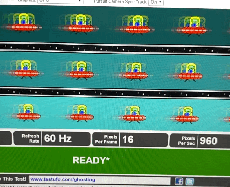

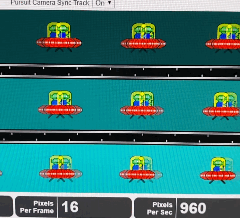

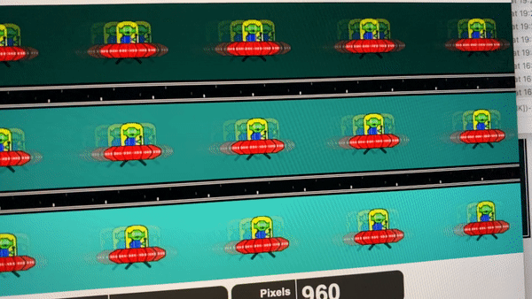

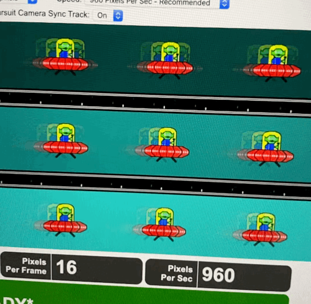

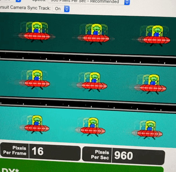

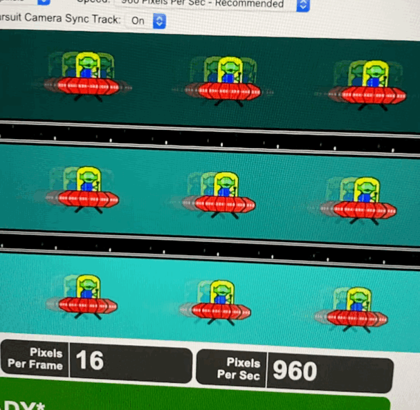

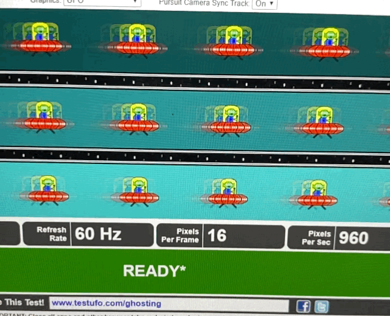

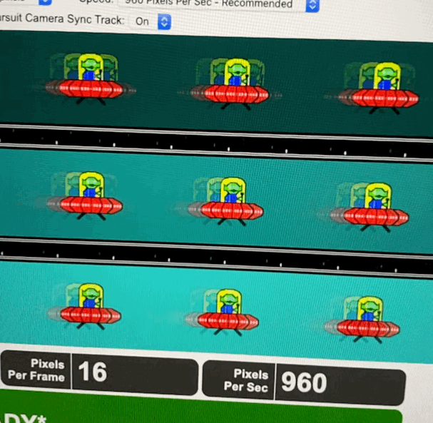

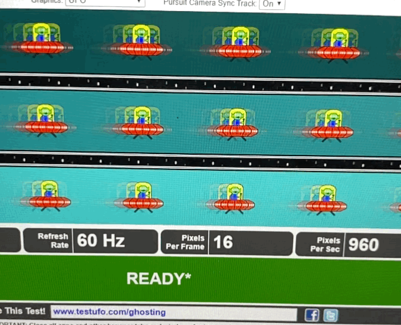

Can you please post your panel model id using the command above?
Mine is the LP160WT1-SJA3

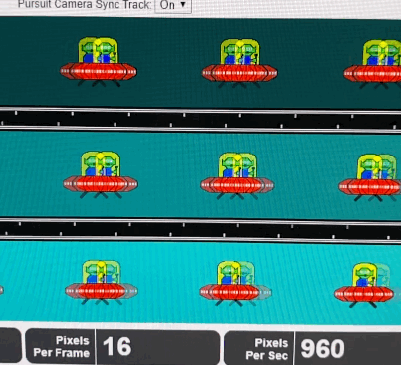

So it seems true that the SJA4 is considerably better, the difference in the ufo test is quite visible.
Difference between the SJA3 and the SJA4:
SJA3:
SJA4:
The way it's captured seems different. So I'm not sure if both can be compared. However, the alien on that UFO seems almost a whole as entirely separate alien in trailing image. I'm not sure if it's really different or else resulting from different way of capturing stuff.
It'd be really intresting to see the video captured in the same way for SJA1.
Yeah, I was thinking the same, maybe slightly less on the 2013 15" but SJA3 and SJA4 look the same to me.
