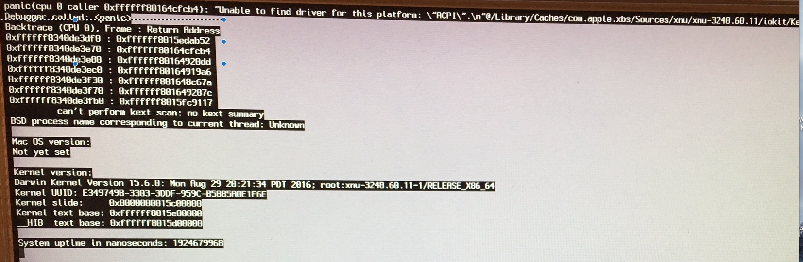

This morning I tried to install El Capitan 10.11.6 on an USB key from a Macpro 1,1 with El Capitan and Pike boot.efi (don´t ask), and when I rebooted, my boot SSD with El Capitan was named OSX INSTALLER and it just stayed there. I panicked and put again the pike files, but not luck. I have a spare partition with Snow Leopard, and I can see the SSD has all my files, and users, but doesn´t boot as normal. Any ideas if I can delete some files or something. Thanks for your time.

I've come across an issue and cannot seem to find anyone else whose had it. When running terminal, I do everything like it says to on the video and then I get this message.
== ERROR
== A problem occurred when replacing the boot.efi files for the installer volume
== This is very odd and does not usually happen. I don't know what to do!
== Close all other windows (especially terminal windows) and try again
Any help would be greatly appreciated. `
