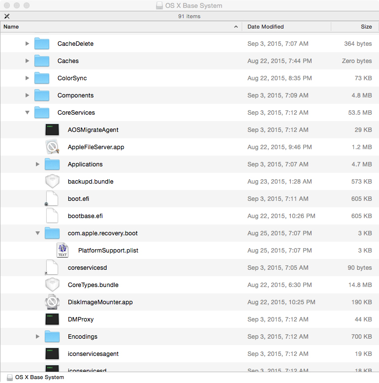

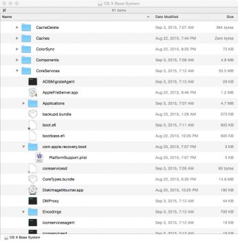

bootbase.efi is extant in the .dmg in the 10.11 Recovery HD partition (see attached).

My hunch is that the presence of bootbase.efi must have some significance to designate the El Capitan Recovery HD as such, and I believe that file is NOT present in the regular El Capitan partition. If my hunch is correct, the successful use of csrutil enable/disable might be achievable by simply replacing the stock bootbase.efi with Pike's boot.efi and renaming the latter. Chances are that running certain options of csrutil (such as disable) requires the execution of code routed explicitly to bootbase.efi (which is not available in the non-recovery version of El Capitan). On an old Mac Pro, an unmodified bootbase.efi will simply fail to run because of their 32-bit EFI. But I might be wrong, of course. This is only a theory.

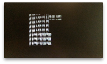

First version that sets csr-active-config for RecoveryHD only.
  • boot 3087c0804ced60d424a39df0b91b749139e434bc.zip

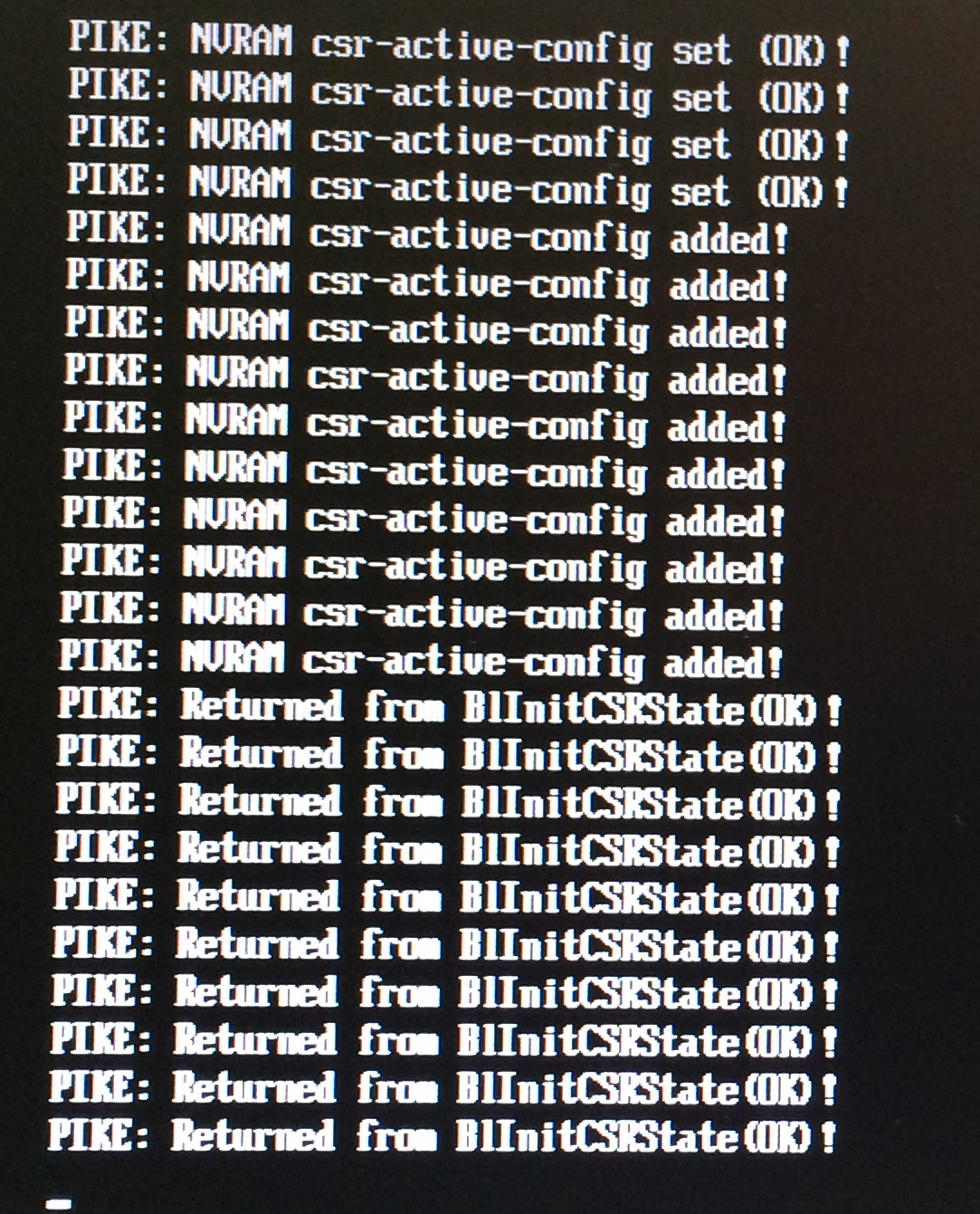

placed this new boot.efi on the Recovery HD and also inside the BaseSystem.dmg (replaced both files, boot.efi and bootbase.efi of course). this didn't change anything. there's nothing in the NVRAM about csr-active. and the command csrutil disable still gives the same error "failed to modify...".
Reactions: PeterHolbrook
Two new versions for mikeboss's tests.
  • boot 69166f3ced25352d4b3d71abc0c91d01979a71ed.zip
  • boot 69166f3ced25352d4b3d71abc0c91d01979a71ed modified.zip

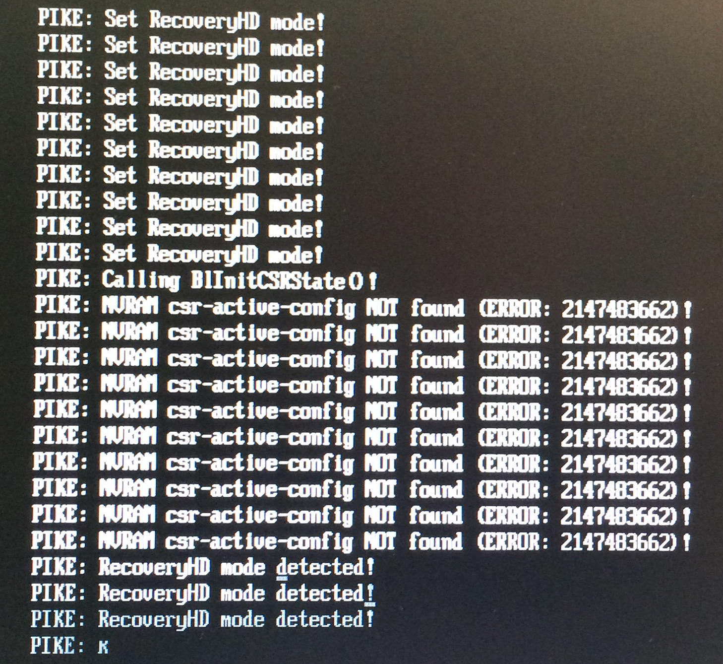

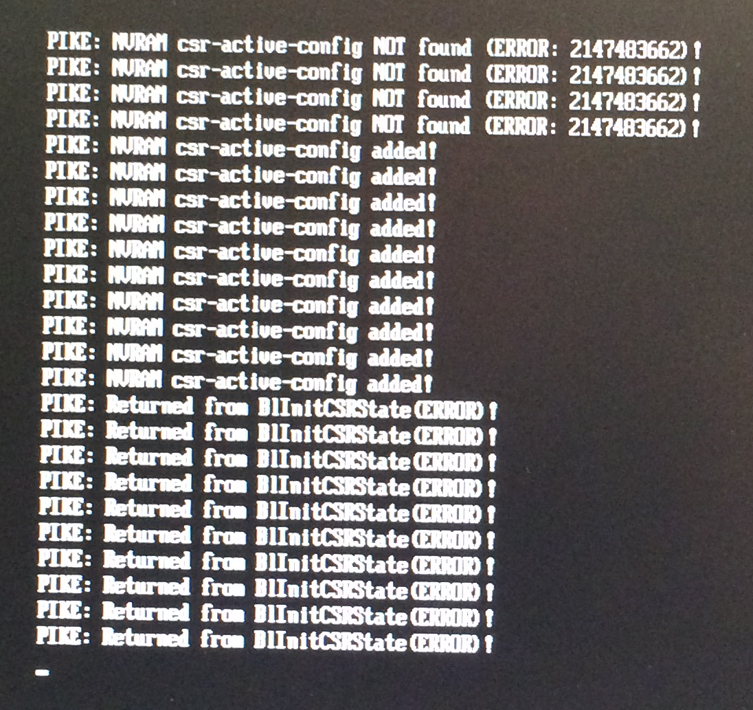

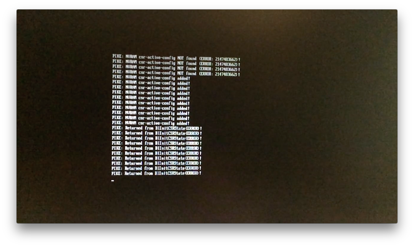

normal: no csr entry in NVRAM. csrutil disable fails.
modified: csr-active-config with value EAAAAA== in NVRAM! csrutil disable fails.
Although these are from a later commit, I have reasons to believe they are functionally equivalent to the ones built immediately before. Just in case...
  • boot dd53ed0cc82b2fb9f8accac56b3c3af2271e6ac0.zip
  • boot dd53ed0cc82b2fb9f8accac56b3c3af2271e6ac0 modified.zip
I cleared the NVRAM with option-command-P-R and booted into the Recovery HD which is prepped with the latest boot.efi. NO csr-active entry to be found in NVRAM. csrutil disable failed. I then tried to reboot into standard El Capitan (which still has an older, working version of the new boot.efi installed). the system is stuck at the blurry desktop picture with the beachball of death where I should see the login screen. did an unsave shutdown (poweroff), cleared NVRAM with opt-cmd-P-R and again tried to boot into El Capitan with no luck. hard reset and boot into Yosemite. emptied NVRAM with "nvram -c". reboot into El Capitan is not working anymore. how is this possible? I will do a fresh re-install tomorrow (it's almost 1 A.M. over here in central europe).
