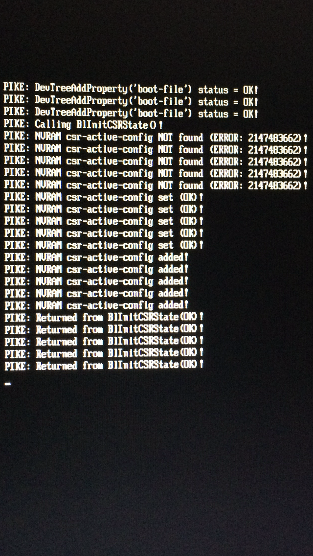

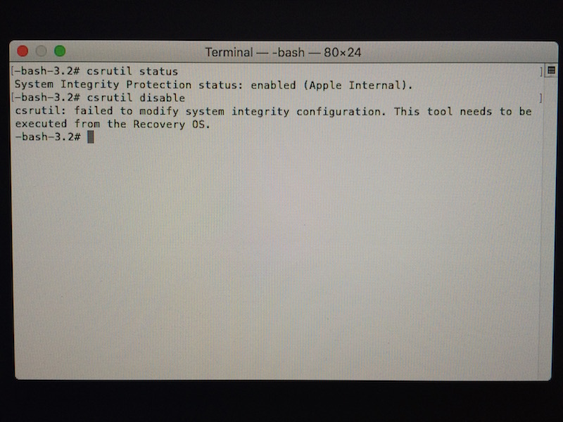

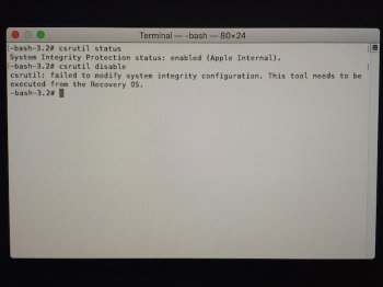

report for the testing of the latest commit: booted first into Yosemite 10.10.5 to make sure that there's nothing about csr-active-config to be found in the NVRAM. reboot into the El Capitan Recovery HD: csrutil status -> enabled (Apple Internal). no entries of csr-active in NVRAM. csrutil disable failed. reboot into El Capitan (which still runs on an older release of the new boot.efi) worked flawless.

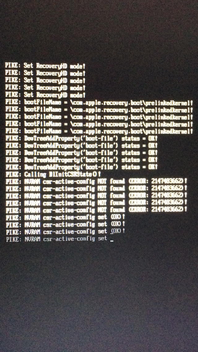

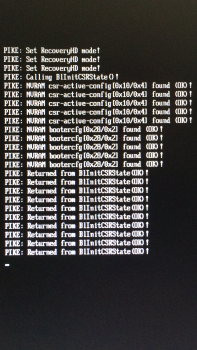

screenshot of the debug output from latest boot.efi:
I cleared the NVRAM with option-command-P-R and booted into OS X Yosemite. ran "sudo nvram -c" to make absolutely sure that there's nothing in NVRAM. reboot into El Capitan Recovery HD. nvram -xp -> csr-active-config present! value "EAAAAA==". IdlePML4 present with value "0NrOAoD///8=". csrutil status -> active (Apple Internal). csrutil disable failed. reboot into El Capitan (with older boot.efi in place) -> blurry desktop picture & BBOD; NO login screen; unable to SSH into the machine! yup, I turned on remote login this time ;-) did a hard reset and rebooted into the Recovery HD without issues. tried again to boot into El Capitan without success. reboot into Yosemite to set the NVRAM vars Pike mentioned I should try if boot into El Capitan fails -> happy-happy: got the login screen again.

cleared NVRAM -> El Capitan only gets to the blurry screen with BBOD. booted into the Recovery HD: csr-active-config present in NVRAM with value "EAAAAA==". csrutil disable failed. reboot into Yosemite to set the NVRAM vars manually (nvram 7C436110-AB2A-4BBB-A880-FE41995C9F82:csr-active-config=%10%00%00%00 and nvram 7C436110-AB2A-4BBB-A880-FE41995C9F82:bootdercfg=%28%00) and El Capitan boots again just fine.

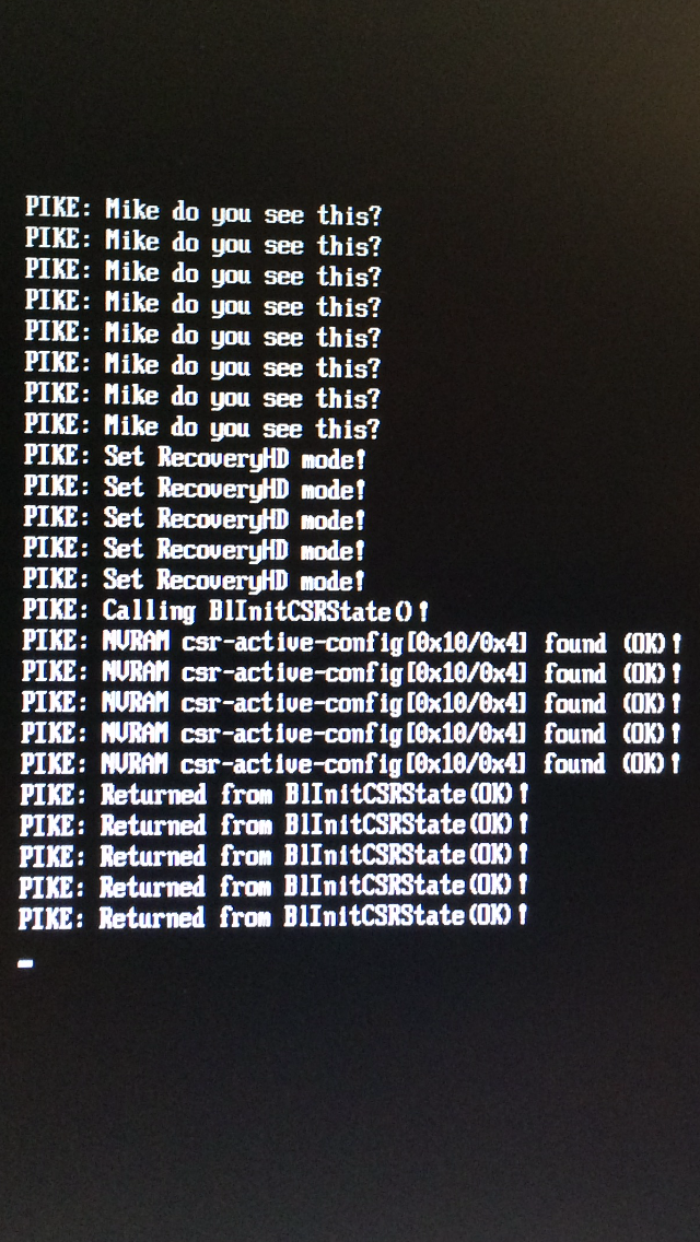

Special debug output for Mikeboss.
  • boot eb6d3ad59ed58cf98d1ab80c60083823859178d2.zip
this is "Special debug output for mikeboss" commit -> cleared NVRAM -> El Capitan only gets to the blurry screen with BBOD. bootroot-active and boot-file are absent in ioreg.

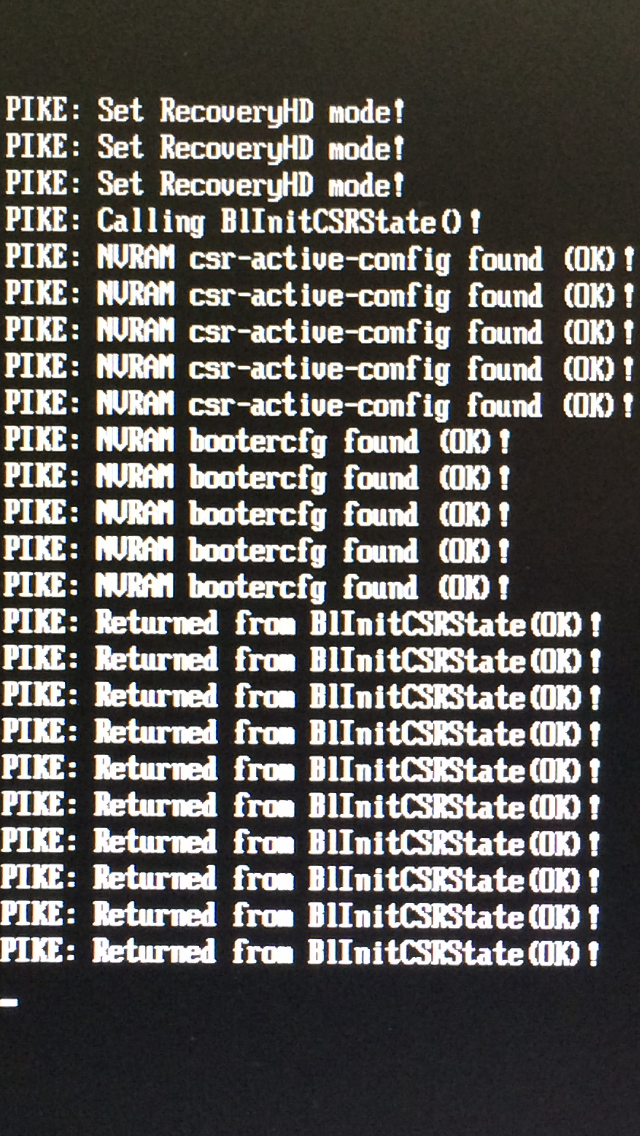

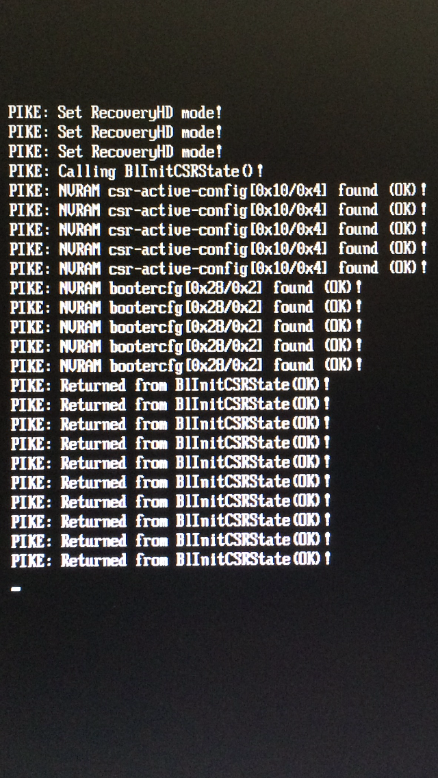

Set EFI_VARIABLE_NON_VOLATILE for Recovery HD only.
  • boot a2c4a4b1c2097ef742be283013aaee1d94807418.zip
latest commit: csrutil disable failed. boot after clearing PRAM into Recovery HD -> csr-active-config present in NVRAM. bootroot-active and boot-file are absent in ioreg.
