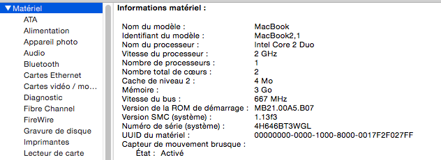

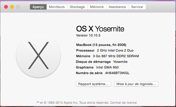

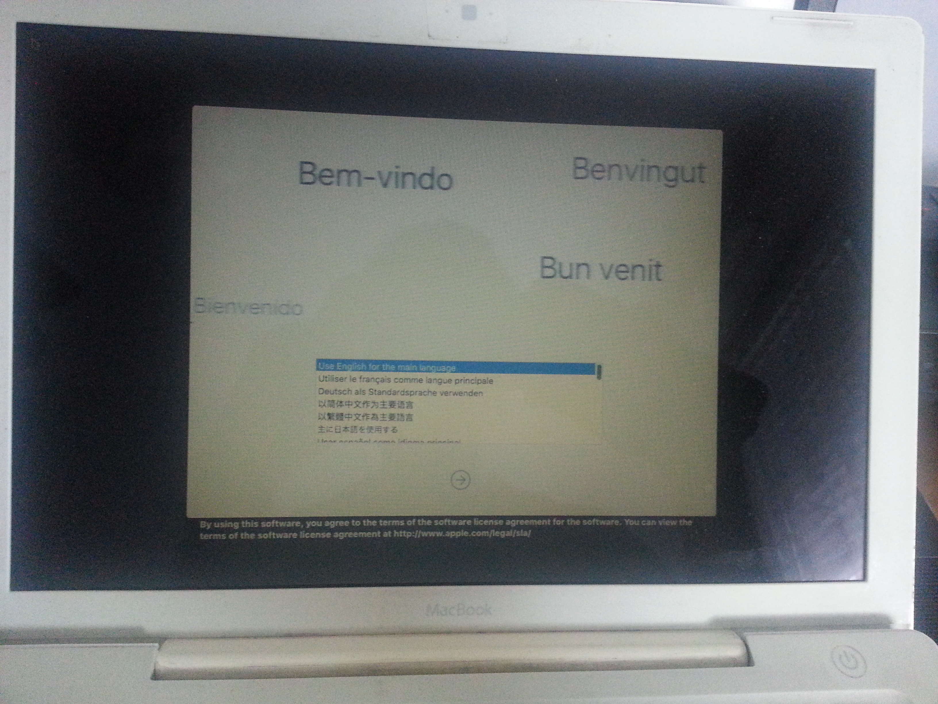

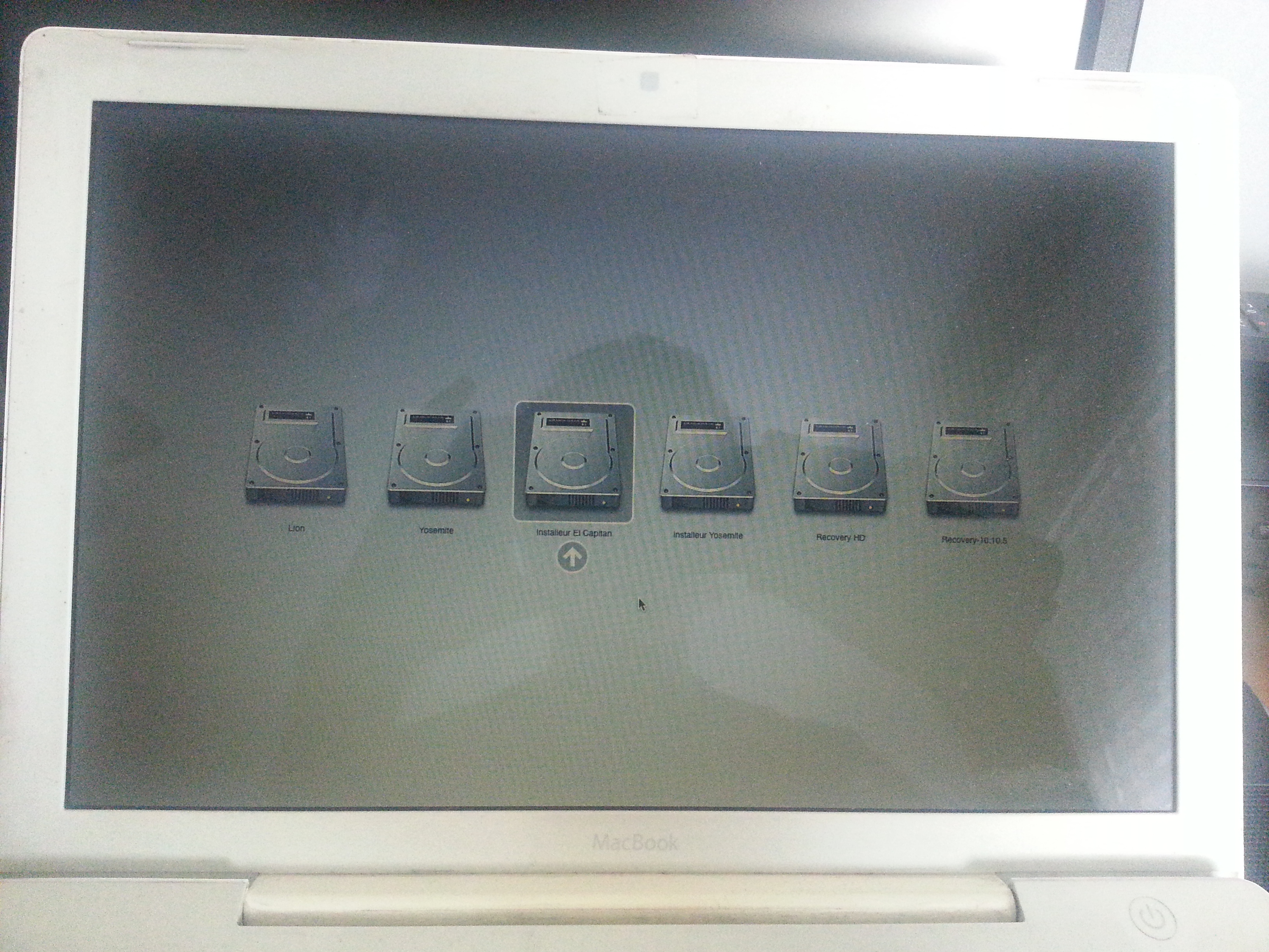

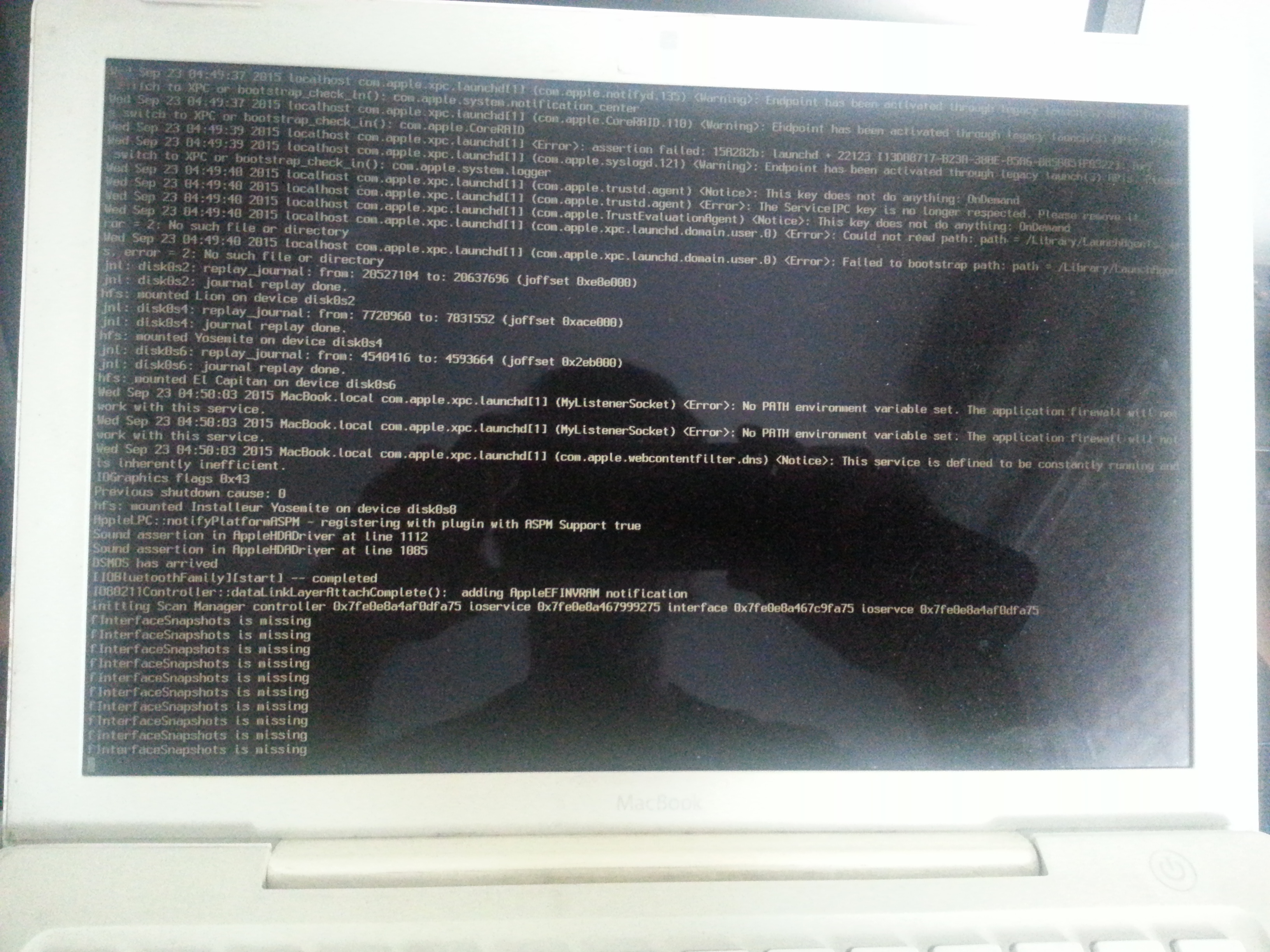

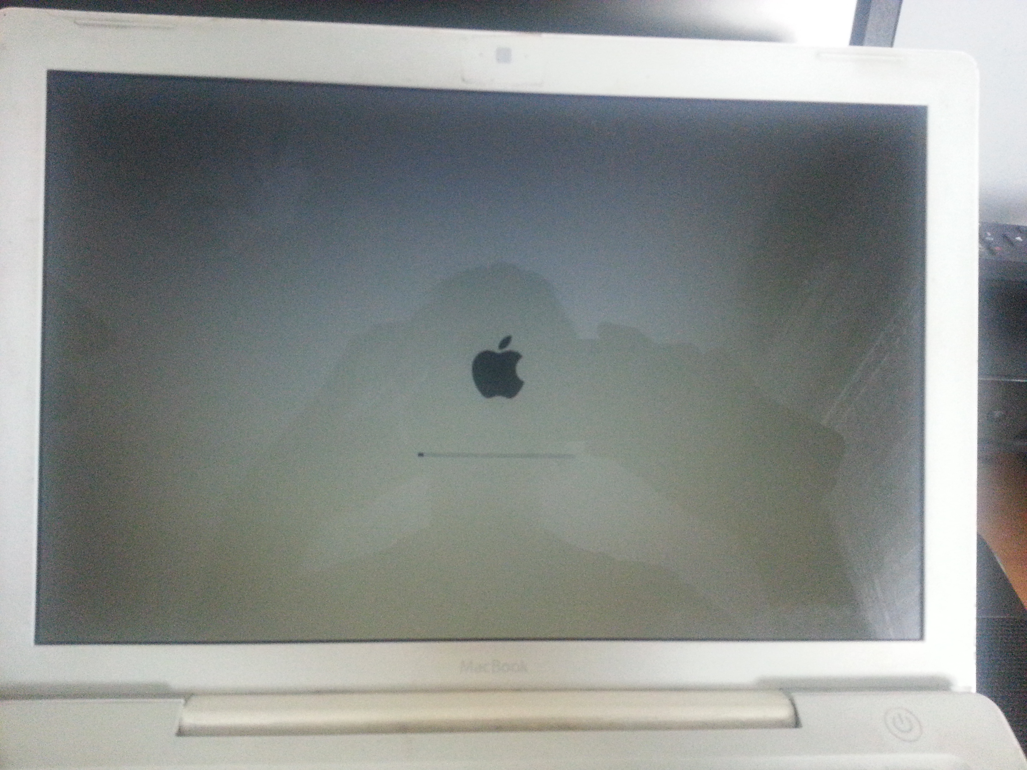

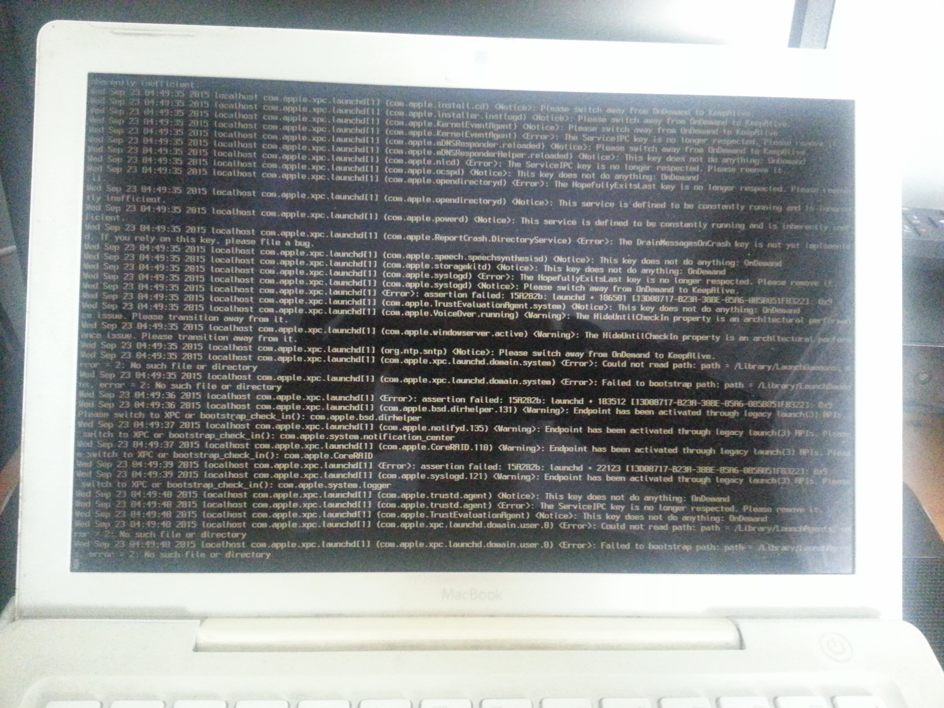

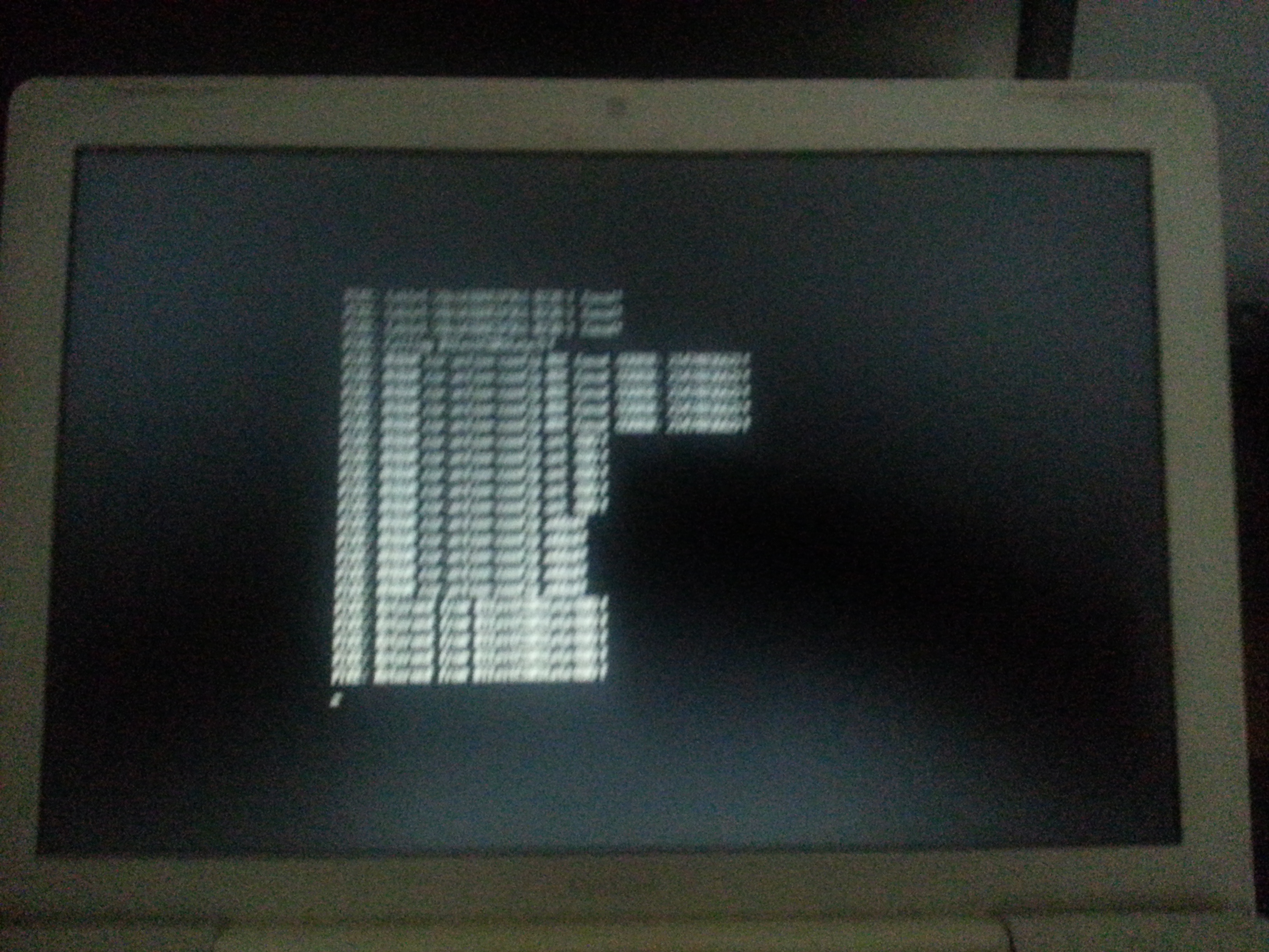

Hi every one, I need help ; I was unable to go further than the screen installation of el Capitan GM_Candidat:
my keyboard is not recognized and my touchpad so. I have put the last efi.boot.:
I have a white macbook 2,1 of 2007 no Pro.
thanks advance.

How To do to disable csrutil on macbbok 2,1 of 2007 Pleased ? thanks advance.
I don't know if your machine supports El Capitan or it doesn't. I will assume, just as a hypothesis, that it does. To disable SIP (not carutil as you say), you simply boot to the El Capitan Recovery HD, open Terminal, enter "csrutil disable" (without the quotation marks), and, if successful (it should be, if it is a supported Mac), it will ask you to reboot your computer. When it does reboot to the regular El Capitan partition, SIP will be disabled. To re-enable it, simply boot to the Recovery HD again, open Terminal, ente "csrutil enable" (without the quotation marks), and, if successful (it should be, if it is a supported Mac), it will ask you to reboot your computer. Do it and, when it reboots to the regular El Capitan partition, SIP will be enabled.
Edit: Sorry, I hadn't paid due attention to the fact that you were quoting my mention of Pike's request about Clover. If you are booting El Capitan on your presumably unsupported Macbook via Clover, your input would be useful to Pike, but I don't know how you can access the Recovery HD from Clover (supposing there is one). You should probably ask people that use Clover on a regular basis. The farthest I went with such bootloaders was with a version of Chameleon that booted Mavericks.
I'm not installed clover. I have just unsupported macbook 2,1.

You'll note that this thread is specifically about Mac Pros. There is a separate thread about El Cap on other Macs. The USB issue is well established there.
People with Mac Pros don't have the USB issue so we will be unable to help.

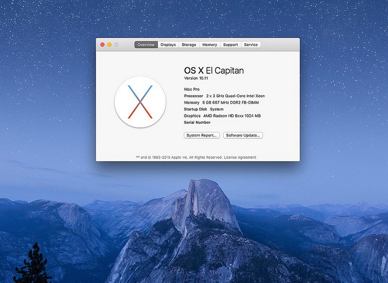

As an aside, here's a "quick and dirty" way of installing El Capitan on an old Mac Pro. It's already been tried by others (666sheep was the first, and he can correct me if I am wrong, or he can explain the procedure in more detail):
  • You'll need an unmodified installer for El Capitan
  • You'll also need a genuine Mac that is compatible with El Capitan (a reasonably recent MacBook, iMac, Mac Mini or Mac Pro)
  • You'll also need a copy of Pike's boot.efi
  • You'll also need an HDD or an SSD where El Capitan is going to reside (to be placed inside your old Mac Pro when the whole process is over).
  • Lastly, you MAY need an external USB, FireWire or Thunderbolt enclosure where said HDD or SDD is to reside during this procedure.
  • Copy the installer to the "modern" Mac.
  • Run the installer. Choose the presumably external HDD or SSD as the target for installing El Capitan.
  • Once El Capitan has been installed, search for boot.efi on that HDD or SSD (it's in a couple of folders, identified in Hennesie2000's guide) and erase it (in both places). Copy Pike's boot.efi (in both places) and set permissions as prescribed in Hennesie2000's guide (you'll probably have to run Terminal for this).
  • Eject said HDD or SSD from the "modern" Mac, extract it from its enclosure (if necessary) and place it in one of the old Mac Pro's bays.
  • Boot the old Mac Pro. You'll probably have to use an alternative OS X partition on the old Mac Pro (such as Snow Leopard or Lion, or a DVD installer thereof, or a valid Recovery HD partition) and, once booted, select the disk with El Capitan as the Startup Disk, then reboot.
  • If all has been done correctly, you should get to El Capitan desktop. Enjoy.
Please, notice that for these modern operating systems to work on an old Mac Pro, you'll need a more modern graphics card, not just Pike's boot.efi.
I wanted to thank Peter for this post! I may be a little late to the game so to speak but I got El Capitan installed and working on my 2007 MacPro 1,1 (firmware updated to 2,1) this evening using the procedure above. I have to say having my Mid 2012 rMBP to install El Capitan made doing this so much easier. Once my 500GB SSD was formatted and new OS installed, all I had to do is plug in the drive to one of my bays and start the computer up. Yeah... it was just that easy. Thanks again Peter and to everyone else who was involved for making all of this possible!

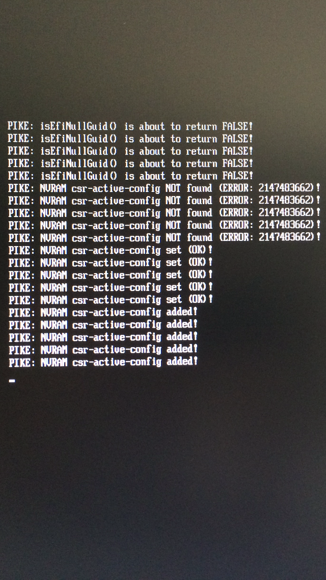

System-id changes.
as far as I can tell, commit 0f76ac85bee944287f7a01866a5f71cb13c7d0bc behaves the same as the version before. " ioreg -lw0 -p IODeviceTree | grep system-id" gives value "00000000000000000000000000000000". El Capitan boots flawless if NVRAM empty. csrutil disable fails. csrutil status -> enabled (Apple Internal).

Commit a556a2e555bf773886ec312da7af2e3d58ee5946: system boots normal, all tests conducted give the same results as before.
