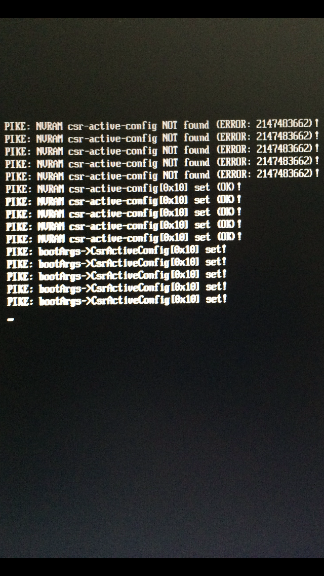

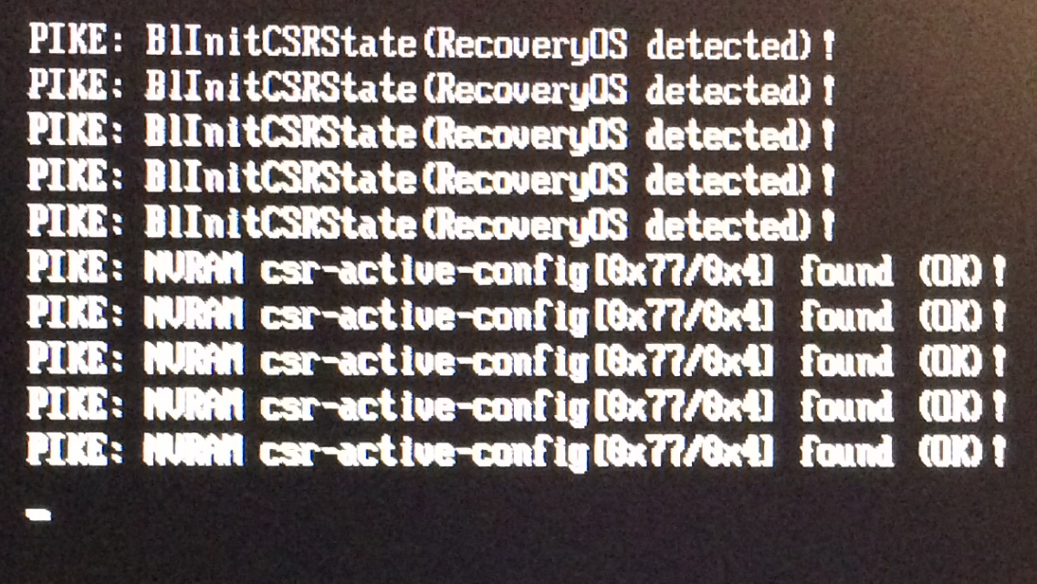

commit 303daeeb80c6fca0d04b69ab99761da6293b222c booting into Recovery HD with NVRAM emptied: csrutil status -> enabled (Custom Configuration). value in NVRAM is “gAAAAA”. csrutil disable -> success, value in NVRAM "dwAAAA". csrutil enable -> OK, value in NVRAM "EAAAAA". csrutil status -> enabled (Custom Configuration).
