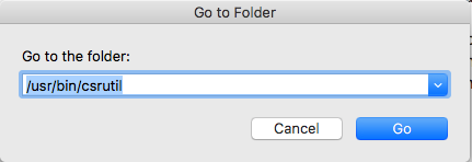

tried to cp boot.efi to /System/Library/CoreServices/ but not permitted, tried to disable sip by booting into recovery partition, but no terminal app...WTF? csrutil doesn't seem to exist either..
Try this and report back please.
Top menu bar...
Finder->Go->Go to Folder
This should take you to csrutil, it does for me.
