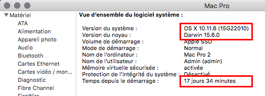

Hello,​
I'm back, following my posts #4299 of July 20, 2018, #4419 of Sep 16, 2018 and #4430 of Oct 3, 2018​
regarding the operation of the update "SecUpd2018-004ElCapitan" with Kernel 2017-005.​
After 5 months EVERYTHING IS STILL STABLE !!!
I just restart my mac pro after 17 days of intensive use and still no instability.​
Reactions: Madr
Hello,
Fix SecUpdate ElCapitan Mac Pro 1.1-2.1 Start Loop.dmg
