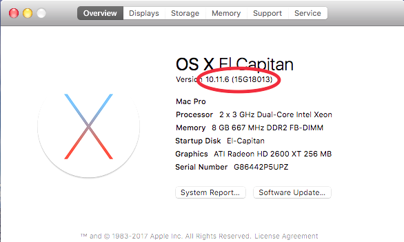

Does anyone know how I can find out which security version the install I have done has
A little late with the reply, but the info might help someone else.
The version info you mention can be found under "About this Mac -> System Report -> Installations"

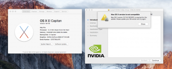

Wonder if anyone's seen this before.
I'm trying to install the latest web drivers for an 8800gt in el capitan 11.10.6 and i'm getting this message. any ideas?
jfkerton
macrumors newbie
Aug 30, 2018
3
fantastic work. turns out i needed the f2 variation of the driver. also downloads from macvideocards seem quicker than the nvidia website.

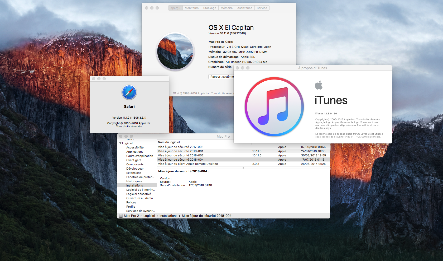

Hello,
You can update iTunes 12.8.0
As well as Safari 11.1.2 (11605.3.8.1)
Personally I installed "SecUpd2018-004ElCapitan" and to avoid the boot loop I created an automatic tool that replaces the new kernel with the one of "SecUpd2017-005" (Kernel replacement operations explained by "Larsvonhier" and "kaosnews" (page 170 post #4237):
Fix SecUpdate ElCapitan Mac Pro 1.1-2.1 Start Loop.dmg
To use my tool you no longer need to have a clone of your ElCapitan system disk, for my part I launched my installation package from a External SSD with Lion 10.7.5 and everything worked very well ...
After 2 months EVERYTHING IS STILL STABLE
