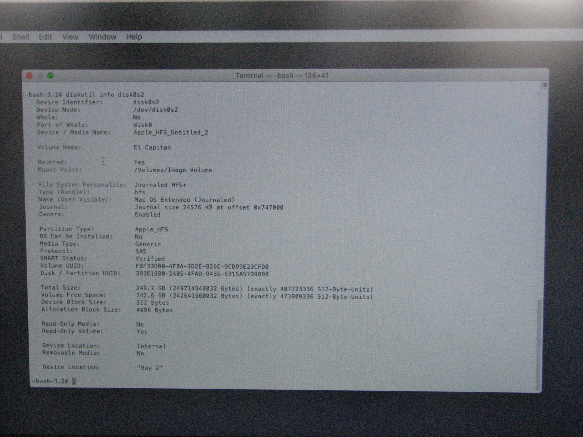

I have an xserve 1,1, and I have used pikify's installer for El Capitan , but I get the error that it has already been installed. I went into terminal and used the diskutil info for the disk I am installing on. Can anyone help me with this?
your screenshot seems to indicate that you’ve booted from the installer device or perhaps you don’t have the disk formatted with the GPT partition scheme.
It’s showing disk0 located in bay 2
BUT
it’s also showing “OS can be installed” = no
In my experience that usually means disk0 is not formatted correctly.
Try to launch the Disk Utility app and check the partition type. The OS typically needs the GUID partition type. If it’s not GPT, you’ll need to reformat the whole drive selecting GUID partition map for scheme and Mac OS Extended (Journaled) for the volume format.
From the size/used values it looks like there’s no existing data on the drive (if there is make sure you have a backup of the data before reformatting).
Then try again...
