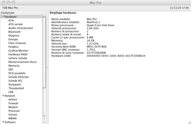

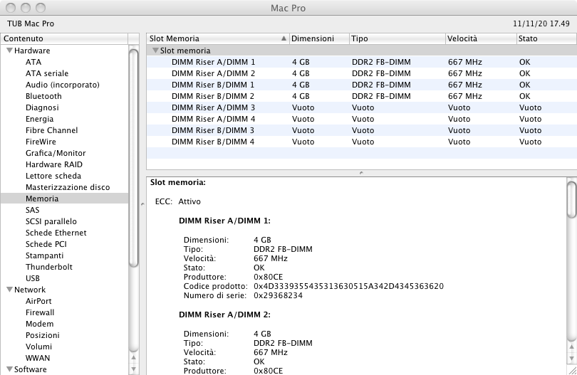

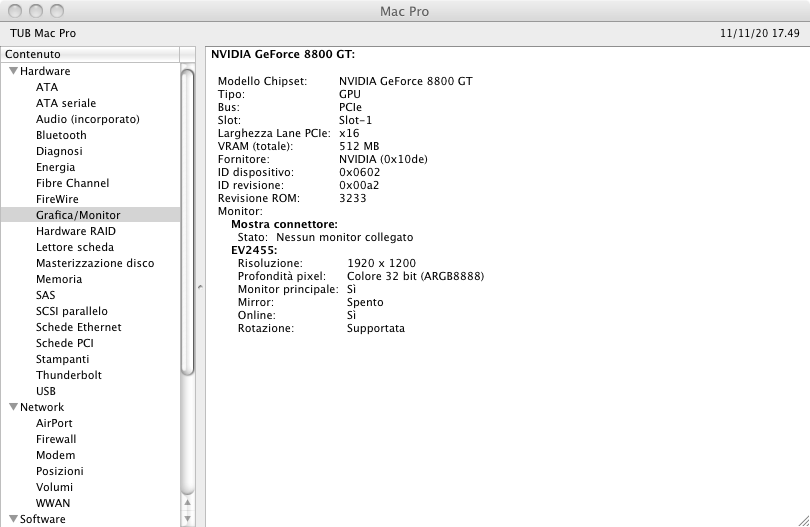

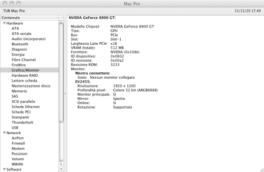

Hi All!
I've a problem with a Mac Pro 2.1 installing El Capitain.
USB completely stops working at the 10.11 language selection, both front and back ports. Thus making it impossible to use mouse and keyboard. Both with preconfigured image at post #4,993 and with a pikifi drive (starting from a original 10.11 image from apple site).
Mac Pro 2.1 (with 2007 firmware)
16GB RAM
nVidia GT8800 512MB
Crucial MX500 500GB + HGST 1TB SATA drive
... work perfectly with 10.6.8 Snow Leopard
PRAM reset don't solves the problem.
Thanks in advance.
V

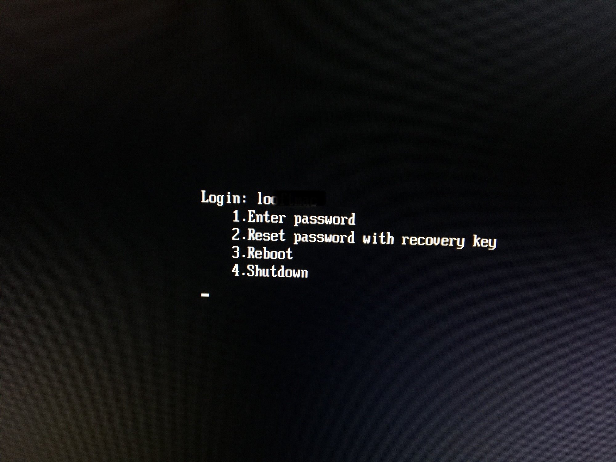

After a long time of not really using my upgraded MacPro1,1 running ElCaptipan I have identified a new use case. Since it is dealing with sensitive data I decided to activate FileVault and to my surprise the initial login-in screen is now "terminal style" just showing "login:". I can enter my username and then a itemized menu shows, offering to (1) enter the password, (2) reset password with recovery key, (3) restart and (4) shutdown (see attached picture). It basically does the job, but I have a keyboard with German layout attached and at this "login shell" defaults to the US layout, making entering special characters a challenge.
The boot drive (/dev/disk0) is an M-SATA SSD formatted as HFS+ and has an EFI and a Recovery partition.
On my other systems with APFS SSD there is also a pre-boot partition and the login screen showing for encrypted boot disks looks identical to the normal login screen although I think it stems from the pre-boot partition.
Here is the output of diskutil list (just overwrote the UUID of the encrypted partition with X):
/dev/disk0 (internal, physical): #: TYPE NAME SIZE IDENTIFIER 0: GUID_partition_scheme *512.1 GB disk0 1: EFI EFI 209.7 MB disk0s1 2: Apple_CoreStorage System (EC) 511.1 GB disk0s2 3: Apple_Boot Recovery HD 650.0 MB disk0s3 /dev/disk1 (internal, physical): #: TYPE NAME SIZE IDENTIFIER 0: GUID_partition_scheme *200.0 GB disk1 1: EFI EFI 209.7 MB disk1s1 2: Apple_HFS El Capitan 160.4 GB disk1s2 3: Apple_Boot Recovery HD 650.0 MB disk1s3 4: Microsoft Basic Data MSDOS 22.8 GB disk1s4 5: Apple_HFS Install OS X El Capitan 15.8 GB disk1s5 /dev/disk2 (internal, physical): #: TYPE NAME SIZE IDENTIFIER 0: GUID_partition_scheme *1.0 TB disk2 1: EFI EFI 209.7 MB disk2s1 2: Apple_HFS Users 999.9 GB disk2s2 /dev/disk3 (internal, physical): #: TYPE NAME SIZE IDENTIFIER 0: GUID_partition_scheme *1.0 TB disk3 1: EFI EFI 209.7 MB disk3s1 2: Apple_HFS Video Edit 999.9 GB disk3s2 /dev/disk4 (internal, virtual): #: TYPE NAME SIZE IDENTIFIER 0: Apple_HFS System (EC) +510.7 GB disk4 Logical Volume on disk0s2 XXXXXXXX-XXXX-XXXX-XXXX-XXXXXXXXXXXX Unlocked Encrypted
I have installed 10.11.6 (15G22010) using rthpjm´s pikify script with a reverted kernel of 2017-005 security update (thanks to @rthpjm) and everything is working including the boot into the recovery partition.
Now the question: Is this minimalistic log-in shell for encrypted boot drives normal or am I missing something in settings or partition wise ? It would be nice if the German layout would be supported during login like it is when booting from an unencrypted drive. I have search around and could´t really find anything useful - Apple´s user documentation does not include any technical details and I immediately get lost in the developers documentation library :(

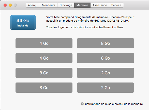

I have one question about the ram. I have the 2,1. Can the slots only take 4GB?
I saw someone on eBay selling 32GB 4 x 8GB.
Cheers.
My guess is your 2,1 is 'better' than my 1,1.
I bought a few used 8 Go modules on eBay and they worked fine for a few months, although they are now more 'flexible' (see picture below).
The slots showing 4 Go are actually filled with 8 Go modules, half of that memory not mounting properly, obviously.
Which is to say: a MP 2,1 is capable of dealing with 8 Go modules. Then it's only a matter of how old and how efficient those modules are.
