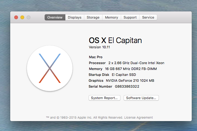

I have just installed El Capitan on my Mac Pro 1,1! Thank you all very much.
The only problem I ran into was that after I started the install, it booted into my windows 10 boot camp partition, where I then used Mac drive to replace the boot.efi files again and then restarted in OSX to continue installation and voila! Success!
