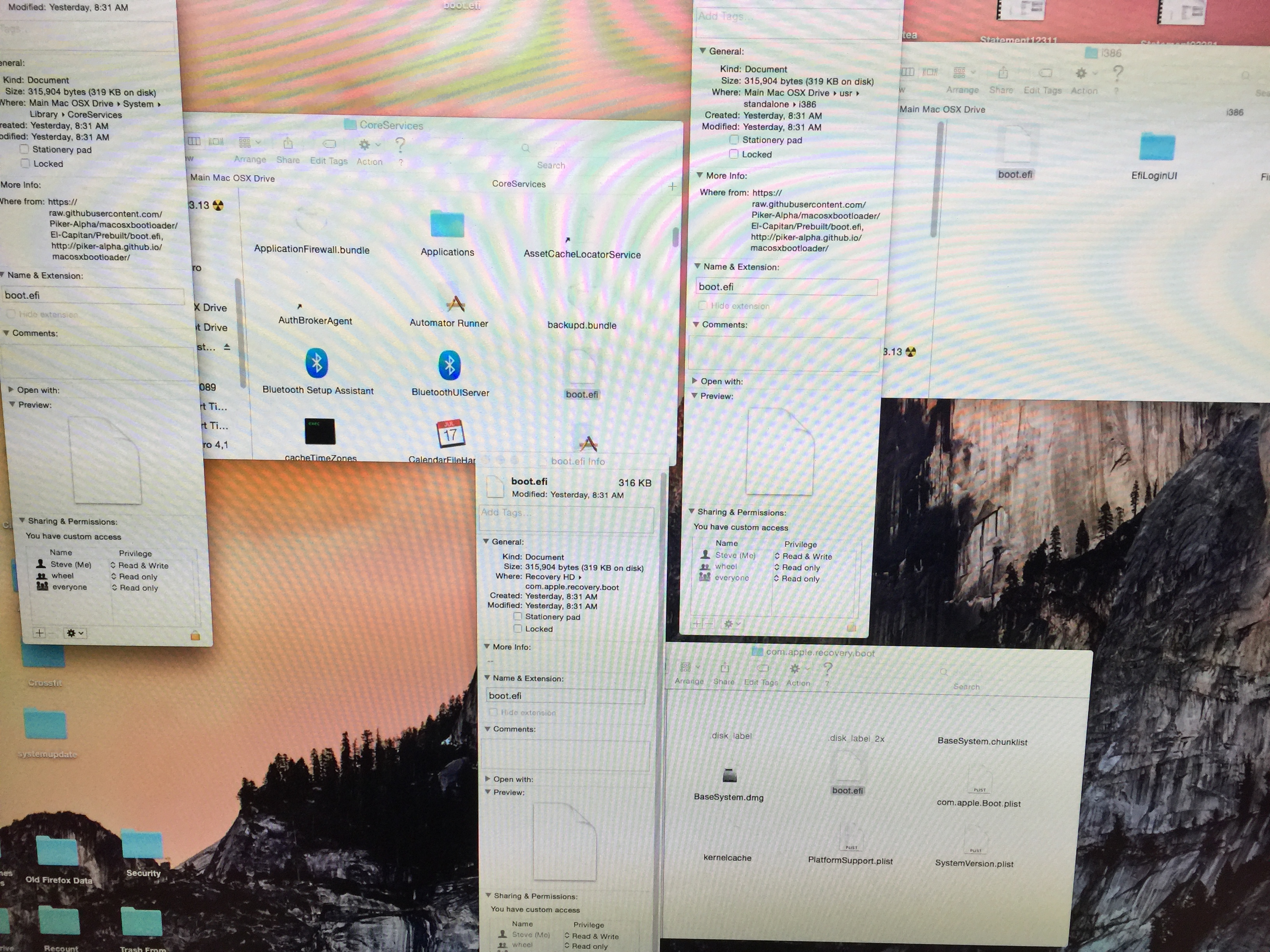

Thank you for you response. I was able to replace boot.efi in all three locations. Thank you, and also to OGNerd. I have enclosed photos of my screen showing the three locations with the correct boot.efi I restarted the computer just after these photos were taken, and the OSX utilities screen came up. When I chose Reinstall OSX, it went to the Yosemite installer. I have the El Capitan installer in my Applications folder also. I went to Disk Utility and repaired Permissions. It continues to reboot into the OS X Utlities screen. I have a Carbon Copy Cloner copy on another drive, so I was able to reboot into Yosemite on that drive. Any suggestions? image.jpeg image.jpeg

OGNerd, Sorry for the confusion. I am a doctor, and I can talk all day in a language many would not understand, so please understand that I do not yet understand some of what is said in this chat. But I am working to understand, and I admire those of you who speak Mac Pro. I have been following this thread for weeks now, but I waited until this past weekend to attempt an upgrade, when Pike posted his "final" version of the boot.efi. What I have done so far is this:
1) There is a Mac Pro 4,1 at my office. I used this machine and DiskMaker to create a bootable OS X El Capitan USB installer. I tested it on that machine and it worked. I then used this USB installer to install OS X El Capitan into my Applications folder and onto my desktop.
2) I used the Macrosxbootloader by Pike R Alpha to download the latest version of boot.efi onto my desktop.
3) I replaced the boot.efi in my computer in the CoreServices, i386 and Recovery files. I was having a problem previously unlocking and replacing the boot.efi in the Recovery disk, thus a previous post, but I was able to resolve that thanks to all of your help. My last post shows a picture of all three locations with the correct boot.efi file in place, just in case there was a question.
4) I then used the OS X El Capitan installer that was on my desktop to attempt to download El Capitan onto my computer. When the computer rebooted, it was into the OS X Disk Utilities screen. I tried to Reinstall OS X from that screen, but it chose Yosemite rather than El Capitan. A second reboot resulted in the same situation.
5) I used a second drive on my computer with Carbon Copy Cloner to boot back into Yosemite.
6) That is where I am currently stuck.

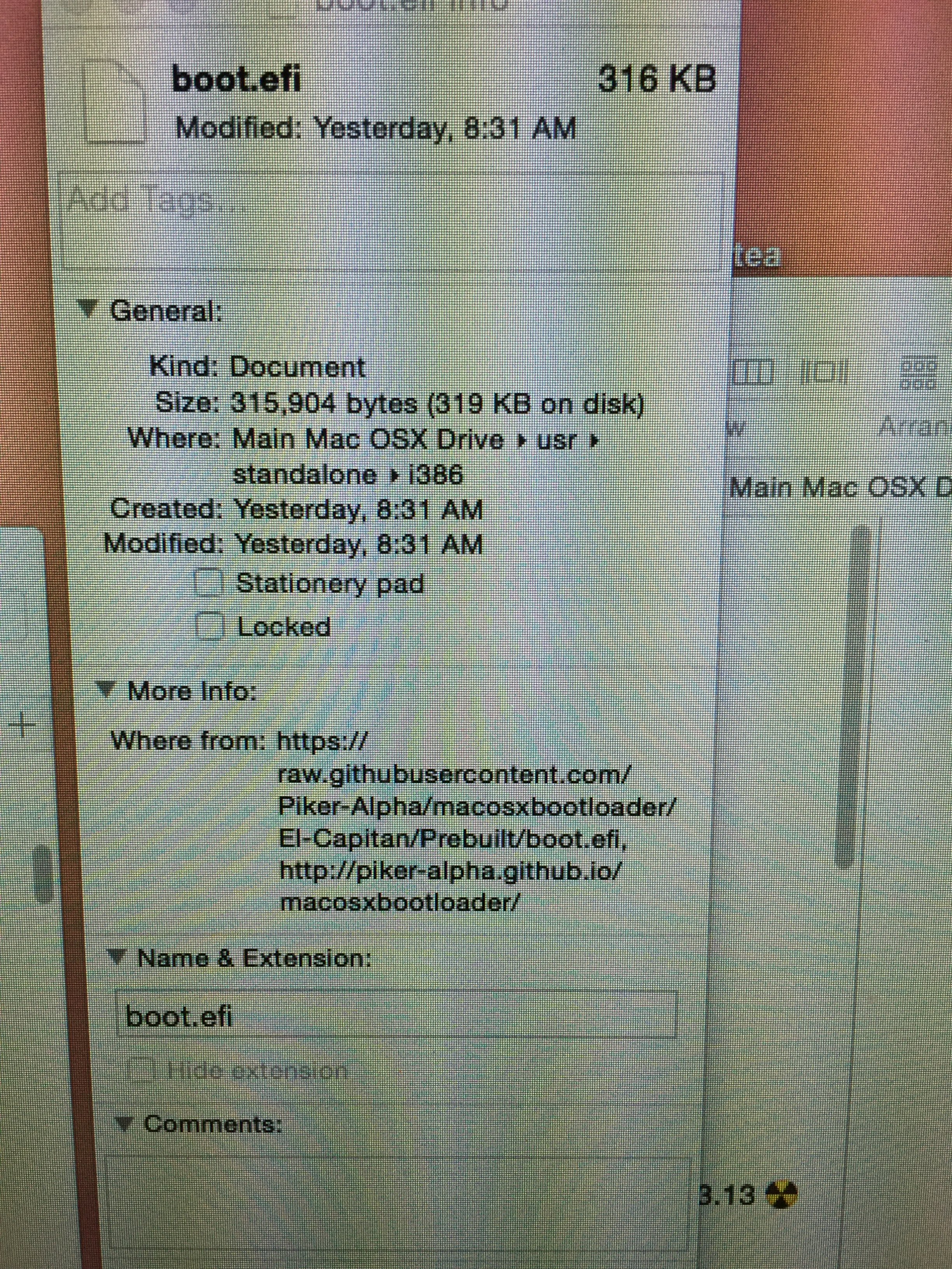

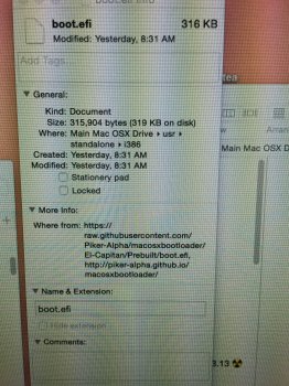

Thank you so much for your reply - I am honored. I did not find a /.IABootFiles folder. I did find a /OSX Install Data folder. I removed that. I re-installed the current 316 KB boot.efi in the three locations just to be sure. I then used the OS X El Capitan USB installer I created on a Mac Pro 4,1 machine. I received a screen that said "This version of OS X 10.11 cannot be installed on this computer."
Note: The boot.efi file that I download from the Macrosxbootloader site is 316 KB. After I restart the computer, or attempt to install OS X El Capitan, the boot.efi folder that is now in the three locations has changed to 313 KB.

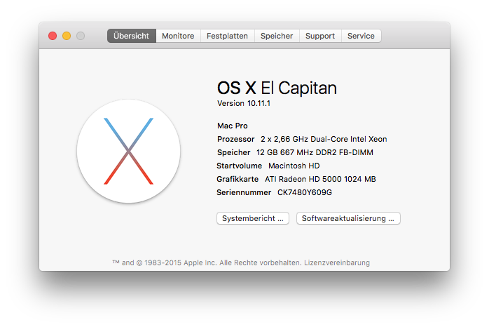

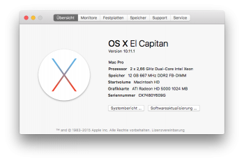

10.11.1 no Problem just replace the Efi's
updated to 10.11.1 no problems, it rebooted to the recovery drive. Replaced boot.fi's and booted just fine.
