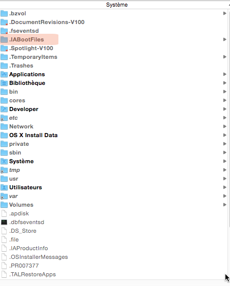

You may run into this if you forget to replace /.IABootFiles/boot.efi with the v3.0 copy of boot.efi from the download page.
I've done the following steps :
1) I've downloaded and checked with md5 and sha1 a new copy of boot.efi
2) I've put it in /usr/standalone/i386/, /System/Library/CoreServices, /.IABootFiles replacing the one in place.
3) I've cleaned my system (repair permissions, cleaning caches, dylib, ...) with Onyx and done a reboot.
4) I've synced my System partition with my clone
5) I've downloaded and launched the El Capitan installer with the MAS
When the installer reboot my Mac, it fails to start in the installer. I have to boot on my clone to be able to reboot on my system partition.
Before the reboot (step 5) you need to replace /.IABootFiles/boot.efi with mine or it cannot boot (the 64-bit boot.efi is copied to this location). Check the md5/sha1 checksum and you'll quickly realise that the file isn't the one you need there.
Note: I have an yet to be released launch daemon for this procedure.

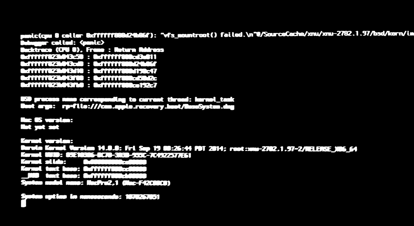

Is there a log file showing what is happening when boot fails ?

Apple said to block bless for the boot drive, so how did you do it? Perhaps bless did fail.
And the the installation process of El Capitan completed correctly? Can you boot El Capitan on the other Mac? I mean how can you boot into 10.6.8 if you upgraded to El Capitan on it? That almost sounds like El Capitan wasn't installed properly. Also see my other post.

Boot in verbose mode to see where it stops.

If I remove the 10.6.8 disk, leaving only the El Capitan disk, at the startup I have a folder with a question mark.
Ok. You have the correct copies of boot.efi in place. Please try our latest nightly of boot.efi and see if that helps.

Hello everyone:
I can't find any .IABootFiles folder, even from a terminal with all hidden files shown.
Here is a screenshot of my system folder with the .IABootFiles shown :
$ pwd
/Volumes/Système
$ ls -alh
total 125
drwxrwxrwx 43 Laurent staff 1.5K Oct 18 20:01 .
drwxrwxrwx 43 Laurent staff 1.5K Oct 18 20:01 ..
-rw-rw-r--@ 1 root admin 10K Oct 18 20:01 .DS_Store
d--x--x--x 8 root wheel 272B Oct 18 19:59 .DocumentRevisions-V100
drwx------ 8 Laurent staff 272B Oct 18 16:40 .IABootFiles
-rw-r--r-- 1 root staff 305B Oct 18 16:47 .IAProductInfo
-rw-r--r-- 1 root staff 3.9K Oct 18 16:47 .OSInstallerMessages
-rw-rw-r-- 1 root admin 183B Jan 29 2012 .PR007377
drwx------ 5 root wheel 170B Dec 20 2014 .Spotlight-V100
-rw-r--r-- 1 root staff 1.3K Oct 18 16:45 .TALRestoreApps
drwxrwxrwt@ 3 root wheel 102B Feb 12 2015 .TemporaryItems
F1Mac
macrumors 65816
Feb 26, 2014
1,284
1,604
$ pwd
/Volumes/Système
$ ls -alh
total 125
I had the same problem as michmcca, LaurentR2D2 and others: No .IABootFiles folder on my system (Yosemite 10.10.5 on a Mac Pro 2,1). I tried to create the folder and put the new boot.efi in it, and then run the installer with the new boot.efi placed in the three other locations, but that failed when the installer rebooted. The following error message only displayed for a second or so, so excuse the potato quality.
I don't have any problem with .IABootFiles folder. My screenshots were meant to help you find it on your hardware :)
