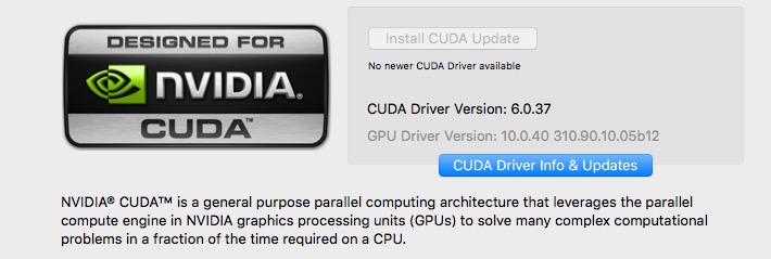

nick85
macrumors newbie
Nov 27, 2011
28
strange mail behaviour in el capitan
everything else working nice on mac pro 2.1, 8 core, 13 gb RAM
perhaps an graphic card / driver issue with the nvidia 8800 gt mac edition ?
