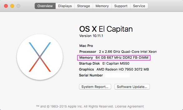

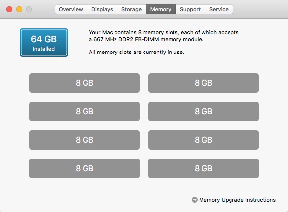

Thanks to many good people at this site and particularly in this marvelous thread, I have upgraded my 2006 Mac Pro that I have had for 9 years so that it could run Yosemite then El Capitan.
Today, I am happy to report that this remarkable MacPro1,1 (flushed to 2,1) recognizes 64GB (8 x 8GB) or memory:
Hey guys I had been running el cap since day 1 . Boots up ok , but am having problems with some applications not launching, one of them is safari, notes , avg, calendar , any ideas what's going on?
Can I ask where you bought those DIMMs and how much you paid for them?
On eBay, here are the DIMM's I purchased for $199.
Caution:
The type of DIMM that works in 2006 Mac Pro is PC2-5300F 2Rx4 FB-DIMM ECC.
(1) The F after 5300 (or FB in FB-DIMM) means that the module is Fully Buffered.
(2) DO NOT get PC2-5300P DIMM’s. These parity modules are incompatible with MacPro1,1; both physically and electrically.
On eBay, use a search string like "64GB (8x8GB) PC2-5300F FB-DIMM”. I just did, and $176 is the lowest price at which you can get 64GB right at this moment.
Here are the search results.
