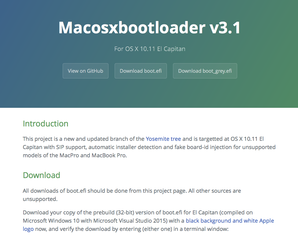

Question .... for a MAC PRO 1.1 and EL CAPITAN 10.11.1, what version of new (3.1) Pikes Boot.efi is the best ? Or are both the same, just Black or Grey background ?

What version of BOOT.EFI did you use ?. (2.0, 3.0, or the last one 3.1)
As far as I know, there's no way to tell it looking at the file: I guess it's 3.1, I downloaded it Sunday night from the webpage you linked.

What version of BOOT.EFI did you use ?. (2.0, 3.0, or the last one 3.1) And what version of EL CAPITAN did you install ? 10.11.1 or just 10.11 ?
And FaceTime works ok ?
Thanks.
I used 3.1 on 10.11, then successfully upgraded to 10.11.1
