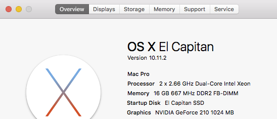

No problem to update to 10.11.2 with CapitanPikeFix. After the upgrade, reboot, wait for 5 minutes, shut down the computer, restart and everything is perfect!

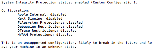

Whats the meaning of this (In terminal I wrote this: csrutil status)
System Integrity Protection status: enabled (Custom Configuration).
Configuration:
Apple Internal: disabled
Kext Signing: disabled
Filesystem Protections: disabled
Debugging Restrictions: disabled
DTrace Restrictions: disabled
NVRAM Protections: disabled
This is an unsupported configuration, likely to break in the future and leave your machine in an unknown state.

It means that you have disabled all user mode aspects of SIP, effectively rendering the machine to Yosemite level system security.

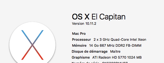

Success here too, I manually swapped out the 2 .efi files and all is good !
I installed 10.11.2 from another Capitan-Mac to the MacPro 1,1 SSD, swapped the files
show all files,
(in CoreServices I first deleted the boot.efi with Terminal:
sudo rm -r <space> drag and drop old boot.efi to Terminal window,
Password, confirm what you are doing)
then copied PikerAlphas boot.efi to System/Library/CoreServices and usr/standalone/i386
Repairing with KextUtility -
-ready...
