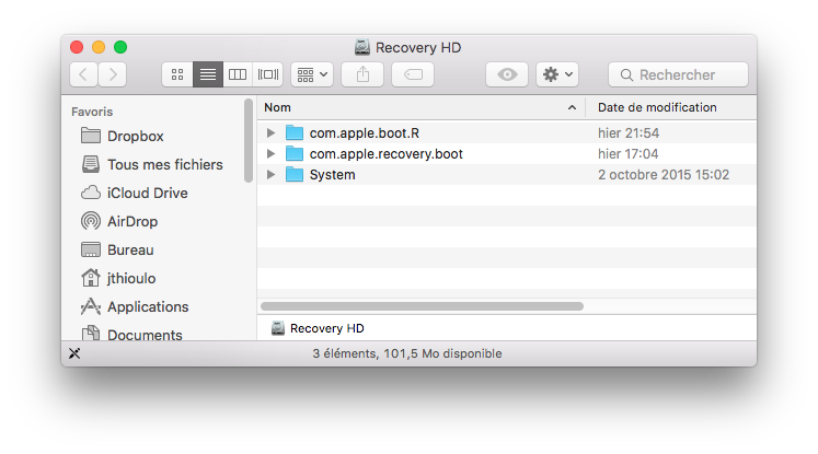

I did not show hidden files on that volume, and only saw the first one you listed (./com.apple.recovery.boot/boot.efi).There are two boot.efi files in the Recovery partition:
./System/Library/CoreServices/boot.efi
Do we need to replace both ?
Thanks
Jean

I didn't see one either, I assumed it was possibly a hidden System folder, but it looks like the ./com.apple.recovery.boot/boot.efi is the only by your screenshot.

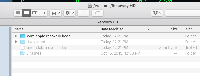

.Trashes
.fseventsd
.metadata_never_index
