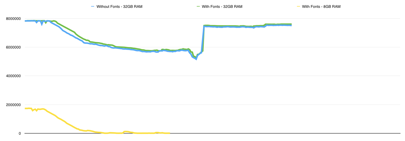

Here is a graph of free memory. The three lines represent 3 installation runs, the top 2 lines represent 2 different versions of pikify3.1 run with 32GB RAM installed, the third line represents a failed install when the machine had 8GB RAM installed.
Hopefully the picture says it all. As the installation proceeds, the available RAM decreases. Not a problem at 32GBs installed, but causes the 8GB run to fail early because available RAM space dropped to zero.
