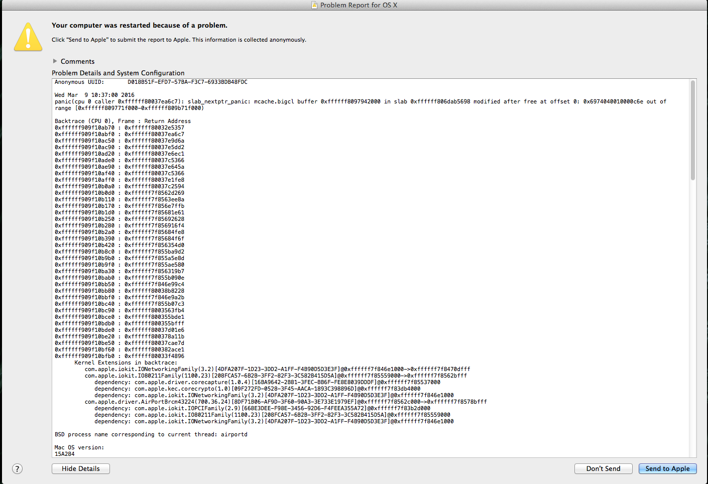

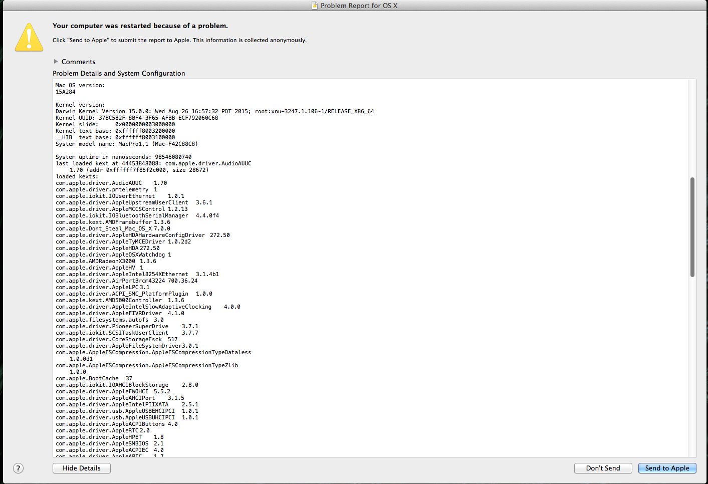

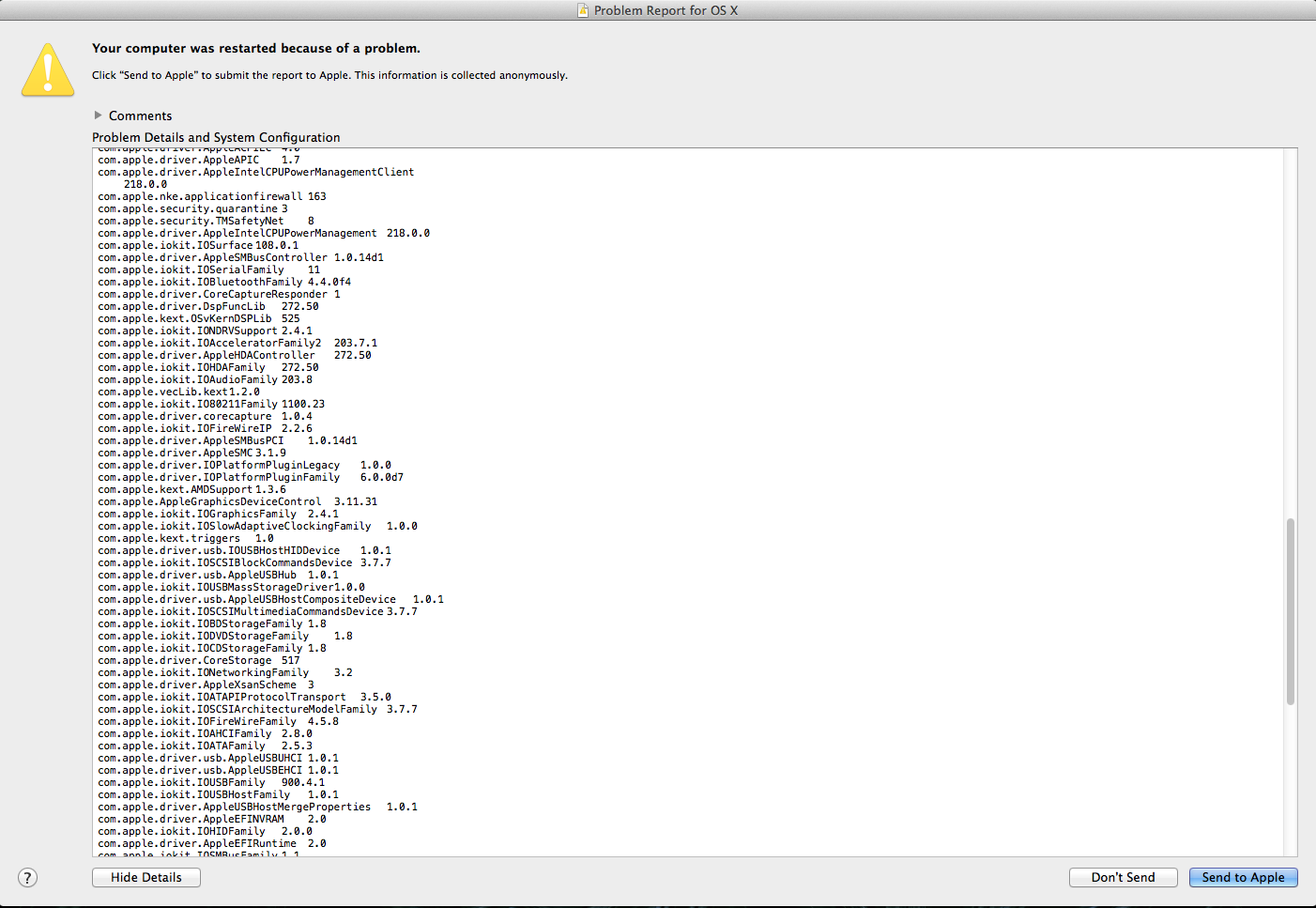

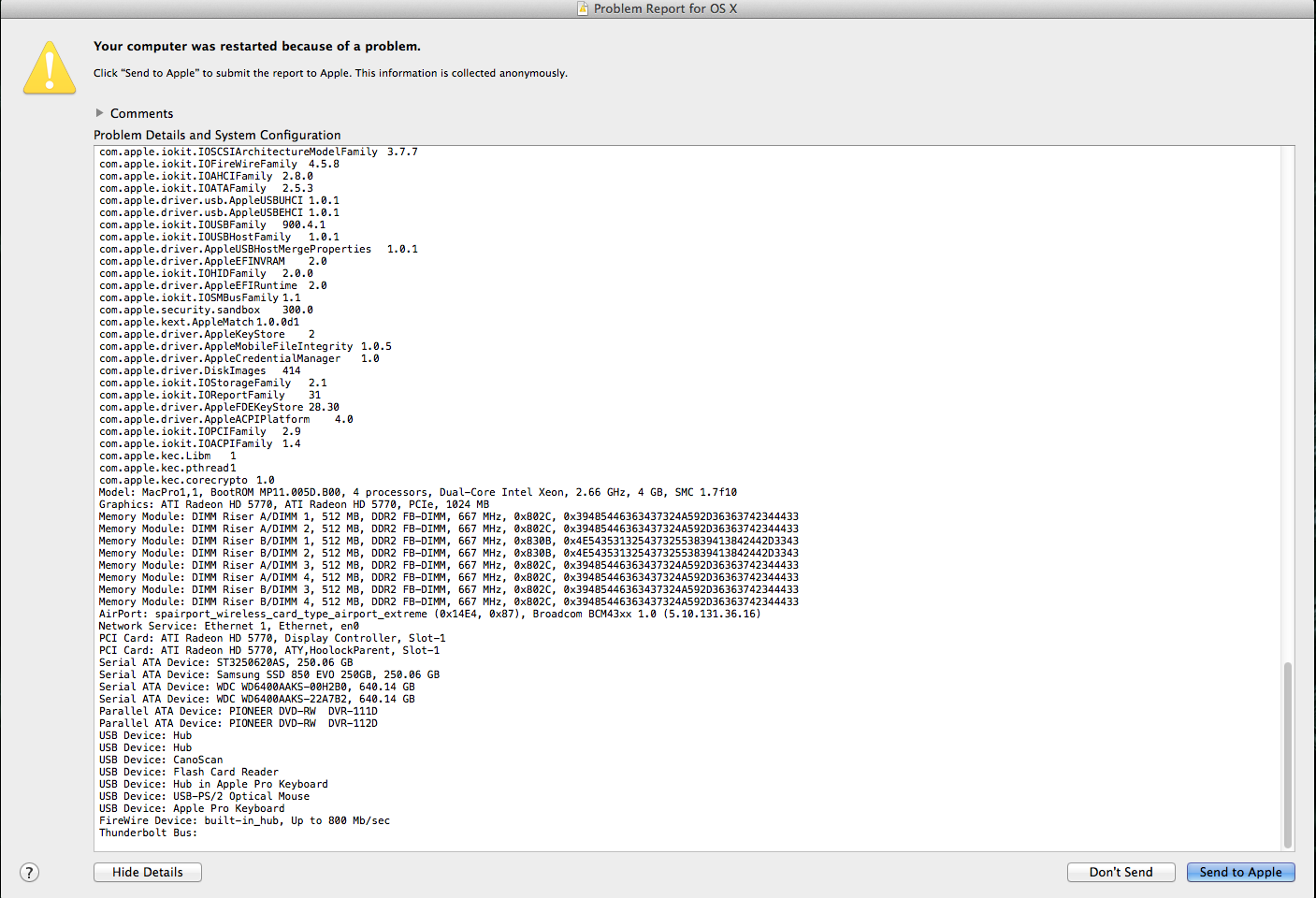

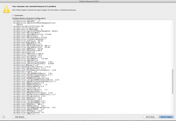

Tried again to use 10.11 one my mac pro 1.1 without success. It keeps rebooting on me... I have 8 x 512 mb ram. Would that be the problem ? It boots fine but after a little while it keeps shutting down..:(
Same here. I tried to remove my 2 512 MB RAM and only Start with 2x2GB RAM. But de behaviore is the sam. It Starts an After a while it reboot.
With 10.11.1 i didn't have this Problem. But to set back to 10.11.1 I ned the 10.11.0 installer, which i can't find anywhere. Only the 10.11.1 Update.

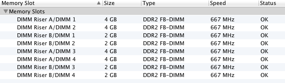

I replaced the 512MB modules with 4GB modules, bringing my total memory to 24GB.
Now when I try to boot, I see a kernel panic as before--some codes are different, but I didn't pay close enough attention to know if this changes for every crash.

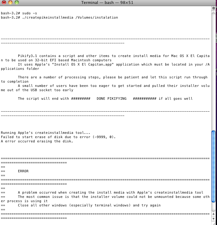

Got this error (pic link attached)
I think there is something to do with dismounting and mouting the partition
It said something about not been able to erase either
I have created a guid mac partition of 8gb on a ssd
First time it said DONE PIKIFYING but no files were created on my partition.
Yes i have the instalation file on my application folder
Thank you for your help
Hello ufopeace,
Please try this again, but this time make sure nothing is "using" your SSD partition. That includes you Terminal session(s). Before you escalate your account to the root user (the sudo command) make sure you have changed directory to the location of the Pikify folder, then issue the sudo command and begin the process.
If it still complains, then there must be some other process "using" the SSD partition. Try using the following command

It appears that MacPro1,1 and 2,1 need a lot of memory to achieve a successful install by this method. Others have kindly tested with varying configurations of RAM. See the later posts in the developers thread and my post at #855
A minimum of 12GB seems to be required...
============ end edit ====================

Pre-requisites:
  • As per Peter's guide, you will need a volume that can be overwritten by the installer
    • This could be a USB memory stick
    • A small disk partition from one of your hard drives (not the disk that you intend to use for El Capitan)
      • You need to be able to boot from this volume
  • The installer volume needs to be at least 8GB
  • Your copy of 'Install OS X El Capitan.app' should be located in your /Applications folder
  • The pikify3.1 folder contains both the black and grey variants of the boot.efi file. When unzipped the boot.efi file is the grey one, if you want to change to the black background variant, simply copy the black one over the boot.efi before you start. e.g.
    Code:
    cp -f boot_black_3_1.efi boot.efi
Usage:
  • Open a terminal window
  • Change directory to the pikify3.1 folder from the zip file. Let us assume that you downloaded the zip file to your Downloads folder and unzipped it there. (If you have put the pikify3.1 folder somewhere else, please alter the path to suit your location)
  • Change [InstallerVolumeName] to the name of the USB memory stick or your small disk partition. For example if you are using a USB memory stick and it shows on the desktop with the name Untitled, then replace [InstallerVolumeName] with Untitled so that the path reads /Volumes/Untitled
Code:
cd ~/Downloads/pikify3.1
  • You need to run the script as the root user
Code:
sudo -s
[your password]
./createpikeinstallmedia /Volumes/[InstallerVolumeName]
  • OR
Code:
sudo ./createpikeinstallmedia /Volumes/[InstallerVolumeName]
[your password]
  • OR (optionally switch to the black background variant before you start)
Code:
sudo -s
[your password]
Be patient, the script will take some time to run through to completion, especially if your installer volume is a USB memory stick!
Once the script competes it will print ### DONE PIKIFYING ### and you should have an installer volume named 'Install OS X El Capitan'

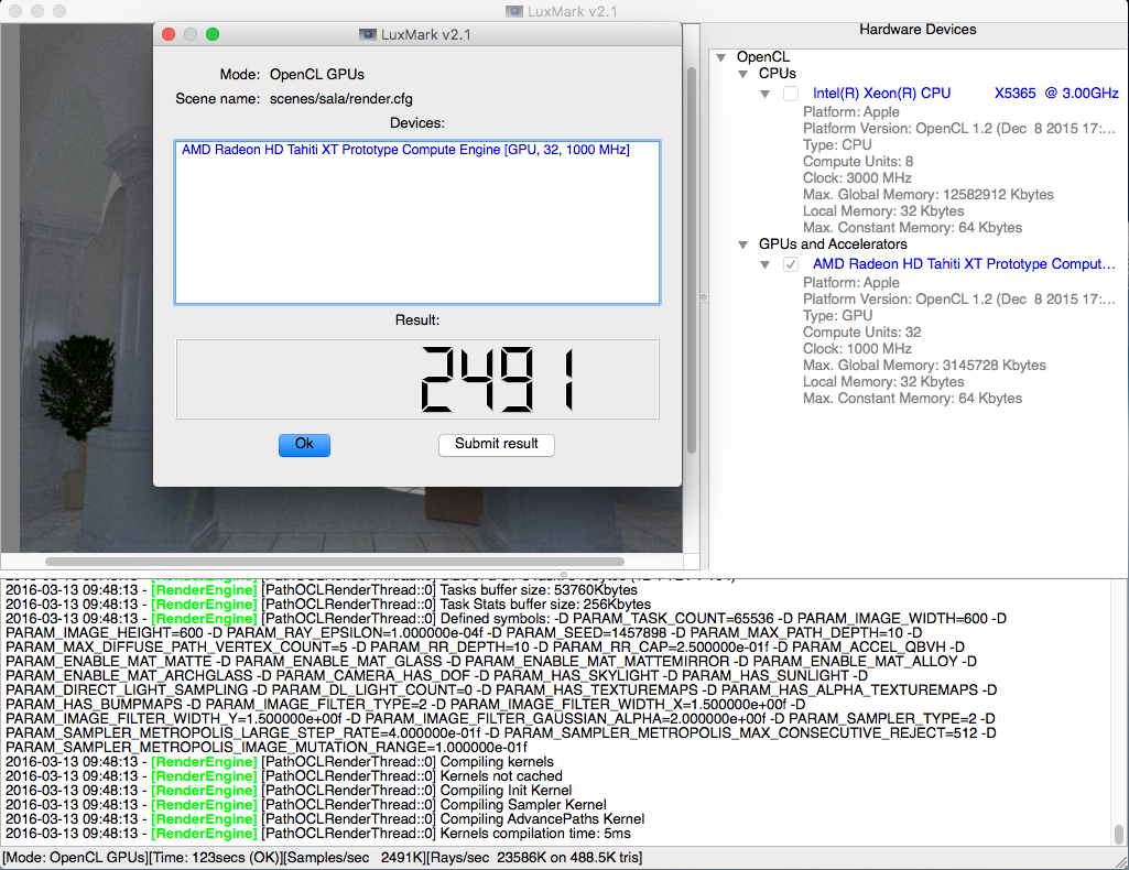

Thank you for sharing this with the rest of us. Your instructions and attachments made it super easy to install ;-) I am surprised at how well the Mac Pro 1.1 runs with El Capitan. It actually runs a lot better with El Capitan. I am not sure what kind of magic sauce they have with El Capitan, but my Bruce X time went from around 35-40 seconds on Yosemite to a consistent 20 seconds on El Capitan. The other score that improved by a pretty good margin was LuxMark 2.1. The score with LuxMark 2.1 running Yosemite was normally around 1700, and now with El Capitan installed the score jumped to 2500.
My Mac Pro 1.1 runs really well with El Capitan. I really notice the difference when using Final Cut ProX. Installing El Capitan along with the AMD 280X, SSD drive and USB3.0 card definitely extends the life of this oldy but goody for another couple years. Thanks again to the Mac Rumors community and all of those involved in making this possible for the Mac Pro 1.1.
On a side note it is really sad that Apple no longer makes awesome machines like this any more. I have waited a long time for Apple to release a refresh but realized it was in vain. Unfortunately had to move on so decided to build a hackintosh. I would have really preferred to buy another Mac Pro with out all the hassles that go along with a hackintosh, but oh well at least I have a machine that runs OSX and Windows 10.
