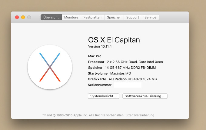

[doublepost=1458679230][/doublepost]OS X 10.11.4 is up and running on my machine! CapitanPikeFix lost the battle against Apple :( ! The reboot whilst install ended with the grey screen and the ?-folder. So I started the MP in target-mode and connected with my MBP (currently on 10.11.3). I swapped the boot.efis with those from the pikify-folder and rebooted. Install went on normally, it took about 5min until my MP was "alive" again. I couldn't resist and rebooted, that worked fine! Now I will have a look and discover the new features of 10.11.4
