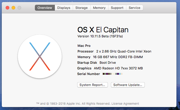

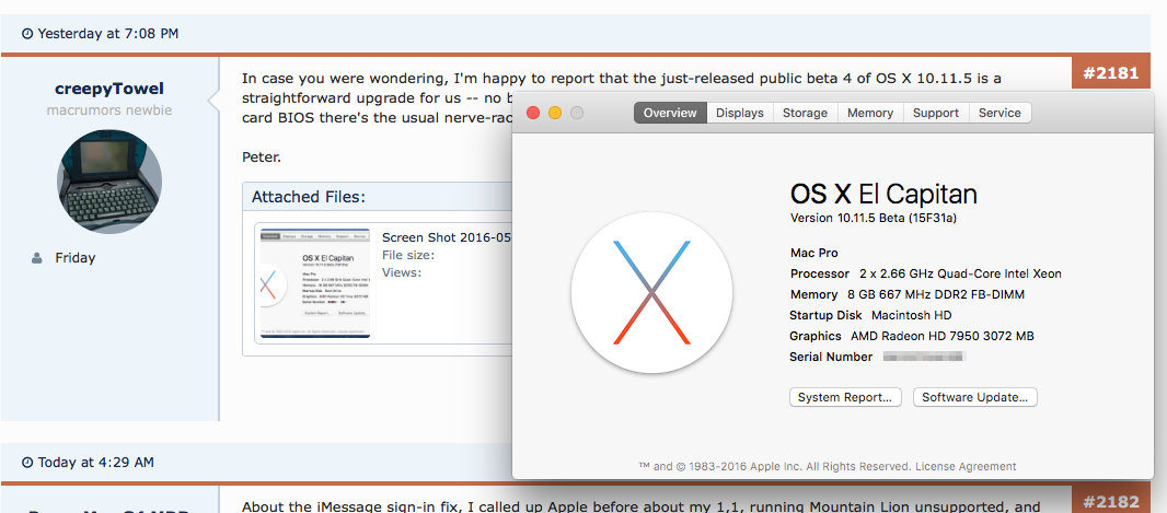

In case you were wondering, I'm happy to report that the just-released public beta 4 of OS X 10.11.5 is a straightforward upgrade for us -- no boot.efi replacement, no re-enabling SIP. If you don't have an EFI graphics card BIOS there's the usual nerve-racking wait for something to appear on screen, but don't worry -- it will.
Peter.
Reactions: owbp
Even if you have EFI GPU there is still a few seconds of white screen between apple logo and login screen - longest seconds in ones life :D
P.S. Feeling good logging into Feedback Assistant on MP1,1 that runs OS X 10.11 better than friends few years old MBP and Mac Mini...:apple:
