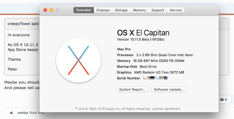

OK, I just did. Smoothest update ever. It hasn't touched the modified boot.efi files. It hasn't even re-enabled SIP:
So I'd say that's a result!
Peter.
Reactions: owbp and mmonse_de
