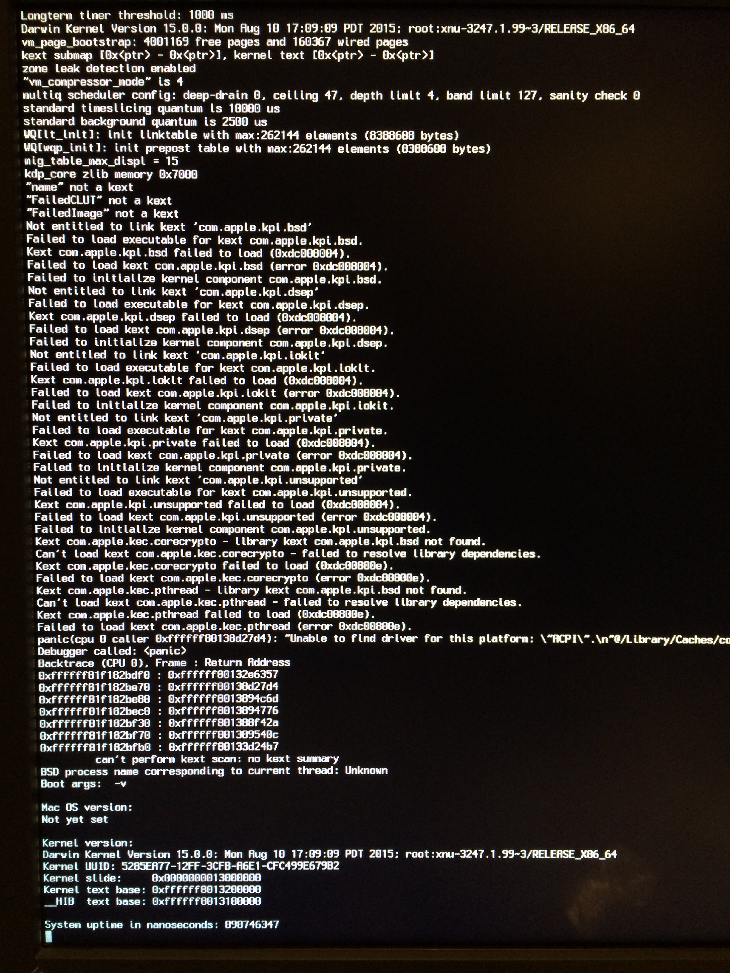

I have built a USB installer stick like I did many times before. I used the latest DP7 full installer and the newest boot.efi file. unfortunately I got a kernel panic.

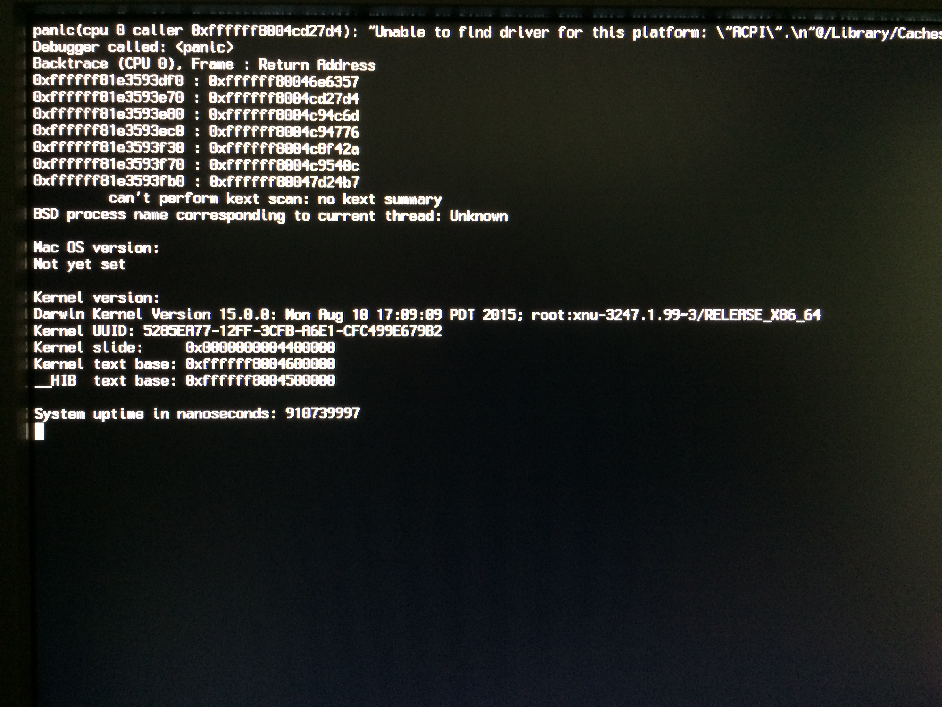

so far, no success. I was not able to start from the Recovery HD or the USB installer. I tried with both new versions of the boot.efi file.

findings so far: BaseSystem.dmg which needs to be restored to a thumbdrive in order to create an installer USB stick contains a copy of the boot.efi file! /System/Library/CoreServices/bootbase.efi
I then of course tried it and replaced the bootbase.efi with "our" boot.efi file -> also got a KP. I tried to boot the installer with the boot.efi tailored for OS X Yosemite and got a KP again.

As to the panic you've received, it was to be expected that Pike's Yosemite boot.efi would't fare any better than the still-in-progress El Capitan edition. Two theories:
  1. The current beta of El Capitan is so thorough that it detects that these boot.efi files haven't been developed by Apple and, therefore, the boot process of the El Capitan Recovery HD (not El Capitan by itself, mind you) fails. If this is the case, only Pike or someone like him will be able to solve the situation.
  2. Somehow, your installer isn't "blessed". I suggest that you bless it and see if that makes any difference.
