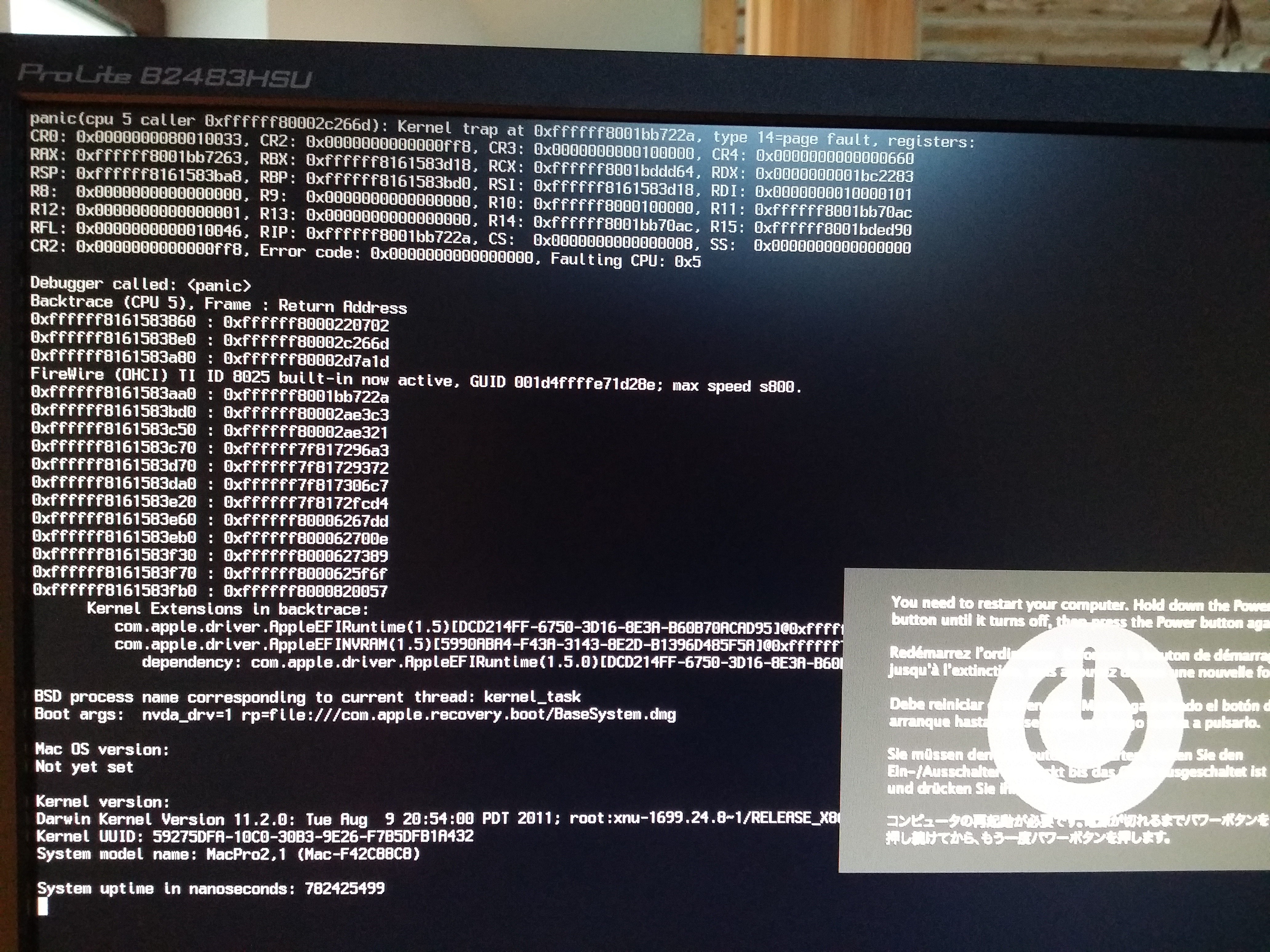

I did, still boots into Recovery with endless "too many corpses being created" errors.
Btw, I know it's Recovery since I edited its boot plist for verbose boot.

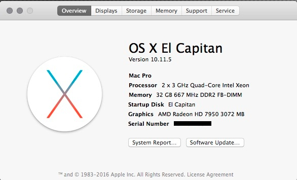

I bought from that wwon guy on ebay.
Went for 32gig.
Crucial were no longer selling this memory last time I looked although they were a few years ago so. I bought mine from Ebay - used - probably pulled from a server. Some was DOA but the seller replaced the faulty modules. If you buy the type with big heat sinks (as recommended by Apple) it may be better than the other type, although some have said it is fine in their Mac. It is fairly cheap so I increased it to 32gb. You may get new old stock or someone may still be making it but I guess it would be more expensive.
