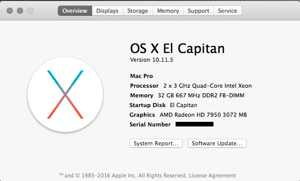

Every Web Driver works with only one system build, 10.11.5 final have different one than 10.11.5 Beta 4, or 10.11.4 Final etc.
So you search it by build version, which you can find here:

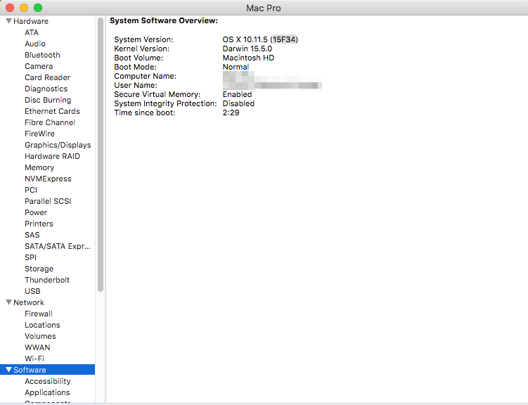

So, it's done. Successfully updated to 10.11.5, no problems. Download from MAS, install, during the reboot there was something funny to be seen on one of my screens, looking like a broken graphic card, but then it said "completing install" with the white apple on black ground and the machine starts 10.11.5 .
I used the "Boot64 v3" script from here to protect the boot.efi files.
Just updated to 11.5 from 11.4 having installed Boot64 and verified it working. Everything seemed fine - only small issue was the Logitech mouse not working and a window suggesting I had plugged in another receiver. Pulled the Unifying dongle thing and reinserted and all seemed OK. Noticed I have 2 mouse icons in the Logitech Unifying Software System Prefs but any change made to one was applied to both - weird. Just restarted and it seems back to normal now.
Thanks again rthpjm for the code to make this work.

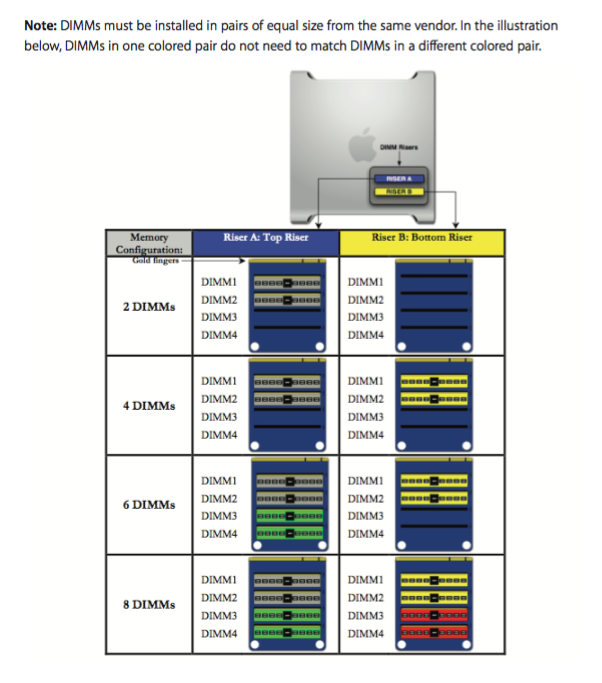

Try putting your 2GB DIMMS in slot 1 and slot 2 (they are currently in slot 3 & 4).
In theory it should not matter what order they are inserted (except that they need to be in same-size pairs). Having your largest DIMMS first might help.
It looks like you may have failing RAM. It's worth removing them and re-inserting them all. This usually improves the mechanical and electrical connections.
Then follow the advice from hwojtek above, remove 1 pair at a time and run for a while until you find a stable configuration.

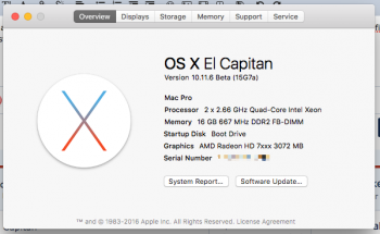

Not that anyone asked :) but you might like to know OS X 10.11.6 beta 1 installs like a dream. No boot.efi replacement, just a smooth install.
Peter.
