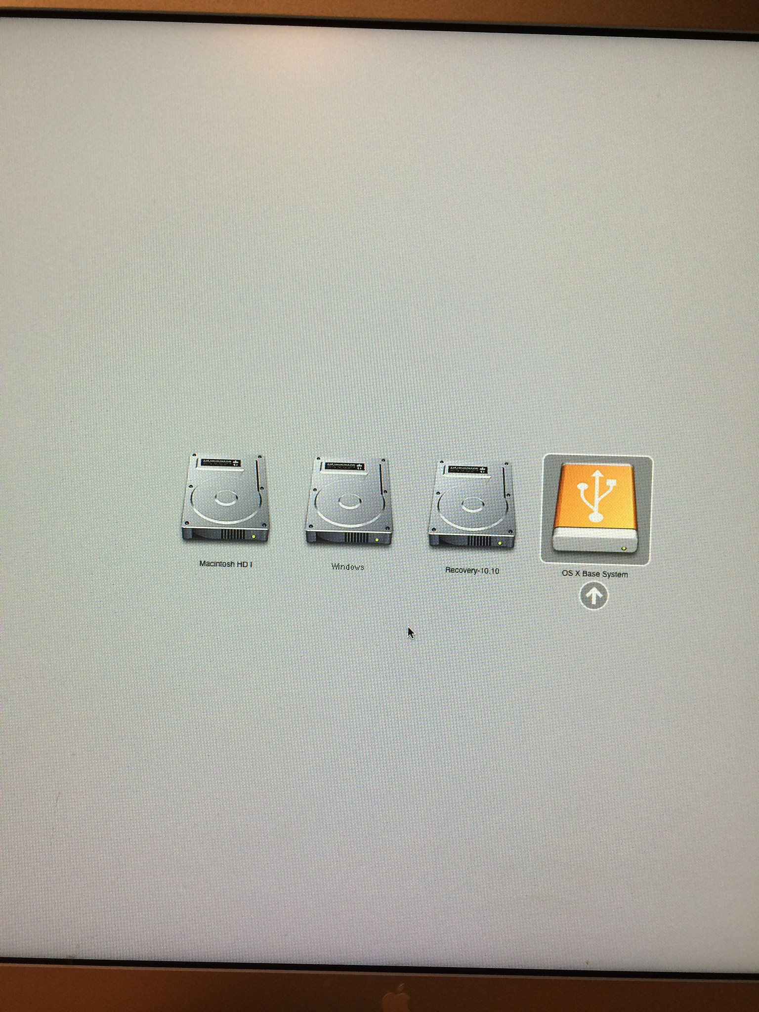

Alright, followed the instructions exactly, created a new bootable USB key. inserted the thumb drive, started the computer up.
i get the OS X Base System populating as an install disk. when i select it, nothing happens. just sits on this screen:

Sounds like a USB drive issue. Another method is to create an 8GB partition on a hdd and use that. It is a lot less finicky.
Thanks for the prompt reply! I'll clone this USB onto a partition on an external firewire HD and see if that fixes it.
