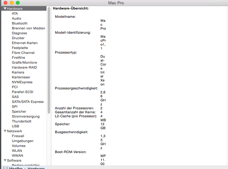

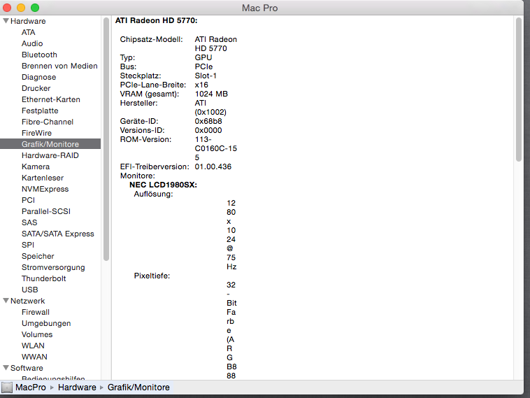

10.10.4 running on MP1.1
One strange issue i Have is with the System Profiler, the text in the categories or totally mixed, scrambled, unreadable
See screenshots

THIS has been happening to me on every single machine I have running Yosemite, whether it be a hack, a real Mac, or with the boot.efi mod. I think it's just bad coding in System Profiler.
I've never had this issue with Yosemite on two hackintoshes, a Mac Pro and two MacBook Pros.
This. I've seen it a few times.
Drag the window corner to make it a bit wider and all will be displayed as it should.
