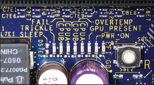

There are new news from my hardware:
I switched the riser boards an tested them solitary. Well the machine crashed once. After installing both riser cards again a red led at DIMM 4 was lightening (here a picture).
This is my 2x2GB RAM pair (i think that these are the Nanya-Rams from this picture: link. Well they have different timings than the other sticks).
I switched the positions of the sticks. No red light anymore, but still hang ups. At the last hang up (the machine was in standby, but sometimes it randomly power ups and freeze) two leds on the logic board was lightening (this picture). Could this really by an issue caused by software? Seems to be faulty hardware to me. At the second hang up the sticks were VERY HOT (all sticks). I could not touch them for more than 2 seconds!
I will remove the 2x2GB pair and will wait what happens.
I never installed a lot of software to my testing OS (like Lion). But I am using Mavericks/Yosemite for daily use.
So whats the point if the machine keeps failing without the suspect sticks?
Could it be a implementation issue in the boot.efi? But I never heard of other MacPros failing with this behavior?
I have to say that the dealer checked the machine, but he could not find any defects. Well, he only had installed a blank OS and he had done apple hardware test. But maybe the issue did just not happened at testing by him...
This machine really drives me crazy -.-
Last but not least two pictures of the riser cards: link1 and link2
ps. Could it be a faulty logic board or CPU (which can not go into the power saving states)?

Those two lit up LEDs on the logic board are for CPU failure.
Okay.
All in all this seems to be a hardware related question (I can not believe that software can cause such crashes)...
Maybe it is related to the RAM sticks. I will test the machine tomorrow (at my time zone it is 3:30 am :eek: ). I could imagine that the different sticks with different timings (and clocks) will not work together (or the 2x2GB sticks are just faulty).
Kind regards
Chris
