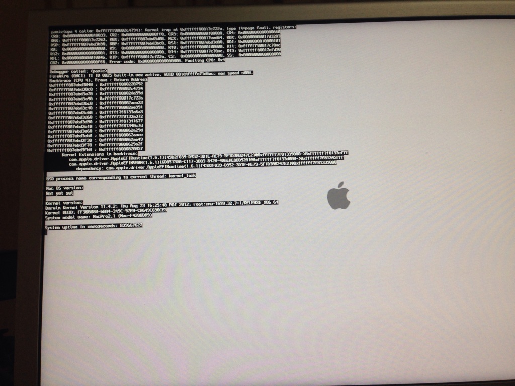

Hello Hennesie2000,
I was able to install Yosemite, but I get this again:
Thanks for the help.
Hello Hennesie2000,
I had reinstalled Yosemite, but now I don´t see the letters just the grey screen with the apple logo and no spinning wheel, I can´t pass that stage. I have a genius wireless mouse that I use¨The USB device to connect the wireless mouse is attached to a USB port on the back of the monitor¨, I also have an internal bluray that I had added some time ago.
I had never ecountered any issue upgrading previous OS versions with these devices on the computer. What might be the isse?.
Thanks.

Hello Hennesie2000,
Thanks.
Lets try to start from the beginning because you have had lots of trouble where others have succeeded. Lets try to narrow it down from the source.
1. Where did you get your "Install OS X Yosemite" app from?
2. Have you tried getting the app from different sources?
3. Have you tried using different media to install it and to install on to?
4. Have you tried installing and booting with nothing but the essentials plugged? Plug your mouse directly into the Mac Pro and unplug the hub in the monitor. Remove all other HDDs.
Hello Hennesie2000,
I had downloaded from kickass.to, many people claims to work with their machines, I have no other option here in Ecuador I have to use torrents because the lack of access to a supported computer for Yosemite. I had removed all the hard drives, used another drive for the installation but no luck yet, sorry for the inconveniences that I might cause, I greatly appreciate your time and help.
Hello Hennesie2000,
It's no inconvenience, just trying to figure out what's causing the kp. The installer boots and installs without issue?
