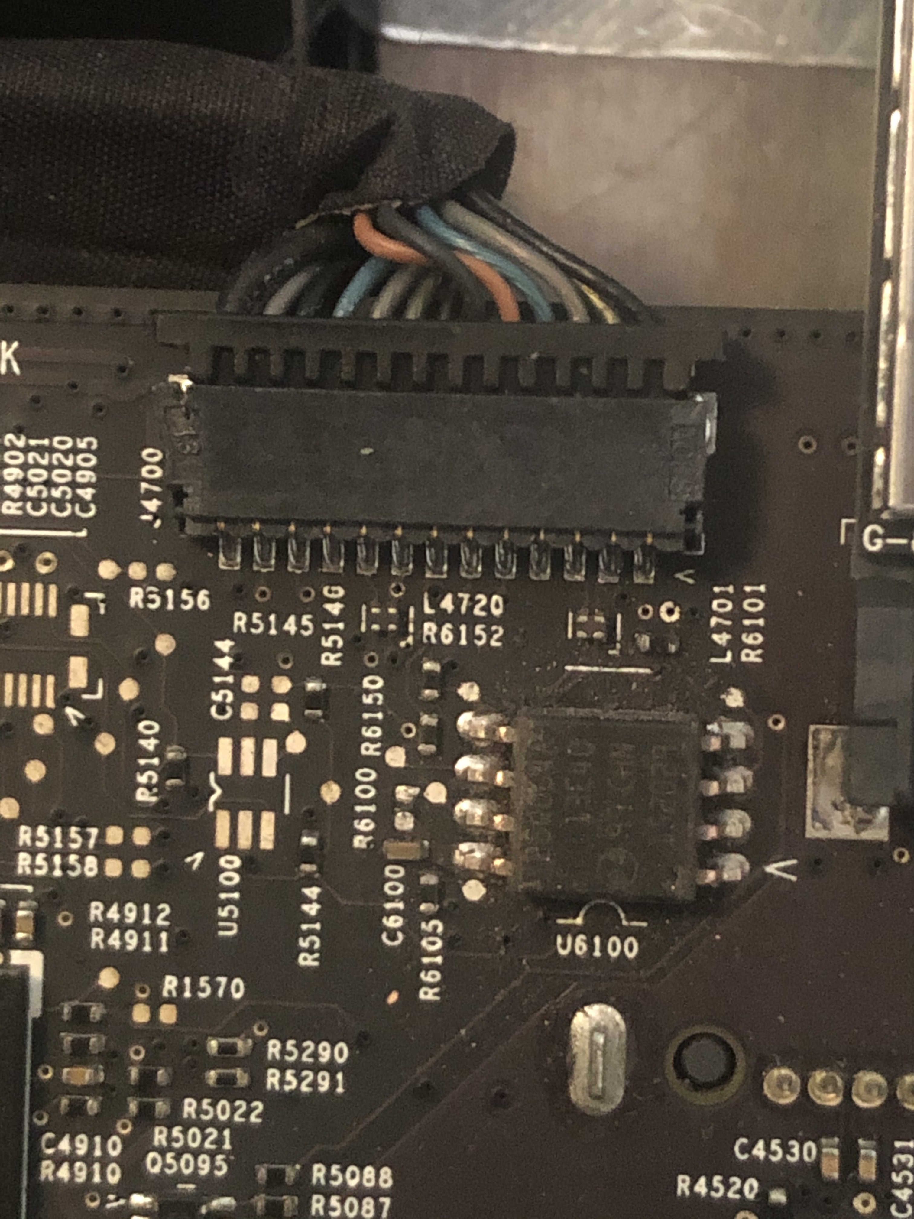

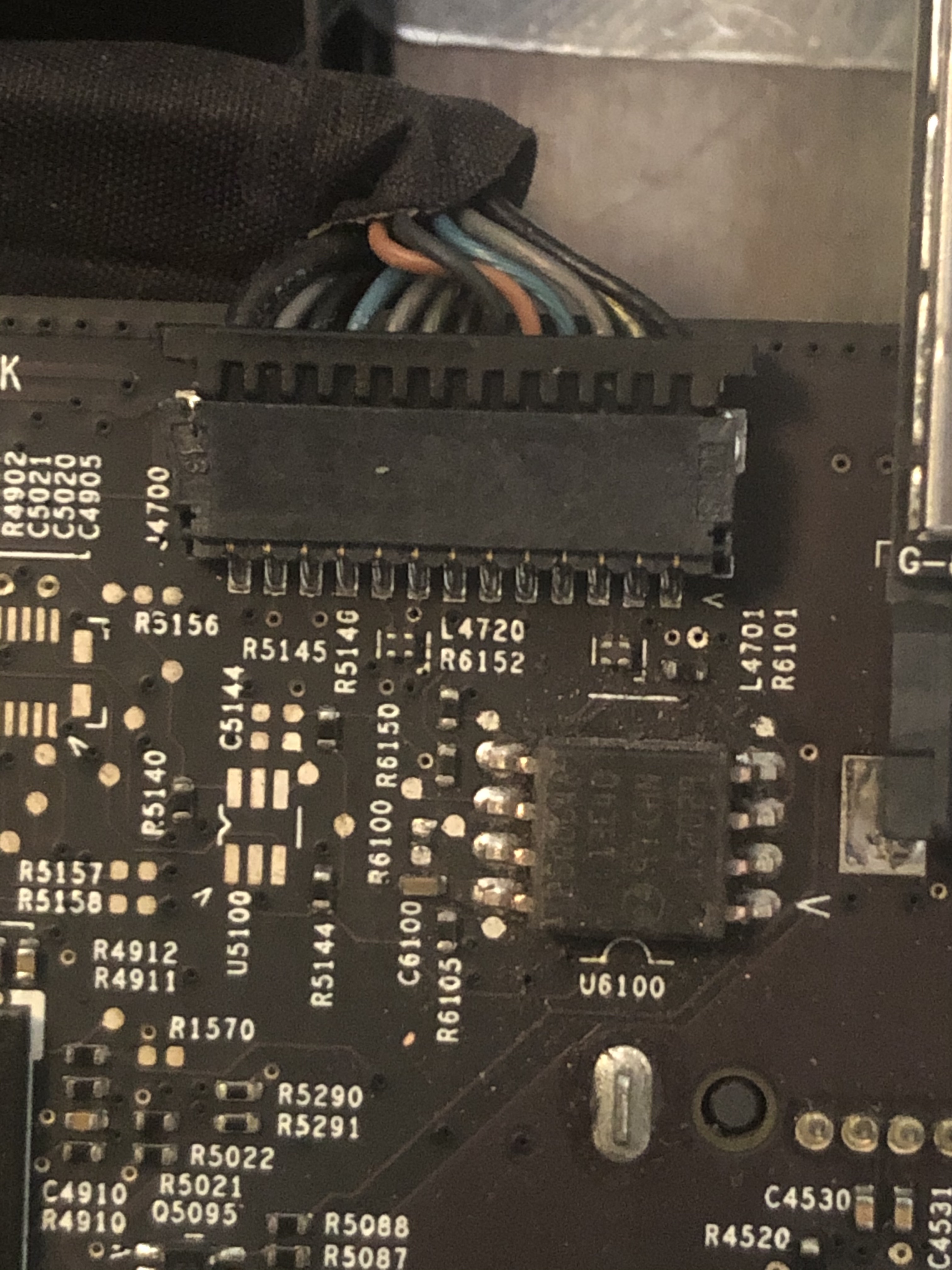

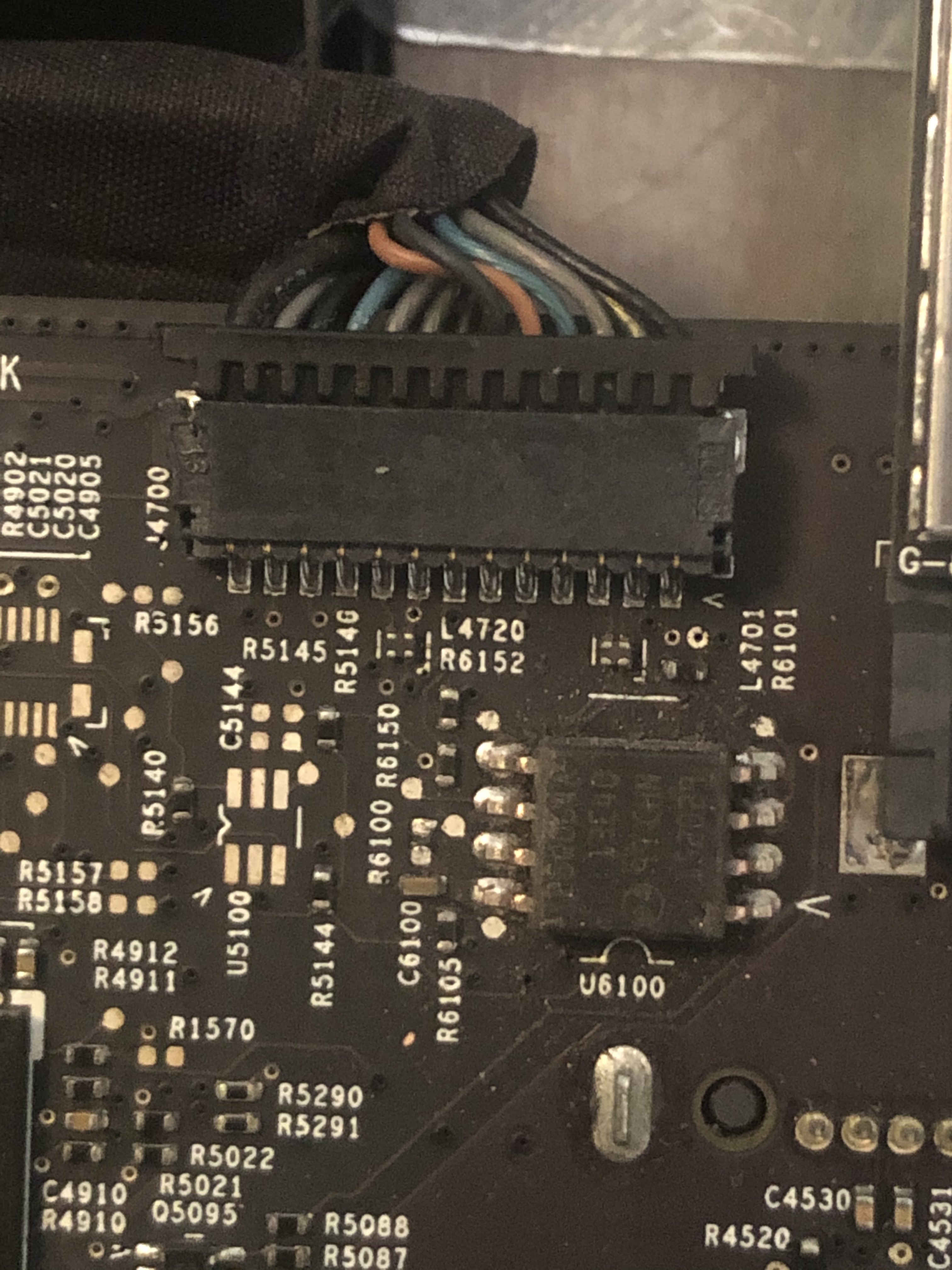

Just went to turn my iMac on and it's not POSTing anymore - fans spin up for a second then stops, does this over and over.
I wonder if there's any chance I corrupted the bootrom when I was trying to read it? Otherwise I might need a new board.
Doesn't appear to be any physical damage from where I was trying to clip it:
I hope you also made a few backups of your bootrom using the romtool from dosdude1 ?
If so, write this original backup back to the iMac, and try if it will work then again..
if so, compare the dumps always, using commands like shasam and check and compare files sizes.
They must all be the same.

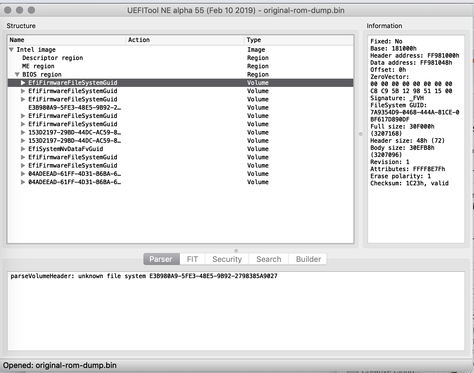

You made multiple backups with rom tool, they all look the same when you open them with uefi tool.. ?
Have you checked file sizes of them, and comparted them.. ?
Have been able to make any backups at all using the ch341A eeprom clipper.. ?

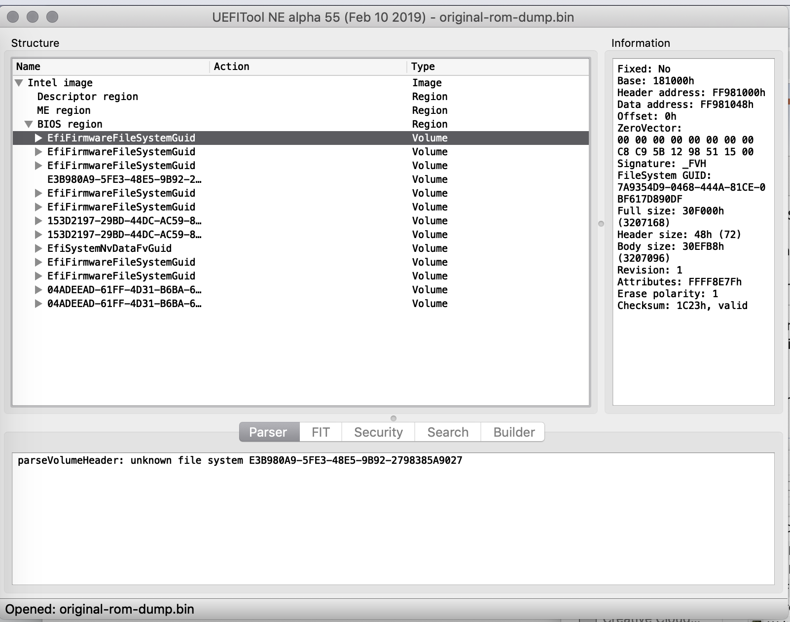

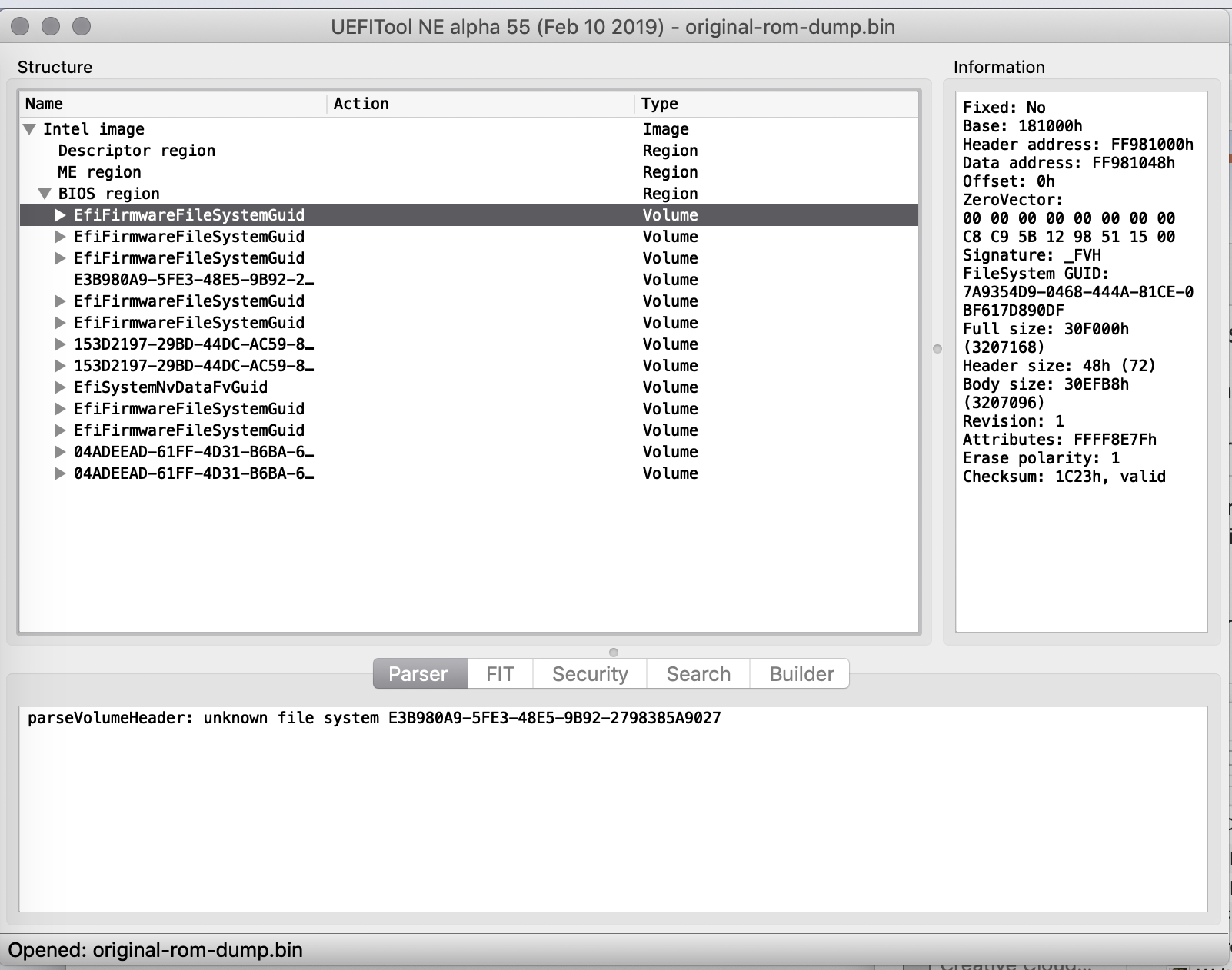

To me it also looks different, on the screenshot you have send.
Maybe Nick can help you with this, when he is back..
Btw you also have 27” iMac here correct.. ?
Only got the one romtool backup unfortunately. But I'll try and make a backup of the eeprom once the new clip arrives.
@Nick [D]vB any idea why my rom dump (https://forums.macrumors.com/threads/2011-imac-graphics-card-upgrade.1596614/post-27783702) looks so different?

So your iMac doesnt do anything at all, at the moment.. ?
When you plug in power first led on logic board. Should light up..
Last turned on yesterday when I did the 765m install/flash - hasn't worked since I tried clipping to the eeprom. I've done an SMC/PRAM to no avail.
Ok, strange.
So the firmware on the eeprom should still be stock and untouched i would say.
There are very little capacitors near the eeprom chip on the logic board, perhaps you have destroyed them while trying to put the eeprom clip on.. ?
Checking the logic board perhaps is a good idea.. ?
Reactions: Nick [D]vB

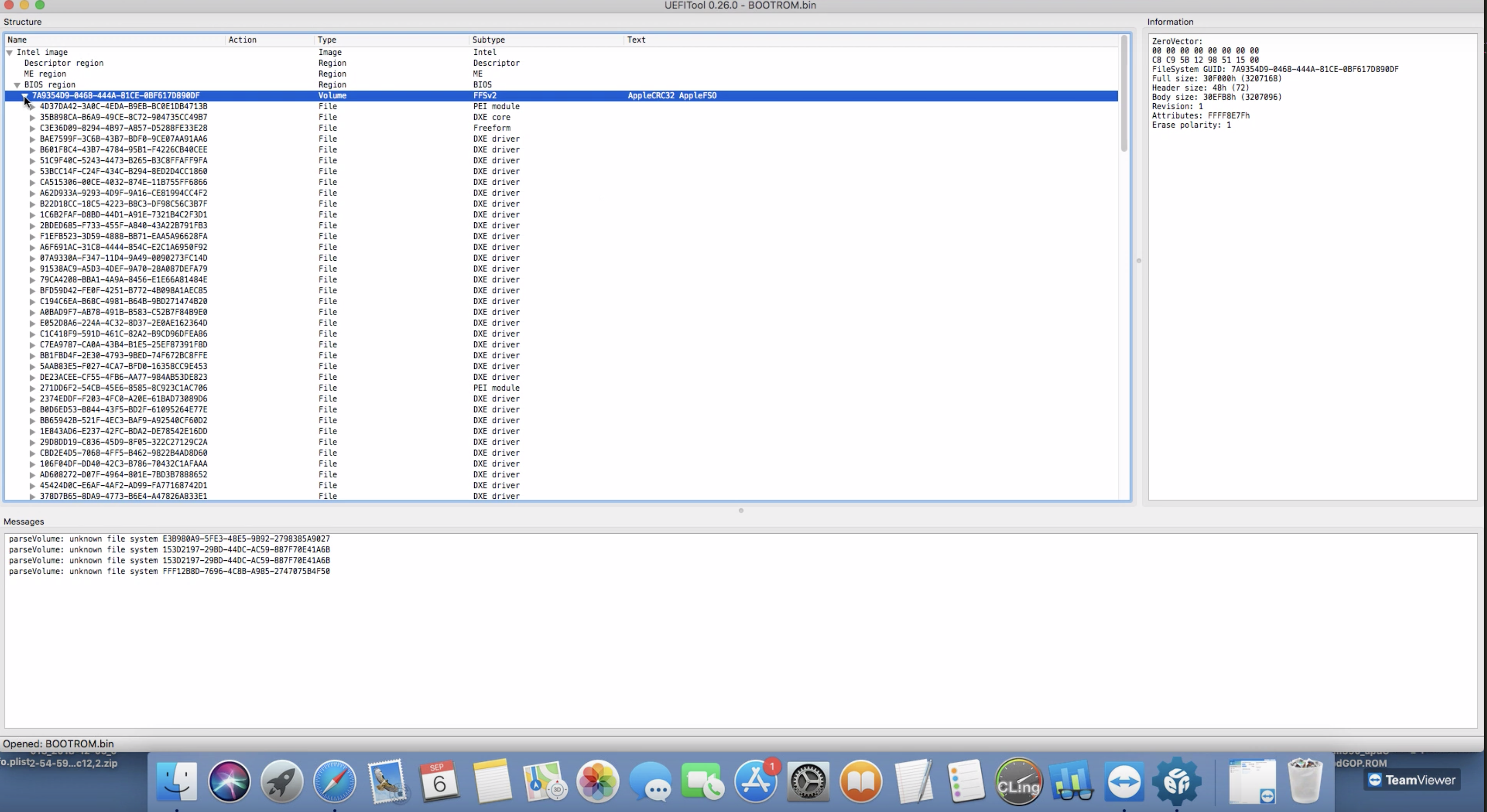

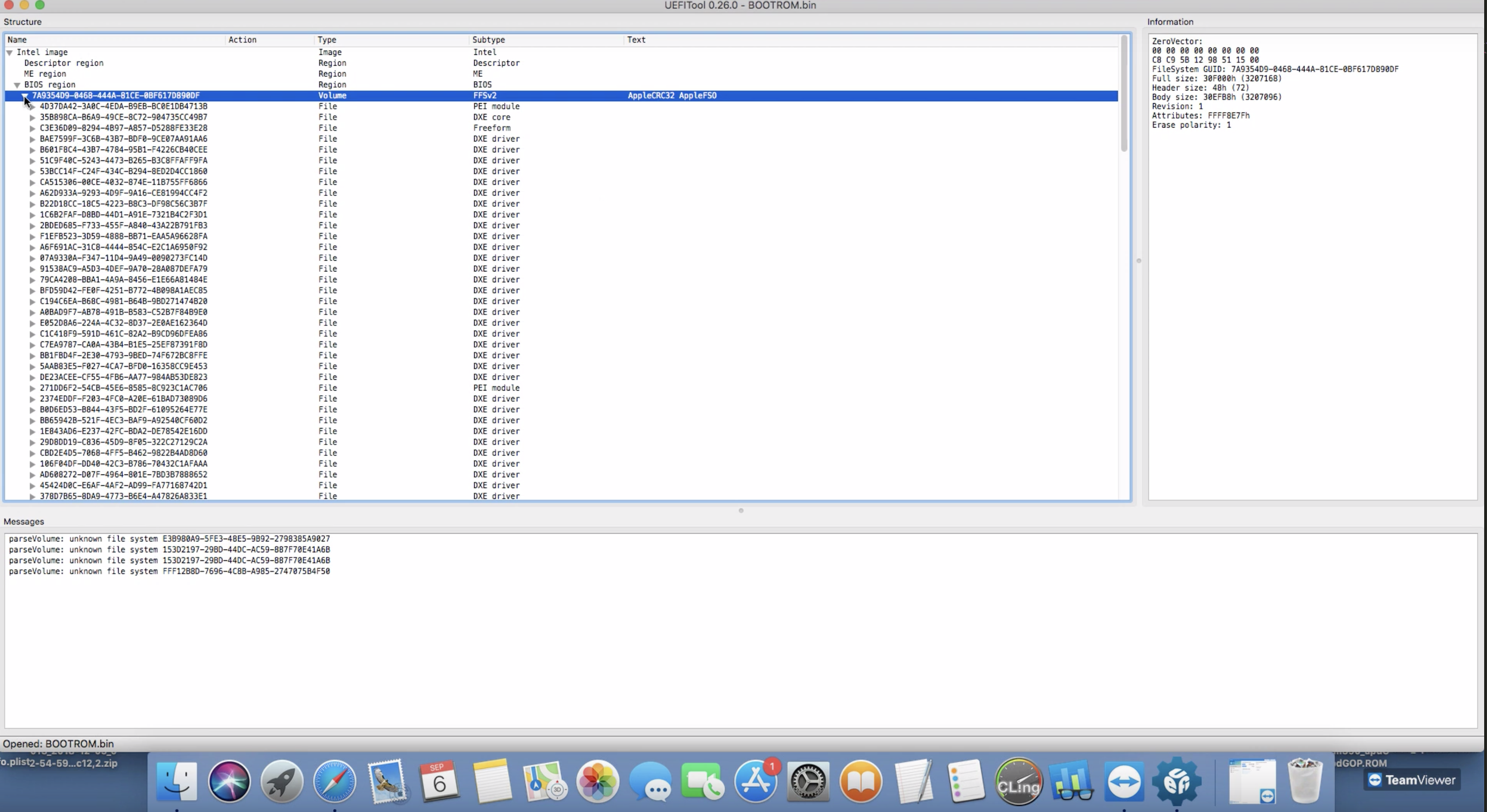

Why not use the Windows software? I just did and looks like it worked. I read the Bootrom with the Windows-Tool. Modified it with the UEFITool 0.26 and saved it again to the eprom.
Now I have a Boot screen, but just before the Apple appears I see some text scrolling by for a slip second. Is this normal?

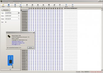

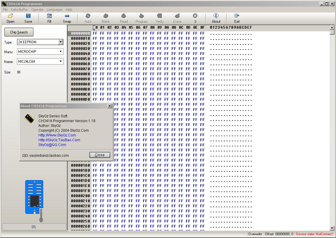

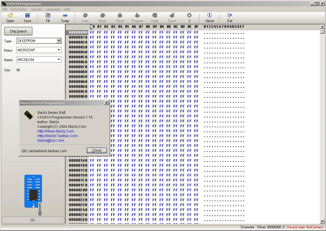

what program are you using? what settings, in what position is the jumper, in which slot is the clothespin inserted?
After i received my programmer i googeld a lot and found the so called CH341A Black Edition Programmer software. It looks like this:
