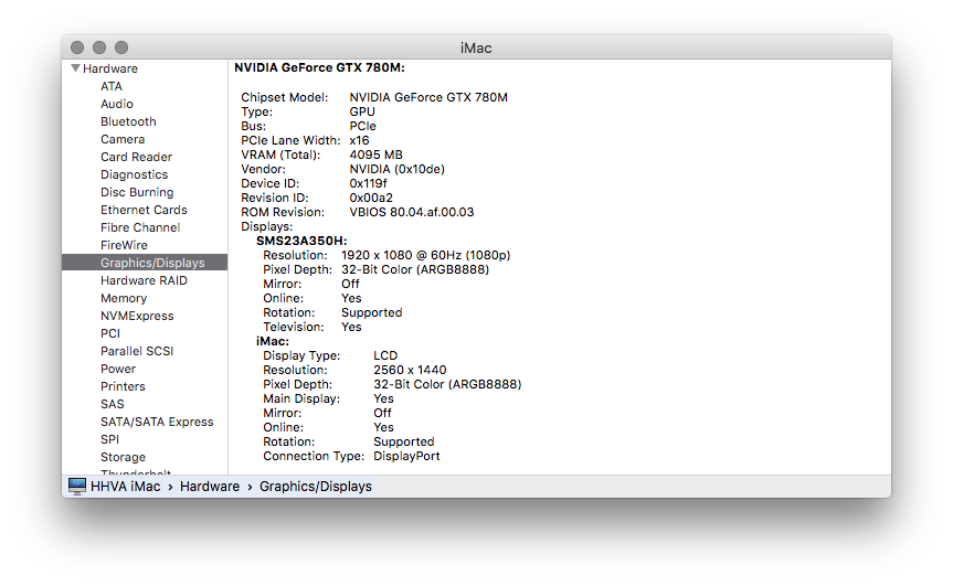

Same card, same bios. Something else is different.
Any card can work in iMAc A1312, any card on MXM-III standart, but if in Main EFI have a binary driver for it.
about any update from OSX, "OSX can rewrite some section in Main EFI bios. and GTX780M cant starting up"
after OSX update to new one.
i try on 10.9.5 with old version "Main EFI." me copy it from logic board with usb programmer. (any card working fine)
but if osx updated, gtx780m lose screen after restart.

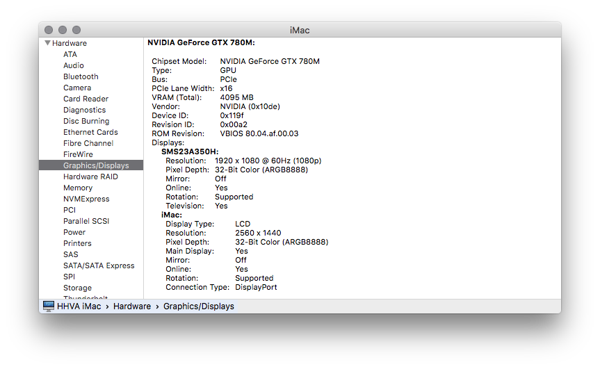

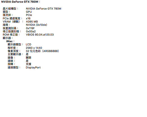

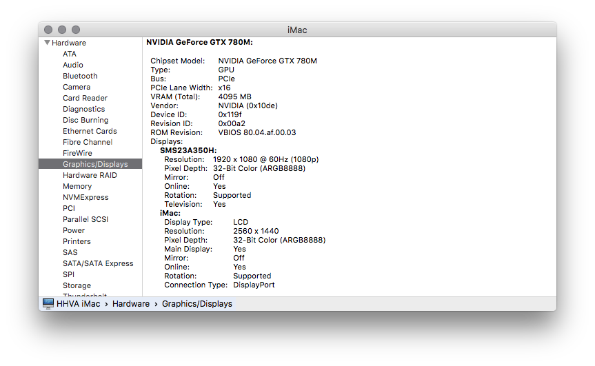

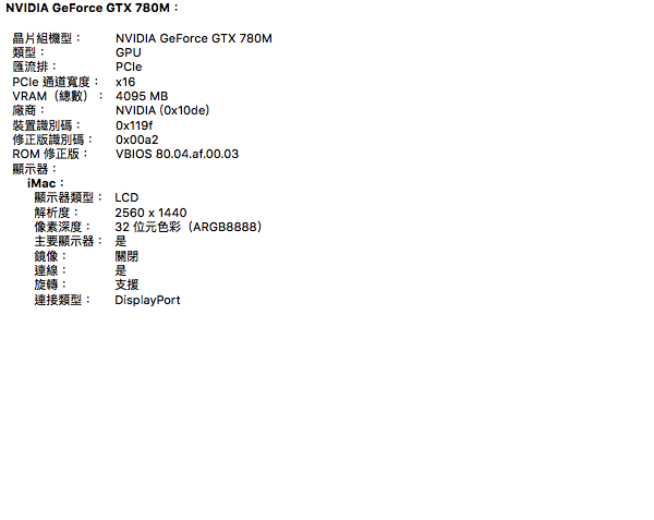

I got it from eBay a year ago sold by a guy from Slovakia named chooseyourdestiny but this guy have been hiatus for quite some time. If you are planning to get this 780m find the one with VBIOS 80.04.af.00.03 or from DELL

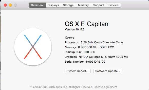

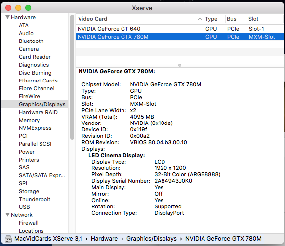

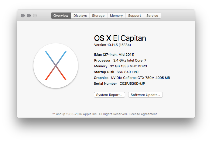

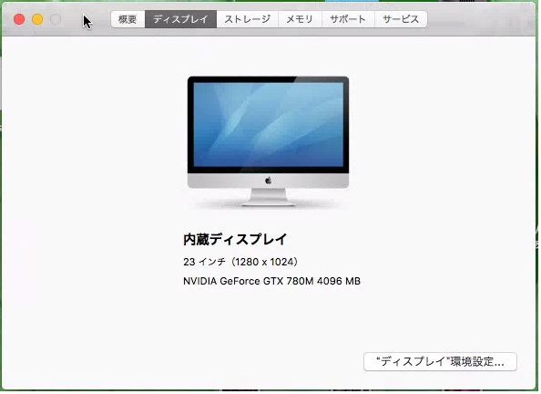

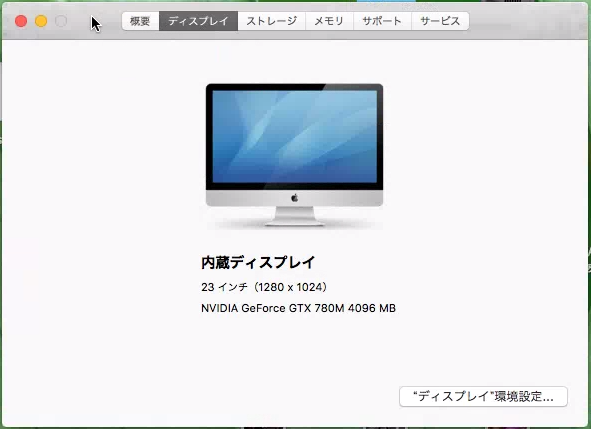

So I am slowly moving forward. Testing in an X-Serve as it uses same slot.
GTX780M had no display output on 10.11.5 default driver, once Web Driver installed it worked again. I think key on an iMac is going to be to set up screen sharing before running an OS update so you can install Web Driver in the dark. Should save having to disassemble iMac for every update.

Many cards work with just BIOS, no boot screens, well known in Mac Pro world. I am typing this on an MXM 980M in an X-Serve .
Same thing, no EFI but gets to desktop.
You can go on Tech-Powerup and get the iMac roms, they have EFI and BIOS, like any other AMD card

It's completely unrelated to EFI stuff. EFI isn't needed for initializing the drivers since OS X Lion. Apple keeps removing "unnecessary" GPUs from their drivers, end of story.
Some (formerly well-supported) GPUs have disappeared from the drivers with the release of El Capitan (e.g. GTX 560 Ti or some GT 740 models). Had a discussion about this with a few Hackintosh guys some months back, because we were trying to compile a list of supported GPUs. No easy task if Apple keeps changing drivers.
I guess the GTX 780M might be a similar case, but I can't explain why it's working for one guy but not for the other. Might be a good idea to dump & compare the VBIOS, maybe there's a difference despite same revision number.
You just showed a video proofing the opposite of your claims: Bootscreen is lost after replacing the video cards. Where is the EFI display driver now?
As MVC said, the VBIOS of 2011 and earlier iMacs certainly contains an EFI Display Driver. Wouldn't make much sense if Apple stored a redundant copy in the main EFI, would it?
Could be easily verified by firing up an EFI shell (e.g. with Clover, which will create EFI output even from stock PC cards) and investigating the loaded EFI drivers.

Uhm? It's actually a quite well-researched topic, both from the MacPro side (visit netkas.org) and the Hackintosh side (tonymacx86, InsanelyMac). The only issue is that very few people actually care about doing the same to an iMac because MXM parts are way more difficult to come by and are not easily exchangeable.
It shouldn't be too difficult to add the Mac EFI to the VBIOS of a MXM AMD card. I'd be surprised if it takes more than adjusting a device ID, concatenating it & running fixrom on the full thing.

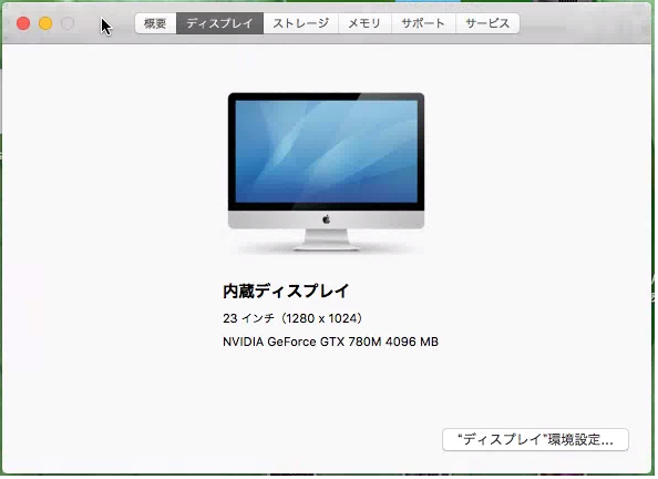

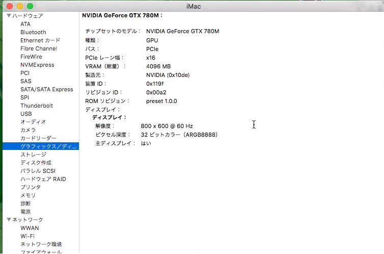

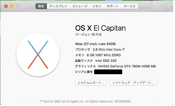

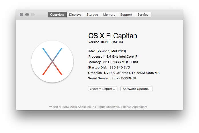

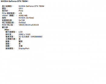

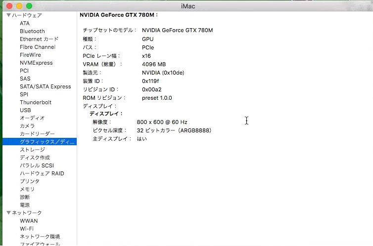

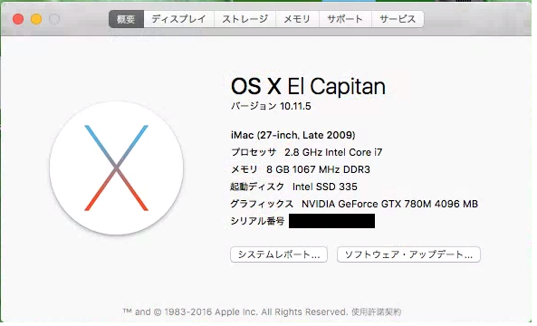

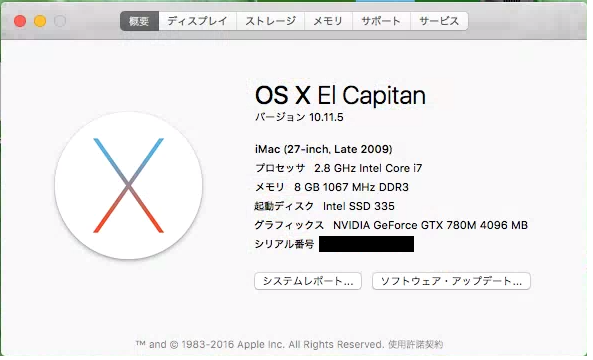

I got same card with same VBios, but no success with my iMac Late 2009.
(card was MSI, taken from Alienware)
It works with Bootcamp but doesn't with MacOS(10.11.5)
This week i'll try to reinstall MacOS with old card then replace to 780m.
