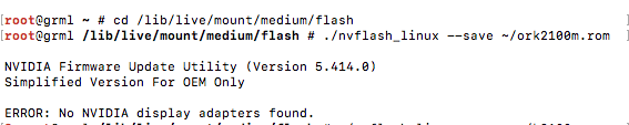

well this is too bad :(
does it mean the graphic card is dead?
well, it could mean also the card mxm slot is not perfectly fitted so the card is not detected...
bad cards usually are detected but not working

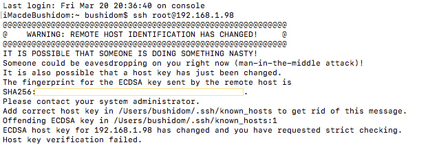

now I can't connect anymore to the iMac
How can I resolve this and try to flash the card
thx

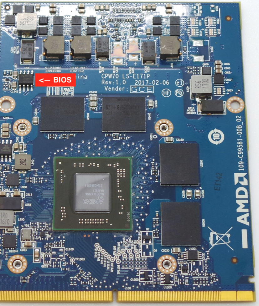

The 780m as a EPROM 25xx or 24xx?

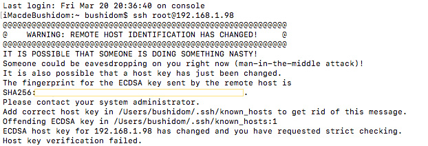

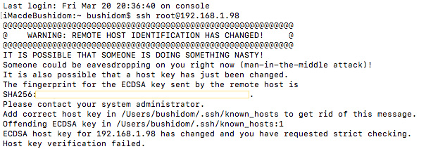

Delete your file named /Users/bushidom/.ssh/known_hosts completely, or change your strict ssh settings, or edit it with a standard text editor (i.e. vi) and delete the line for IP 192.168.1.98....
Thx
I found the solution about ssh
ssh-keygen -f ~/.ssh/known_hosts -R iMacIP
But same result, nvflash detect no nvidia card :(
Next, well I think the card is dead... no detection at all, 2 leds on, I put back my HD6970m everything works like a charm.

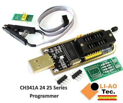

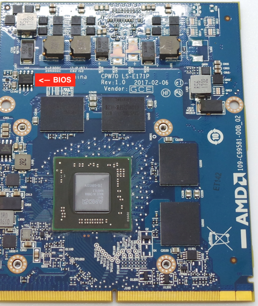

last resort would be an usb CH341A Programmer, maybe you can solve your issues with it.
i would have a try, is only around 10$. i've got mine for like 12 euro on ebay (spain seller)

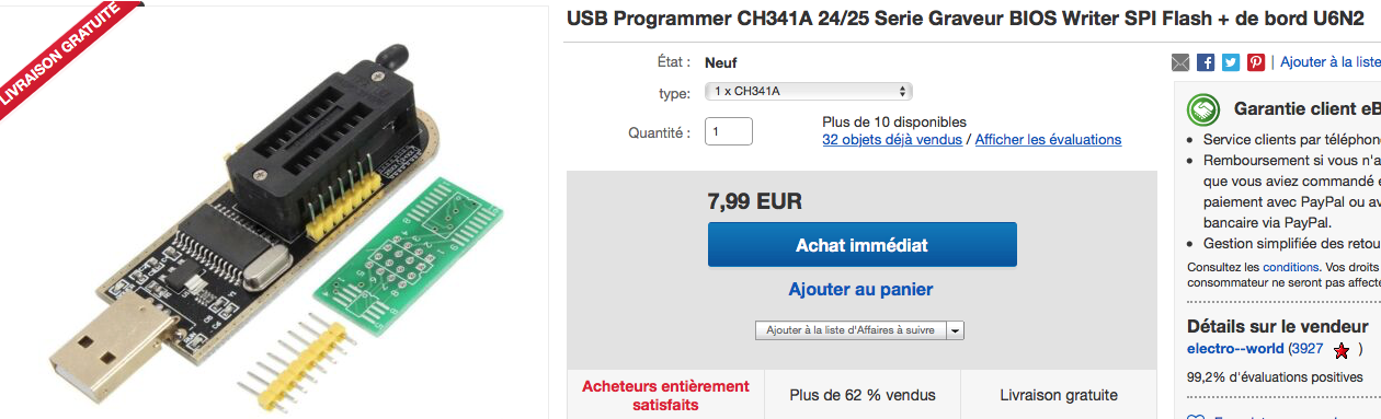

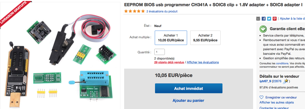

the first or second one? Thx

if the problem is ONLY the bios, you'll solve it with the chip programmer.
just be sure to get it from an eu seller and not from china, otherwise you'll wait for more than 2 months...
i've got mine from spain:
I never use that kind of item!
Then I would advice to start at the very first page of this thread and follow the links to the docs, and howto, and even videos when it comes to the clip programmer.
And a dead card will remain a dead card regardless which programmer you are going to use. I have a flashed 780m, three green lights without the internal LCD installed. Booting with chime, starting up and when the (external) display is activated the complete machine powers off within a split second. You cannot solve hardware issues by software programming. I was able to flash it using the linux flash stick method, but it remains broken and even worse: Now I cannot even startup the linux flash image again, the power down prevents it with or without a display connected. Before I probably have to delete the BIOS :)
Having and using a CH341A is a real powerful skill. It is worth buying it!
