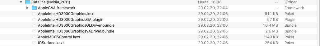

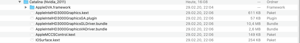

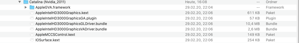

There is probably only two additional hints only for 2011 users with Catalina or Mojave using a Nvidia Quadro K1100M or K2100M:
1. Additionally install all AppleIntelHD3000* files on disk in /S*/L*/E* - only this enables QuickSync.
Follow @highvoltage12v original instructions how to achieve this. You will have to install IOSurface, AppleMCCSControl and the AppleGVA.framwork on disk as before.
2. You cannot have Lilu and Whatevergreen installed and selected in OC at the same time, boot will fail. Deselect from OC in this case. This is valid for all users having a running Mojave/Catalina installation with sleep working and put the OpenCore on top, now.
Currently I try to get this infos added to the README, it is not helpful to spread out all the info on 1001 different posts, here. But because we will have in future only new installations (10.15.4 is out) there is not need to maintain every possible old status.
